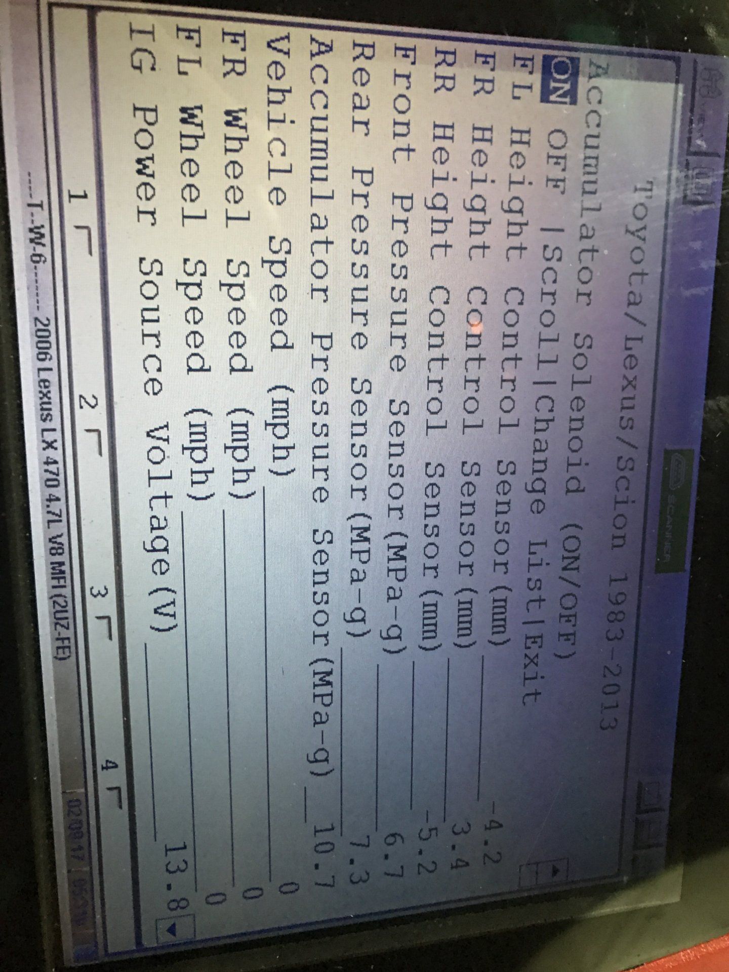

I took it to a friend with an scanner seeing if any of this info will help. I took a few snapshots and then the info screen of maybe I looked at the wrong page. I really appreciate all the help. Going to raise the torrsion bars here in a few minutes. Kevin
Kevin you're on the right track but there's nothing usable there from the Snap On. You've got to have that screen up, lower to L then raise to N and read off the pressure fields when they've populated. You'll only read 0s if you just hook up and don't do the L to N raise. Did you clear the C1762? If not you can clear it without the scanner: IG off and short [using a paper clip, wire loop or similar] Tc and E1 in the DLC1 connector under the hood, IG on [you'll have Christmas tree dash lights flashing] pump brake pedal 9 times in less then 3 seconds, IG off and remove the short. Done.
Okay cleared the code and raised torrsion bars 5 full turns went from low to neutral with scanner hooked up

Your front pressure is now good, rear at 7.3 is quite high if you're at stock weight and front/rear heights.
