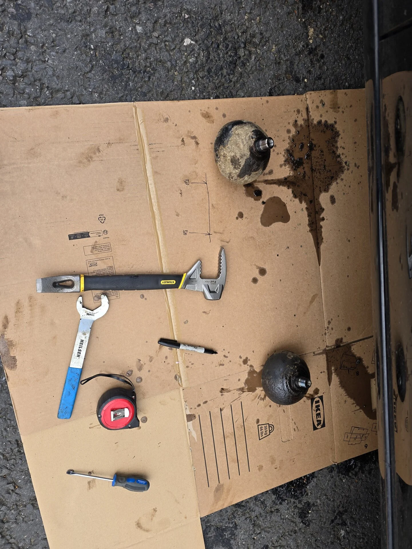

4) Decided to "pencil test" the globes hoping I had a glaring failure.... nope. All had 5cm of pencil depth in them..... apparently that doesnt mean anything either!

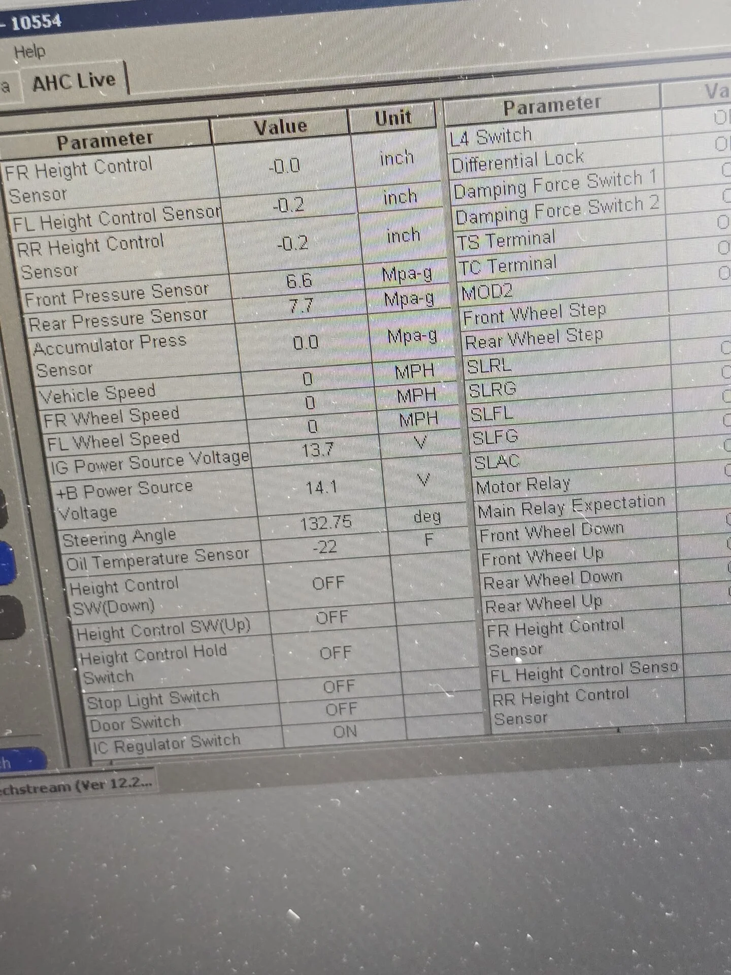

5) Front is 6.6 and rear is 7.7............
Do I chuck new rear springs in? Or go for new globes? I believe both may be original to the car.....

I’d start with 30mm coil spacers in the rear.
Thanks @GTV
I had considered that but based on what I can find, a spacer is about £100-120 delivered (probably from US or Auz). Whereas new springs are £240
Thing is the labour is the same with Spacer or Spring install unless im mistaken? Jack her up, remove drop links, struggle with AHC shock removal then spring compressor and pull out.
If i doing that then I may as well go for new springs......
Remove the lower bolt from each shock ( leave the top in place) and disconnect the end links. Disconnect the height sensor to avoid damaging it. You don’t need a spring compressor. It’s a simple procedure.
