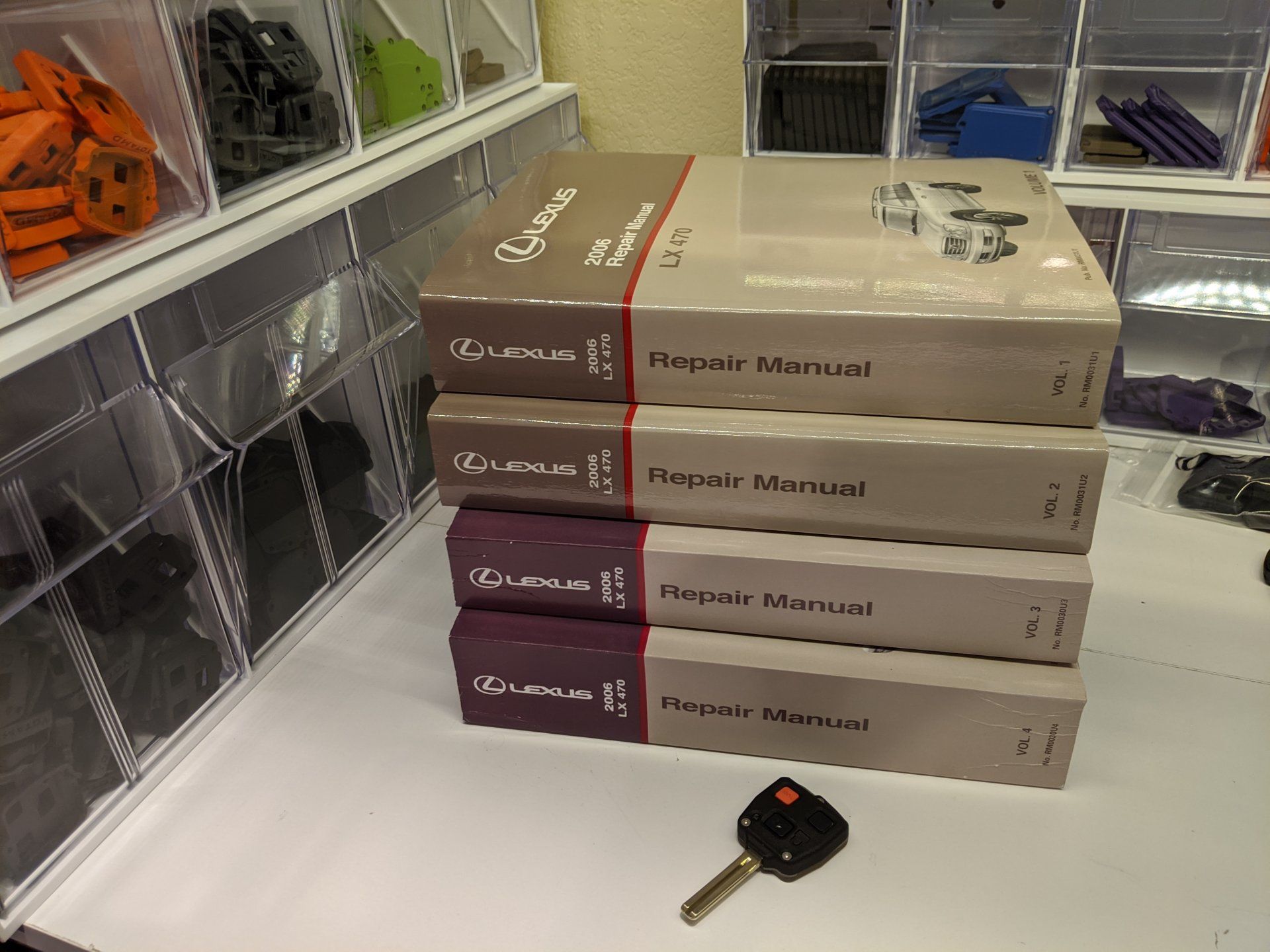

For the fsm, yes, there's a version specifically made for each model for each year. Any model/year combo that had AHC will have that in the manual.
The manual set is around 5,000 pages for the later year LX.
You and me both! But if you're not running a few grand a day through a shop, that $1500 Techstream isn't meant for you.
