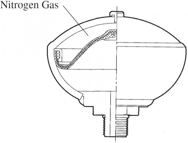

What part of this this costs so much to build? Even the Mercedes suspension globes are less than half the price of the Toyota ones.
attachment.php
Almost certainly scale. The Toyota globes are oddball fitting/size/pressure and they just don't mKe that many of them. They aren't that expensive by comparison though...yes more than plain old shocks but vs any of the aftermarket 'performance' systems they are in range. I mean basically AHC is a high performance remote reservoir system that is on-the-fly adjustable. If you want Kings they'll get you for $1000 per corner and those won't autolevel/height adjust!
