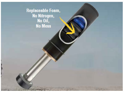

I have the stock ones bolted to an aluminum spacer but they not survive the punishment in the front .. ( still have the rear ones on ) so I was thinking in something like this ..
this is another option I've been looking for ..
they have front and rear options ..
http://timbren.com/ses-kit-lookup/?Reload=1415775792725
