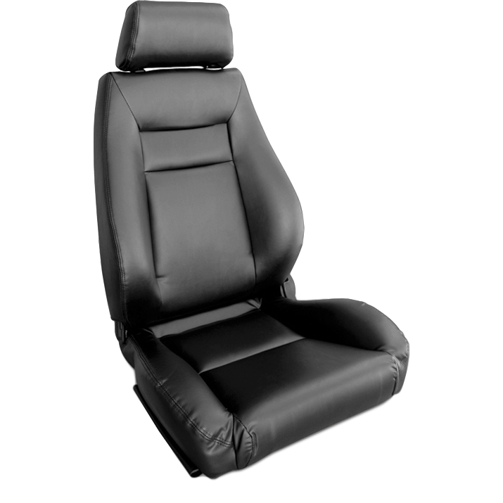

I've got a set of Procar Elite seats that fit over the rear heater in my '87 FJ60. It fits over the heater with no problem and uses the OEM sliders. I went with the gray canvas and I think they look great and the are way more comfy that the tired stock seats.
I went the same route. Black. I sent the original rear seat cover to Procar and the made a matching rear seat cover. It looks fantastic!
