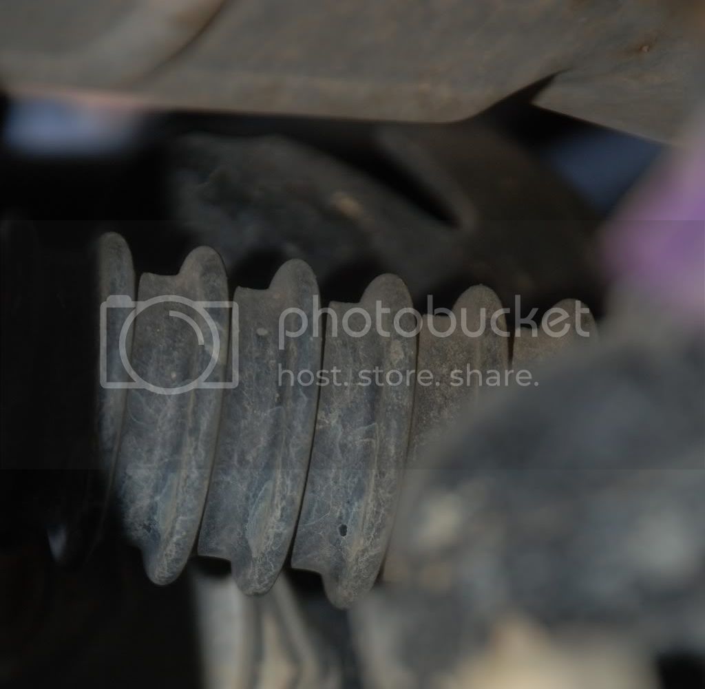

Driver side from bottom - exhaust manifold on right.

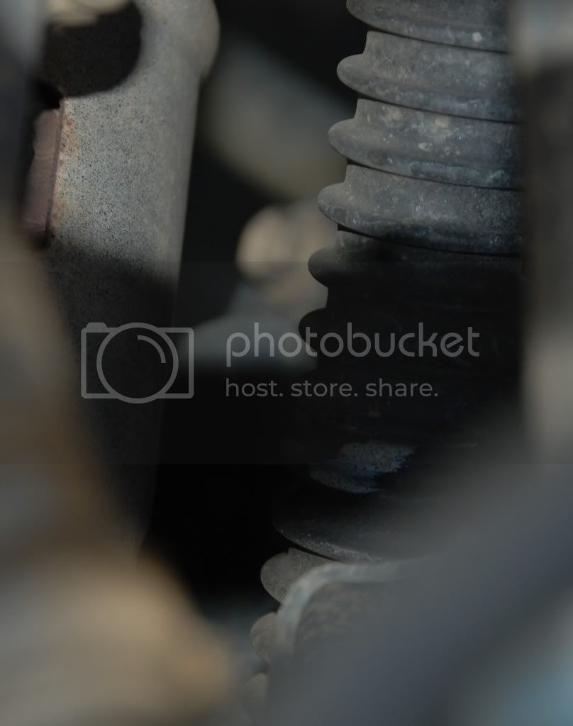

Driver side from bottom - exhaust manifold on top.

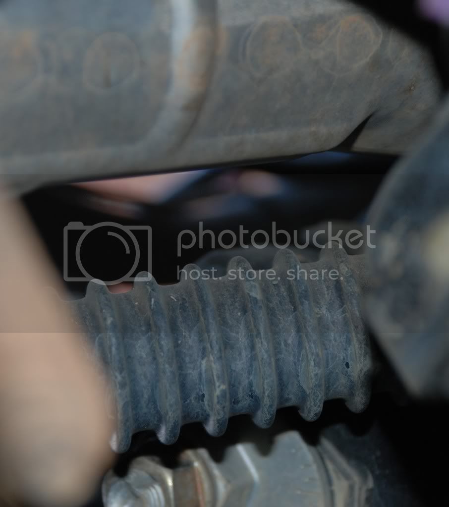

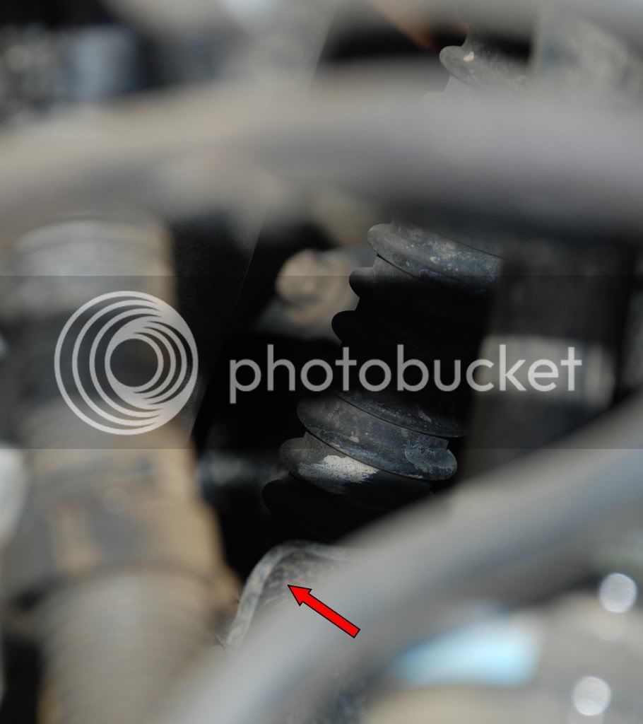

Driver side from top - exhaust manifold on left. Red arrow is the rearmost UCA mount.

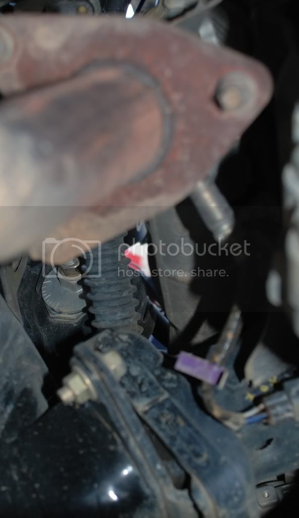

It's gonna be a very tight fit. My guess by just looking is that we have about 3/4" from the exhaust manifold heat shield to the steering.
