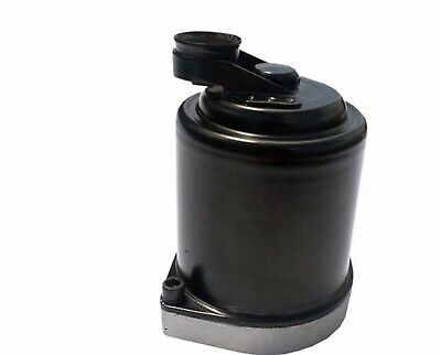

I rebuilt the booster motor this weekend with a kit from the UK off of eBay, as part of rebuilding the booster assembly. At 315k miles (I’ve had it the last 90k), I wanted to have the peace of mind on solo trips through the mountains. The original motor (as far as I know) was in fantastic shape, and likely had another 100k+ miles in her. No corrosion on the screws, the brushes were barely worn, the bearings were smooth, but looking a bit rough. I didn’t bother replacing the brushes.

@Bisho - Good job on the rebuild! Mine looked like this at 310K - the commutator plate ripped off the motor, due to worn out brushes.

Who was the vendor out of the UK?

Any tips on installing the bottom spring washer?
