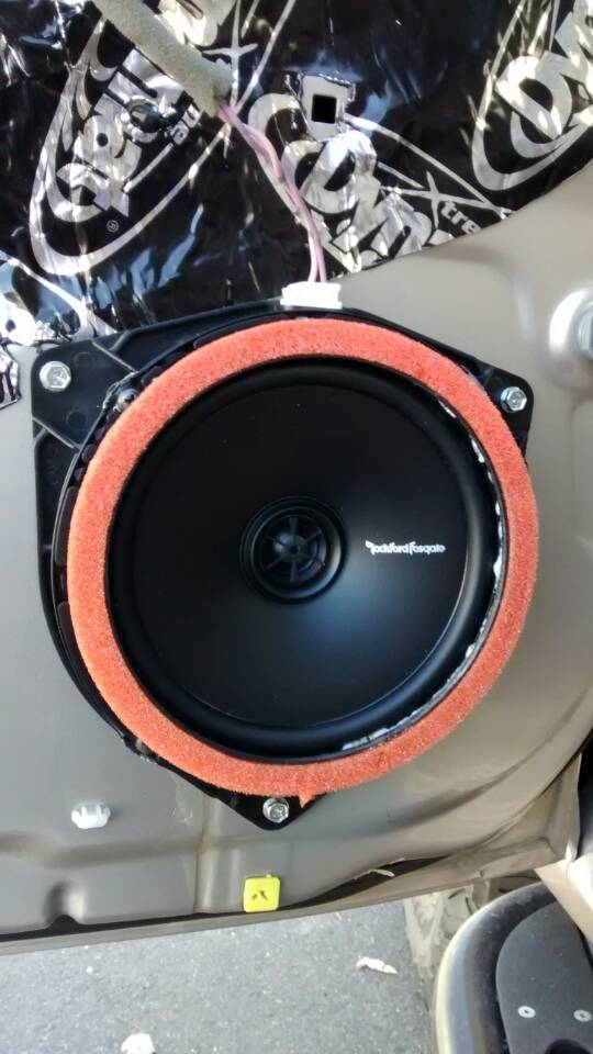

The Rockford Fosgate R1675X2 turned out a perfect fit for my '05 LC:

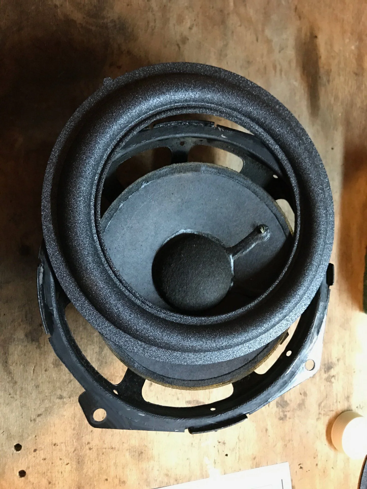

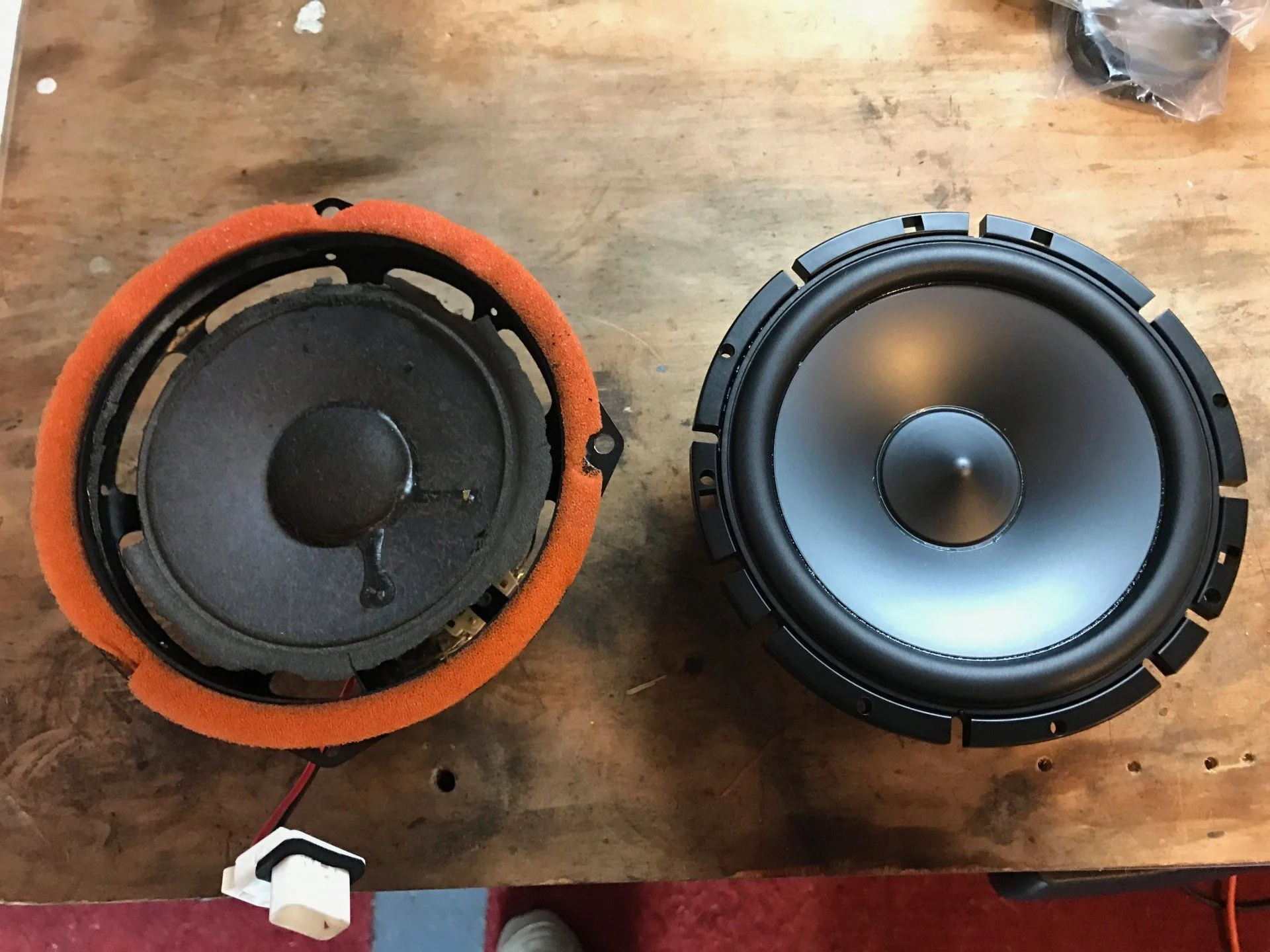

I was able to replace the surround on my OEM speaker did both fronts for $25.
Sounded better than the Alpine speakers I had in there temporarily...
Speaker was ruined
Vs Alpine

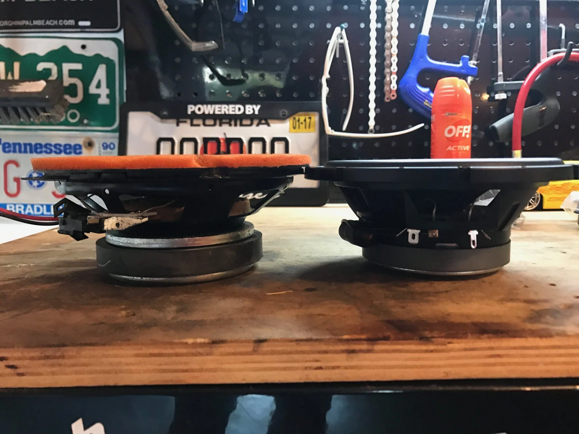

Magnet Comparison
Perfect Fit
Came out awesome
Reinstalled foam
