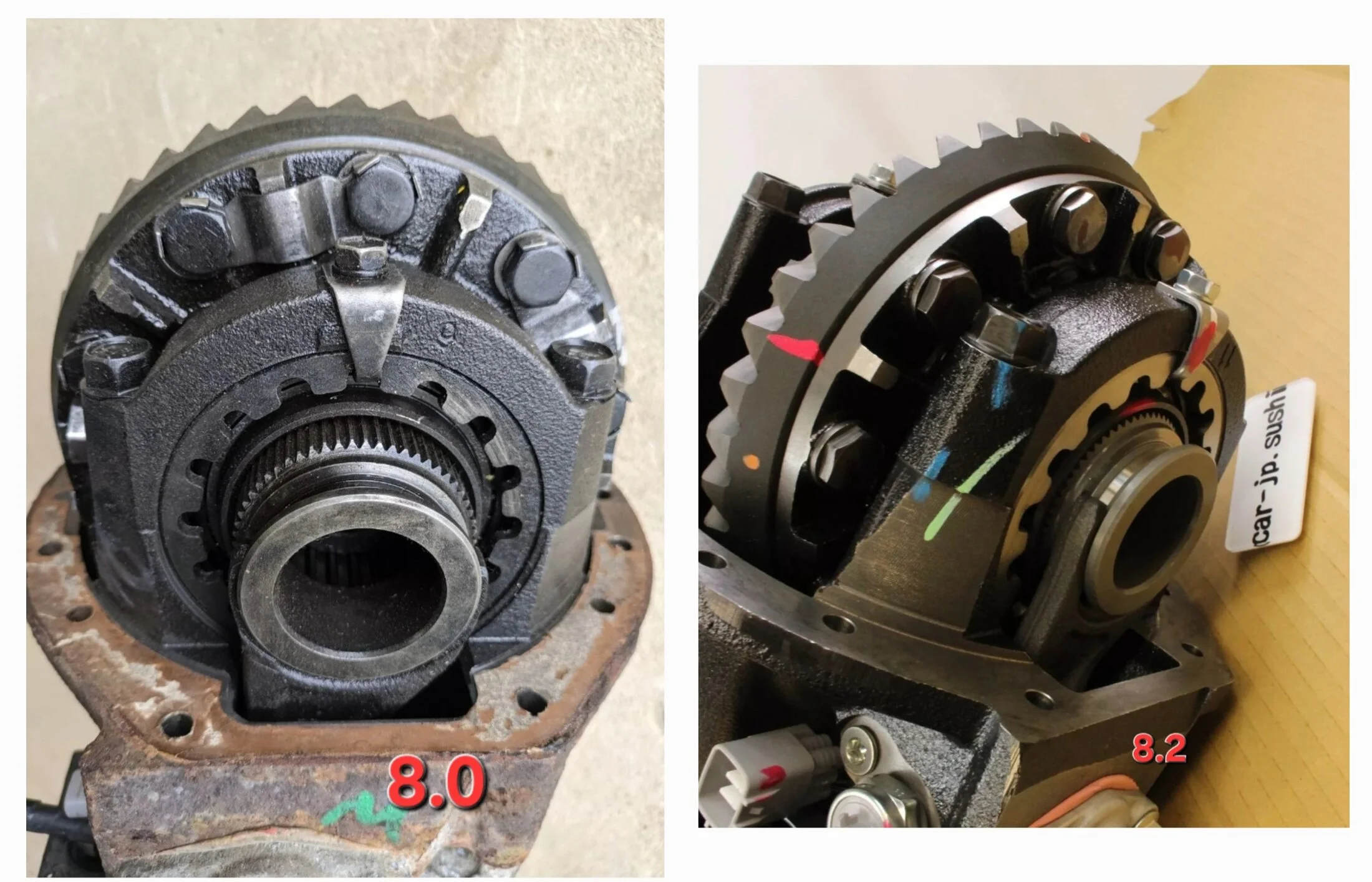

Looking closer between 8.0 elocker and 8.2 elocker shows minimal difference.
1. 12 bolt ring gear on 8.2 VS 10 bolt ring gear on 8.0 ring gear.
2. M10 stud on 8.2 vs M8 stud on 8.0 housing
3. 29 spline post 2002 vs 27 spline pinion on pre 2002 8.0
The upgrade to 8.2 elocker does not seem to gain substantial strength over 8.0 elocker.
If you plan to upgrade, non locking 8.2 would give much more substantial strength. BN21 elocker from 4th gen Tacoma or LC 250 might be a cheaper option then harrop. Haven't looked into compatibility yet.

Not saying 8.2 elocker upgrade is not worth it. What I am saying is elocker 8.0 are not that much weaker and stil a worthy upgrade for a lot less money.

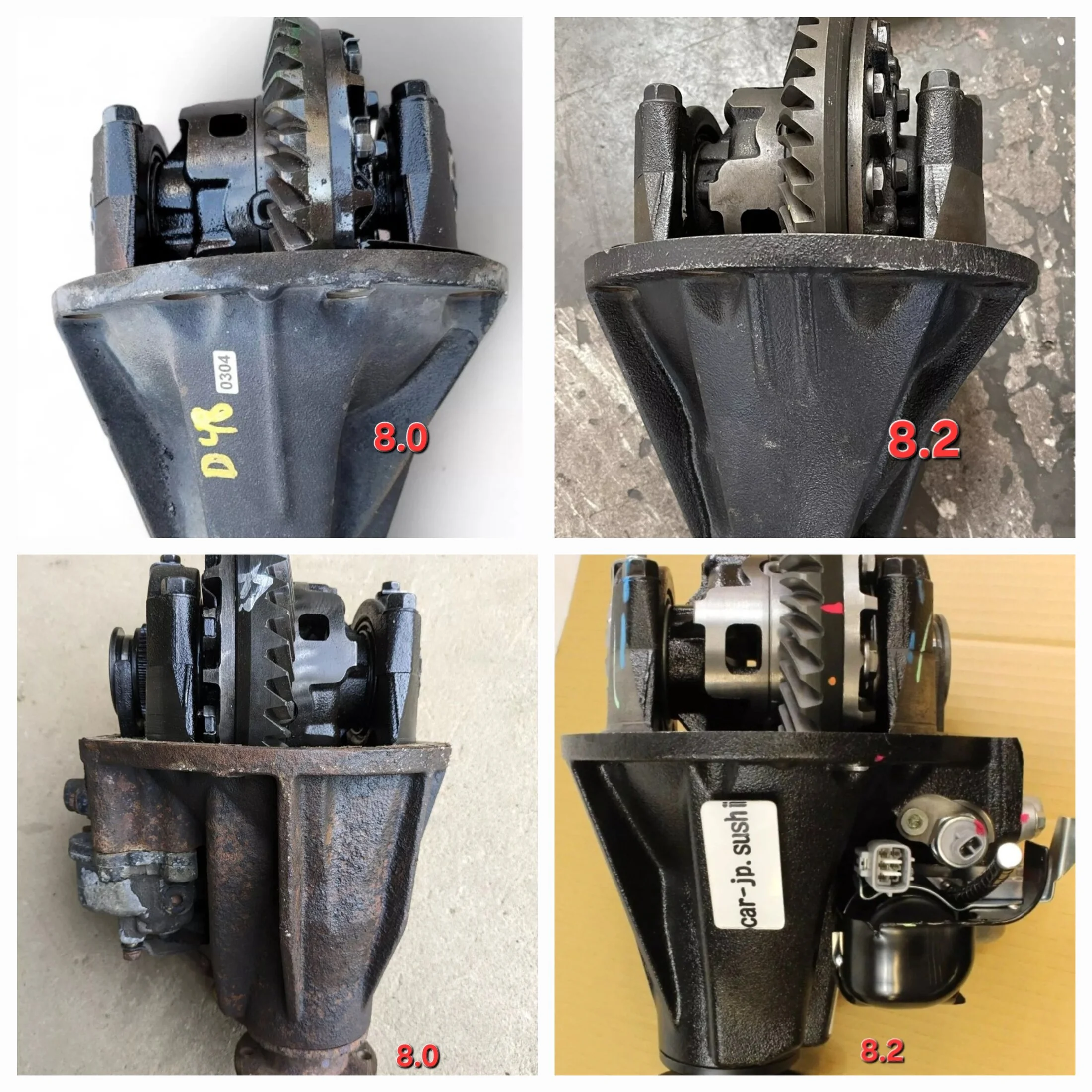

The 8.0 open are definitely weak for 5000+ lbs truck, especially after losing bearing preload.
The tower that suport the carrier bearing is the biggest difference. You can see they are much thicker on the 8.2 diff

You missed the point. It's not dishing 8.2 elocker. You already have it. Enjoy it.
What I am saying 8.0 elocker is stronger than 8.0 open due to carrier design to allow the locking mechanism also helps stiffen the carrier.
Open 8.0 are known to be weak due to weak tower that felex under torque. Especially after losing preload. No question about it.
What I am saying is elocker 8.0 is only slightly less strong than elocker 8.2 due to very similar designs. Main differences is pinion spline 27/29 spline vs 30 spline on 8.2. 10 ring gear bolt vs 12 bolt on 8.2
8.2 elocker still recommended as second cheapest upgrade option.
8.2 open carrier looks more robust compared to elocker 8.2 carrier to be able to handle higher shock load. Cons is higher cost due to having to buy aftermarket gear.
