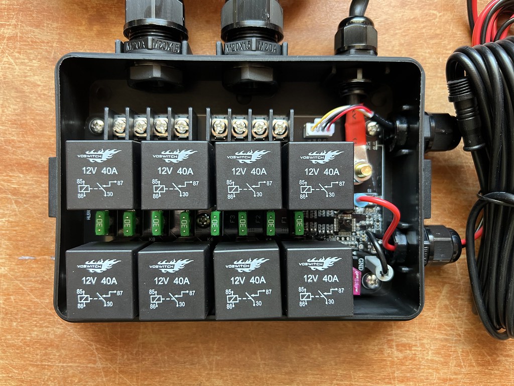

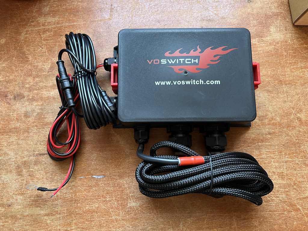

So long story short I ended up with a Voswitch power module and switch panel setup
So the final piece of my puzzle is the winch extension cables from the Blue Sea shutoff switch to the battery

Not sure what those are, but this is what it looks like (switch panel for inside the cabin not shown)

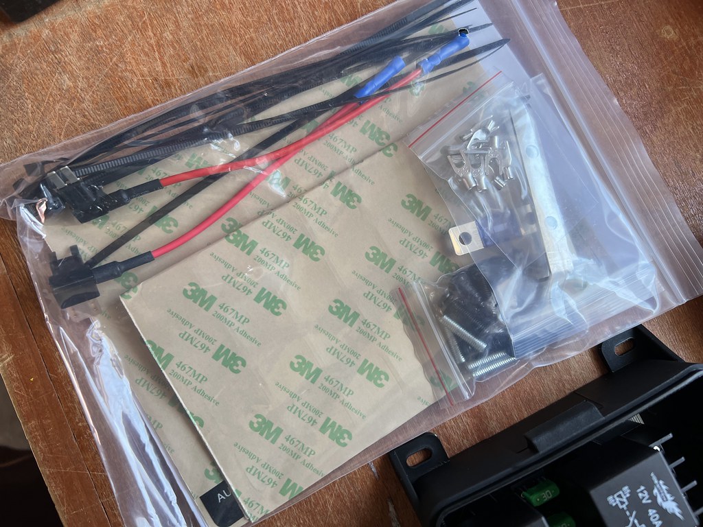

& some spare parts that come with it
For your pad panel with the icons of which button does what, there should be, and it looks like there is in your bottom picture of the baggies with the 3M sheets in it, extra/replacement icons for the button pad, so if you have a compressor, you can swap out the roof LED lights for that icon, or if you have ditch lights instead of a bumper LED, etc.
Usually there's a sheet of these for the button pad. Something like these from Amazon:
Ah, gotcha. Yes it came with a bunch of stickers for the switch panel itself.
