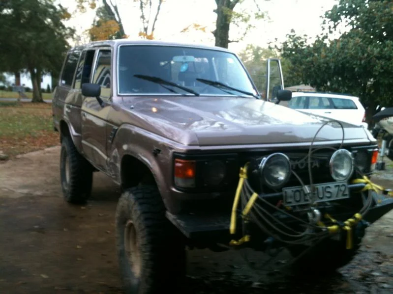

I guess a Warn will be in your future to replace that HF winch? What broke on it? Any idea?
i need to do some investigation but the solenoid box just clicks when you go forward or backward. i can barely pull/push the cable in so that's why i just wrapped it up. do you think that motor has brushes? that's the first issue i've had with that thing otherwise it's worked fine for a year....but that's about what HF stuff lasts right?
I read that it us common for the bolts to all come loose on the ends but that does not sound like your issue. Mine is similar (an Engo). I took it apart and sealed the case up and tightened all bolts at the time of installation.
Maybe the motor are itself. :confused:

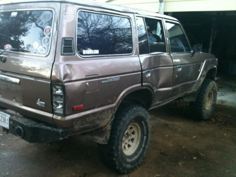

Here's what happens when you try a black trail without sliders. Doh
I don't believe sliders would have helped much :). Looks like you needed an Exo!!

My HF winch quit working after a year of use as well. I followed an online procedure to see if the motor would run when the solenoids were bypassed and it did not. Took it to a motor repair shop and the motor was seized due to water intrusion. The cleaned it up and replaced a bearing and its all good to go. I would say the Cove deep water crossings did me in. Don't throw it away. Get it fixed and get back on the trail.
Will do, thx Doug!
Go advice. What did the repairs cost ya?
Around $100. A little steep considering the cost of a HF winch, but it seems it was the correct thing to do, at least in principle.
Agreed. I recently had a very old Makita angle grinder repaired. I think it cost me about $5 less than buying a new one but to me that its a win.
