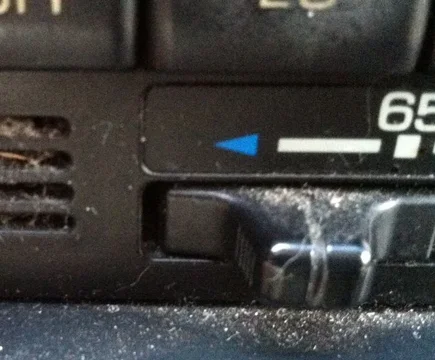

This photo is not focused very well, but it looks like I got the lever all the over to the stop. I decided to pull the cable after setting the temp up a little up off the minimum (see second photo). This way if the cable slips again I should be able to notice from inside the car when the slide moves all the way over to the left. Have not checked the temp yet. I plan to clean the evaporator and blower area this weekend.AC_cable6a.webp
