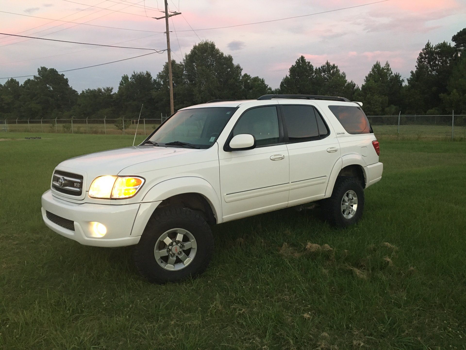

I'm back in one. Couldn't stay away. Just thought I'd revive this thread.......................
285/75-16 BFG AT KO2s, Toytec lift, SPC upper control arms, DDM Tuning LED bulbs in new DEPO housings and fog lights, Stubbs Welding sliders (not shown) High miles and runs GREAT!

@dnp How does the sequoia ride with the toytec kit compared to factory?
To me it's WAY better than stock! I used Bilsteins on my first Sequoia, and they worked pretty well (but I didn't have tires needing clearance, so I wasn't lifted as high). Then, I used Bilsteins to clear my 285's, so I had to lift it up....and they were A W F U L! Ditched those, went with Toytec front coilovers, SPC upper control arms, OME rear springs, and Toytec rear shocks. This setup is like night-and-day compared to the Bilsteins. Very smooth and controlled. Highly recommend.
