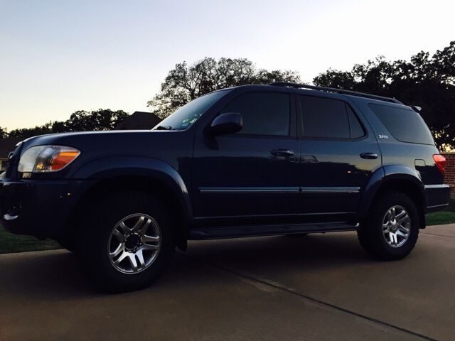

Here's mine with new shoes...265/70/17s BFG KO2s which I am loving.
Now I just need some new shocks so I am trying to decide the best way to go. If I could get 1-2" lift that would be great, but aftermarket off road parts for the Sequoia are sparse as previously mentioned.
Cancel my previous question. I found info on the height adjustable 5100's. Didn't know that was available.
Now I just need to find the right rear OME coils.

Got the 5100s installed on the front today. Was going to set them on the 3rd lift notch (approx 1.3 inches of lift), but the shop said they wouldn't recommend going higher than 0.6 inches (the second setting).
So that's what I did. Rides great!

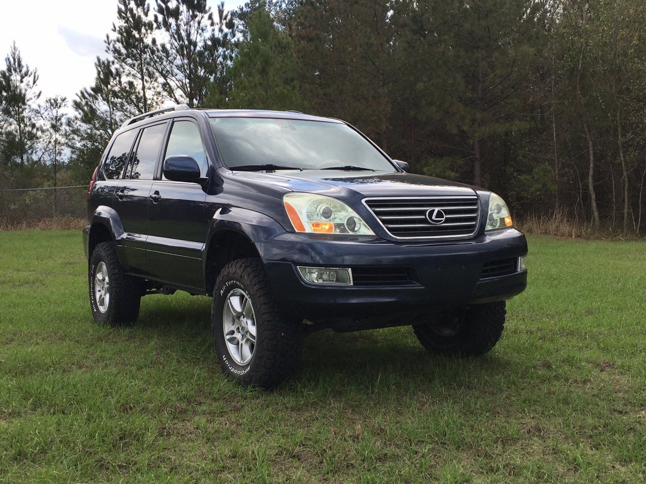

Interesting. I'm actually in the process of getting rid of my GX470. I'd like a 100 series, but am also considering a Sequoia for all the reasons you mentioned. My GX is stock and whatever replaces it will stay stock as well. Ever since I had my slightly modified 80 series, I've learned a stock GX/Sequoia/LC100 is way more than capable enough for my purposes (family camping/road trips).
I got my GX when I grew tired of trying to find a 100 series. They are cheap and plentiful. But I just never took to it. The suspension is too finicky (a non-issue if swapping to coils) and with each passing day I hate the rear door even more. I thought I would get used to it, but it actually bothers me more now. What a crazy design decision - especially given the great tailgates on the 4 Runner and LC100 and even the Prado.
I'm pretty much focused on 2005-07 Sequoias for the better engine. After test driving one, it has really grown on me. I feel like I settled when I bought the GX. With the Sequoia, I don't think it will be "settling." It is just a different target. As you said - great value.
I will miss the power of the 2005+ GX though. The thing is pretty much a hot rod in SUV form.

Yeah, I can identify with a lot of what you're saying. When we had a stock '03 GX, the suspension was always too soft for me - regardless of the shock control setting. However, when I bought this one and changed over to coils and Bilsteins all around....Holy Cow, what a difference! COMPLETELY different truck! I had much the same experience with the change in suspension on the Sequoia, even though I only changed the front shocks. Toytec has a pretty sweet suspension line (what I put on the GX), and I will probably use them again if I get another Sequoia.
There are LOTS of things I liked about the Sequoia, with the part-time 4wd and the bigger overall size being near the top. I don't mind the rear door on the GX - in fact, I have come to really like it (incidentally, Prados also have rear doors) - but I also really liked the Sequoia liftgate. Both trucks have gotten to be incredible values, so you can't go wrong with either. Both have their strong and weak points, but I do find the GX to be a little more refined. That being said, it's worth noting that I did have the very first year Sequoia (2001), and I'm confident they made big refinement strides in the later years....although, if you're looking for a later-model Sequoia, I would investigate the whole secondary air injection problem which started, I think, in 2005. I think there's a fairly reasonable work-around, but if you're planning to correct the problem as original, it can get quite spendy.
I'm a big 2UZ-FE fan, and I like every vehicle that's powered by it. In fact, if the swap weren't so expensive, I'd be inclined to put one in my 80.....but it'll just have to settle for a 6.0L GM for now.
