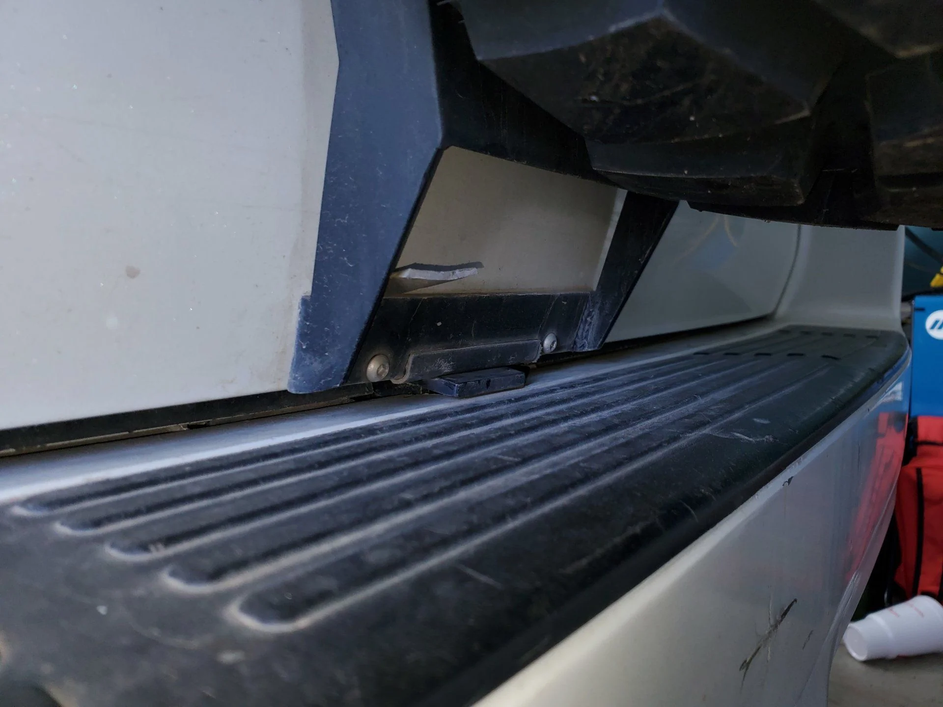

The Becky has a body mounted skid pad which carrys the load of the rear door. That was the key piece that they did to ensure the weight was not carried by the hinges when the door was closed.
The JW unit did not have that originally. It was added after some folks asked about it. Which is why it is bolted on. You can see from the picture, the ACC unit actually carrys the structure of the carrier all the way down to that point.
