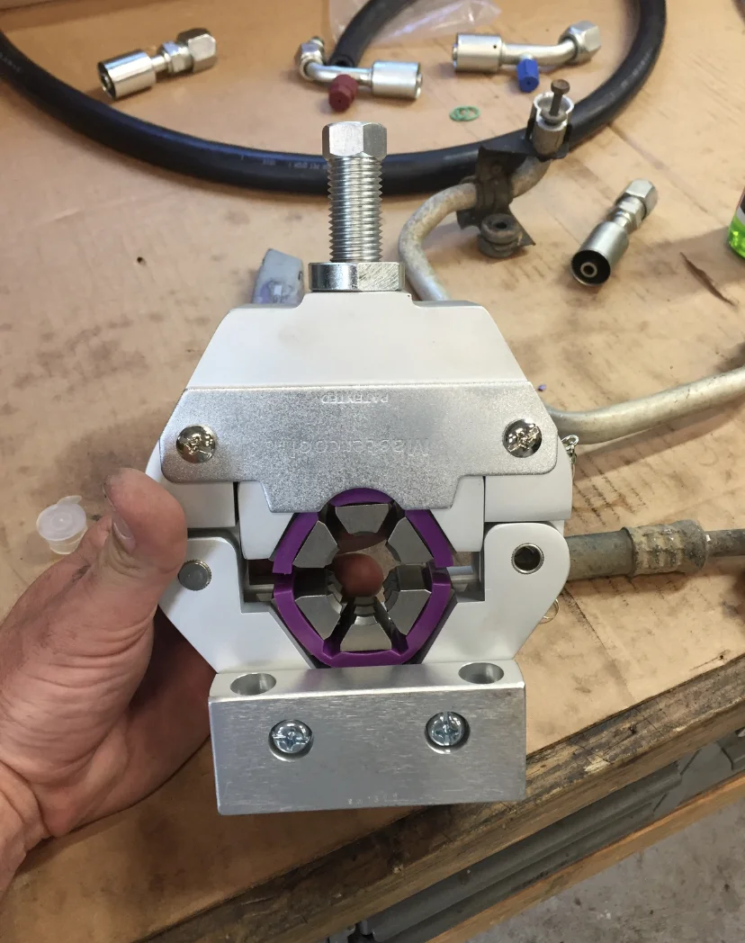

I ended up ordering what is probably a knock off of the Mastercool crimper. It comes with 7 different crimper fittings. I might use it for two jobs before it starts collecting dust, so it is hard spend a lot on this tool. I will give it a good look and if it doesn’t look up to the job I will send it back and spend money on a mastercool branded crimper.
I will post up what I learn.
Crimpers like that one combine what is supposed to be a dozen or so independent segments into two halves.
It doesn't crimp the fitting like it's supposed to be crimped, but if it works then it's worth it I suppose.

I have to give them credit for making a low cost version of a very expensive tool. The resulting crimp they show is on the crude side though. They try to hide the displaced material at the middle of the crimp by the way they hold the crimped hose in the video, but you can see it's bulged there.
It looks like they barely tightened it too. Mine are wayyyy more compressed than that.
