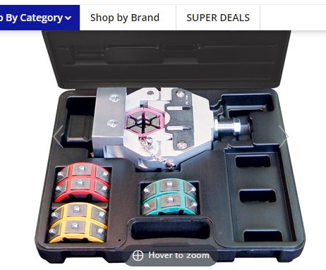

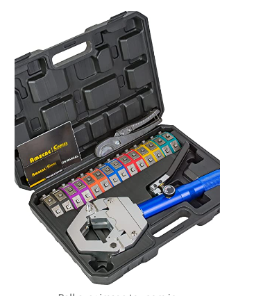

Looks like the Amazon (first pic below) has more dies than the Mastercool one. Curious if the dies are interchangeable?

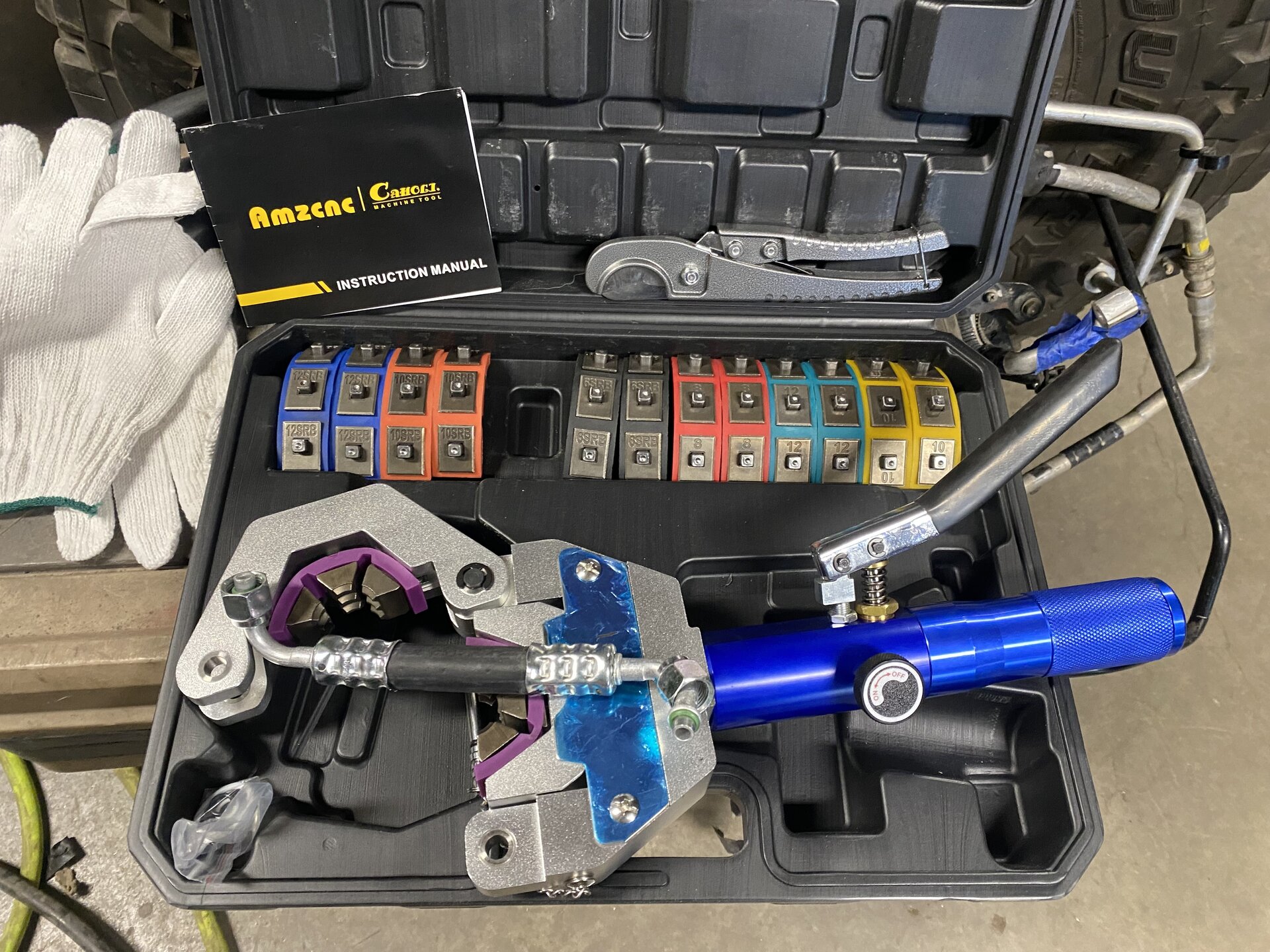

I received the crimper and tried it out. It is made in China as one might expect given the price.
It functioned as I think it should after watching a video. The hose cutter that came with it was a nice addition, seems cheap but was sharp and cut cleanly. The crimp seems tight but the edge seems rough. I will know in time if it holds.

View attachment 3325153 View attachment 3325154
I'd bet the dies are interchangeable - Mastercool also sells the extra dies.
