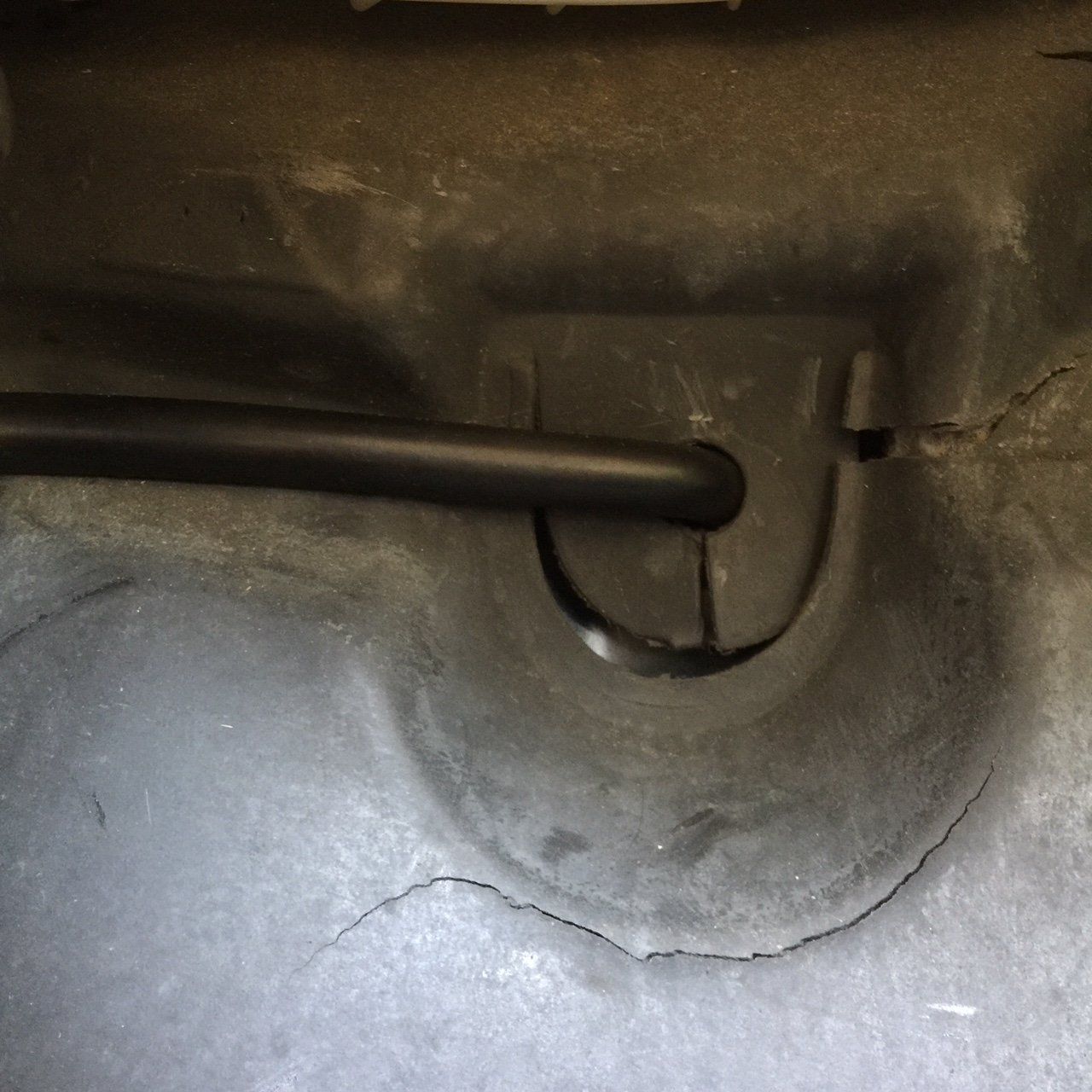

Hey guys, new 2006 GX470 owner here. I noticed my left and right side carpets were damp. I patted them with a towel, as I thought maybe the windows were left open. I installed weather tech floor mats, and noticed water collecting on the passenger side. I pulled off the glove box and was running the AC. The drain tube from the firewall to the behind the middle ac console, was not dripping with ac running, and when driving and turning, there was a sound of sloshing water.
I pulled off the black drain tube that exits the right side firewall, and about 3 cups of water came gushing out. I reconnected it and ran the AC again, and saw the water water continuing to drip from the blow motor, and exiting by a little hole next to the connector plug. Any idea whats wrong? I saw write ups about an AC drain clog, and having to remove the filter element? Can't find it.
**Please help, my wife is going to kill me as I am spending a lot of time, trying to fix this leak. LOL.
Can you blow through the black tube that goes through the firewall? Try blowing it out with an air compressor. If crap is plugging it up where it terminates (or elsewhere) it will back all that water up in the hvac box. There should be no water where the motor is, nor would I expect any type of seal aside from from a dust seal around motor.
The drain tube is all clear, and no obstructions. Im guessing the tube was clogged, and somehow backed up to the blower motor? Not sure. I changed the cabin filter, dried the blower motor, and then reassembled everything. I haven't seen any more drips from the blower motor, at the connector plug.
The drain tube line was producing a wee bit of condensation, that I felt might drip? Is it normal for the drain tube line and some of the ac part behind the dash to produce condensation?
I would agree that the tube was probably plugged and backed it all up, it is a pretty common problem on a wide range of vehicles. I would expect a little condensation on that hose with hot and humid environments such as Ohio.
