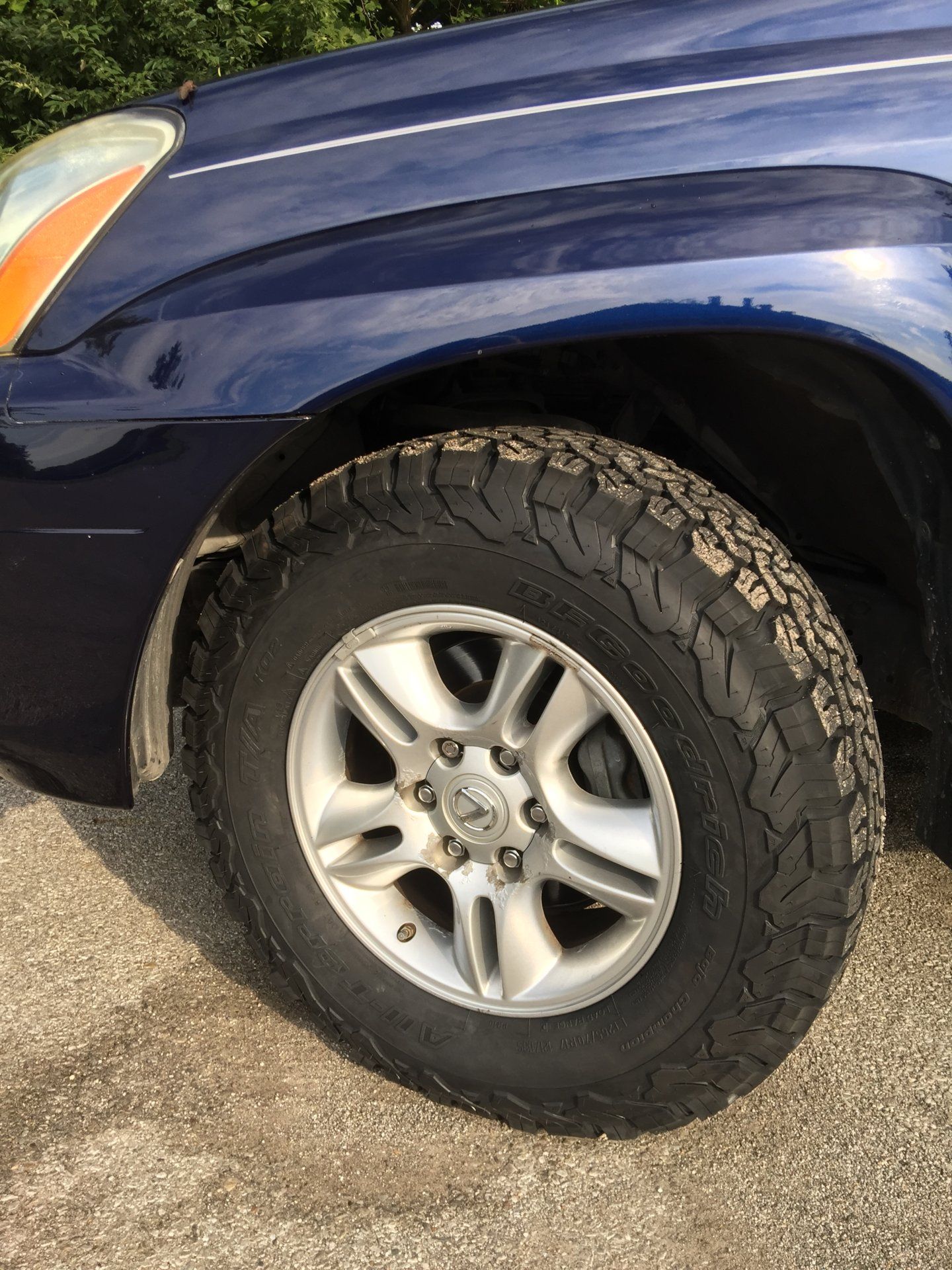

AC Leaking passenger side.

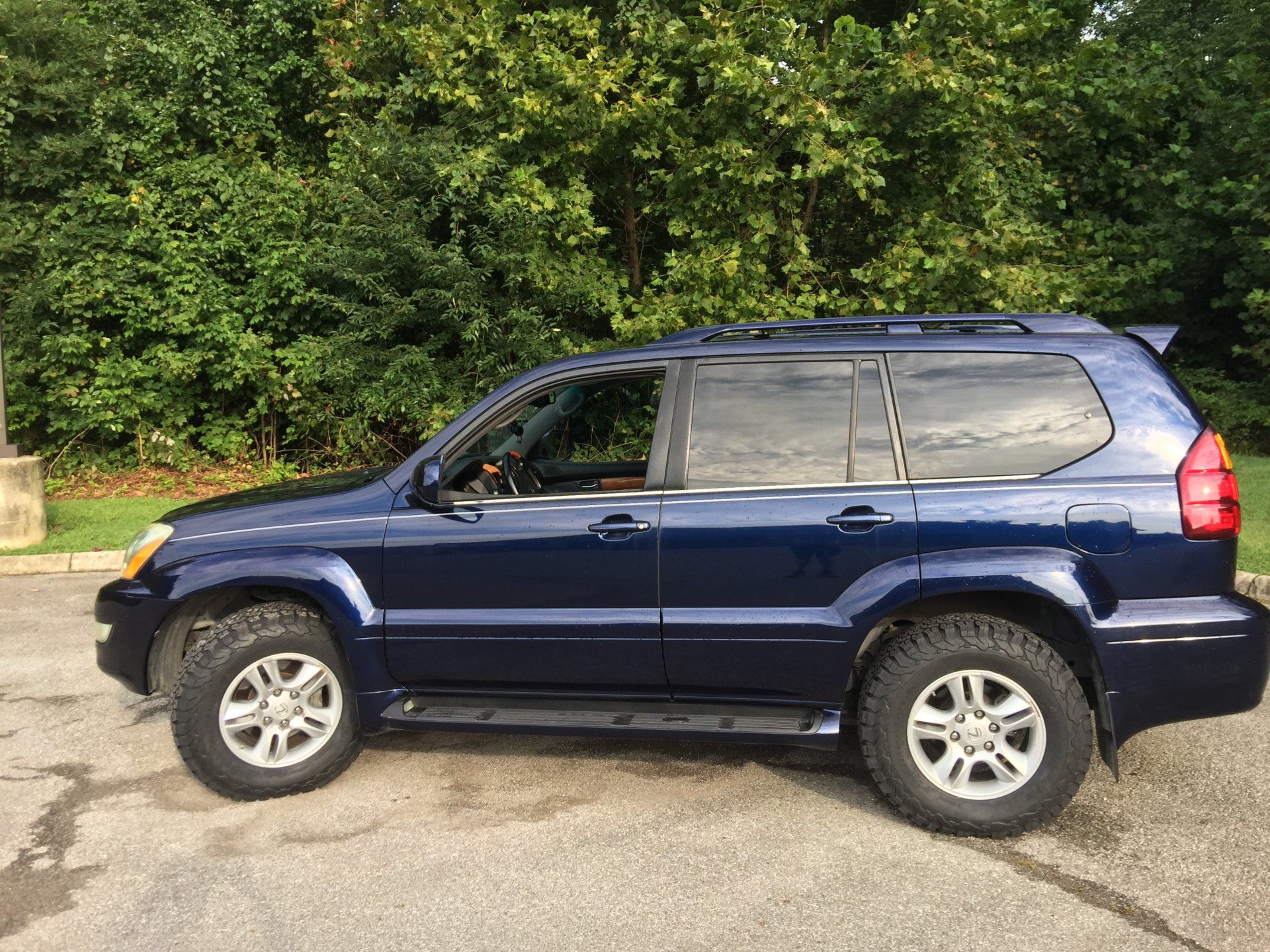

Nice! Looks good, I really like the color. So, Dealer installed 1/2 axles at 113 but, already leaking at 132,000?
19,000 miles only. Maybe better to look around or, if yours are OEM, have them rebuilt.
What size tires? We just did 185 KO2 on ours.
I just noticed you have a Non Nav car. That is awesome!
You can do a AVIC or such for Back Up Camera and Bluetooth for the radio and phone.
I had to go Phoenix Android Radio for ours, Nav model. Its worked well out of the box, truly "Plug and Play". Maybe they are sorted out finally.

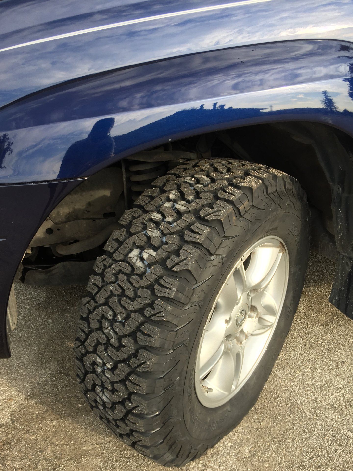

Sorry, Missed the post. Dobinsons Coils, 2 inch lift. Adjustable Bilstein Shocks Set at 2". New everything, Radiator, 1/2 Axles, Plugs, Coils, TB, WP, Brakes, Rotors, Drive Shafts, All fluids done,. We just received the RR, Getting ready for Roof Rack and Bumpers. Waiting for Wheels. Have light bars and such, Just trying to get it all done prior to October.
