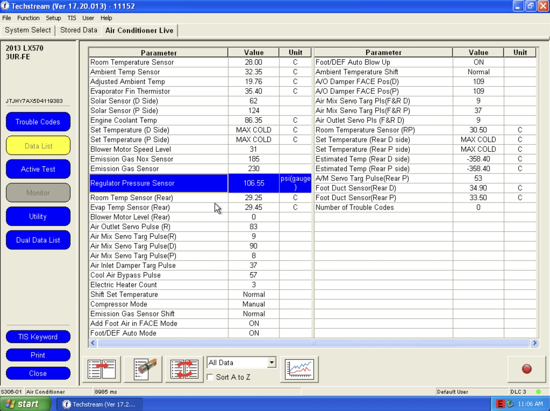

If you go to the live data section for the Aircon module in techstream you can see a whole lot of different lines.. like what the truck thinks the cabin temp is, whether it’s asking for different vent temps than it is producing, etc.
Poking around in there for a while would be a good place to start.
Also, is your compressor clutch engaging?
I think everything looks normal? Is there anything here that sparks interest?

If the AC is running I would expect the evap fin thermistor to be much lower than shown there.
Is your compressor engaging? Clutch on the front spinning? It should cycle on/off around 10-20 second intervals, but the exact timing depends on a lot of factors.
Either way, it should be engaging.
If you have much corrosion, refrigerant leaks at the rear AC connections above the exhaust resonator are somewhat common.

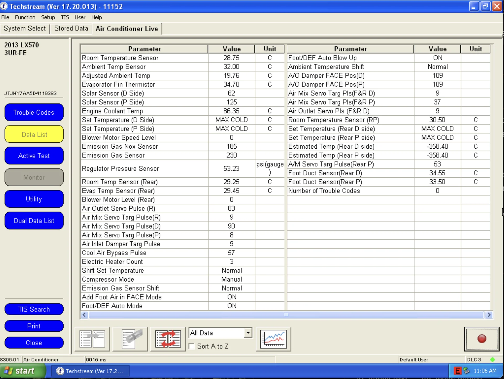

Actually I take that back, it seems the pressure is increasing when turning the AC on. First pic AC off, second AC on. This tells me that the compressor is in working order?

You’d check compressor health with a set of gauges. Basically when it’s engaged, is the difference between the low and high sides appropriate for the ambient temp conditions.
If you’re seeing 95psi all around with the compressor clutch engaged and spinning, yes the compressor is probably shot.
If the pressure were too low in the first place the truck should sense that and prevent the compressor running, in an attempt to protect it.. as it’s possible all the lubricant is gone along with the refrigerant.
View attachment 4162282View attachment 4162285
I’m not sure where they put the “regulator pressure sensor”.. you’d really need a set of AC gauges to properly diagnose the compressor.
But yes it changing pressures points to the compressor doing something.. whether that’s enough for the system to operate normally is a different question.
