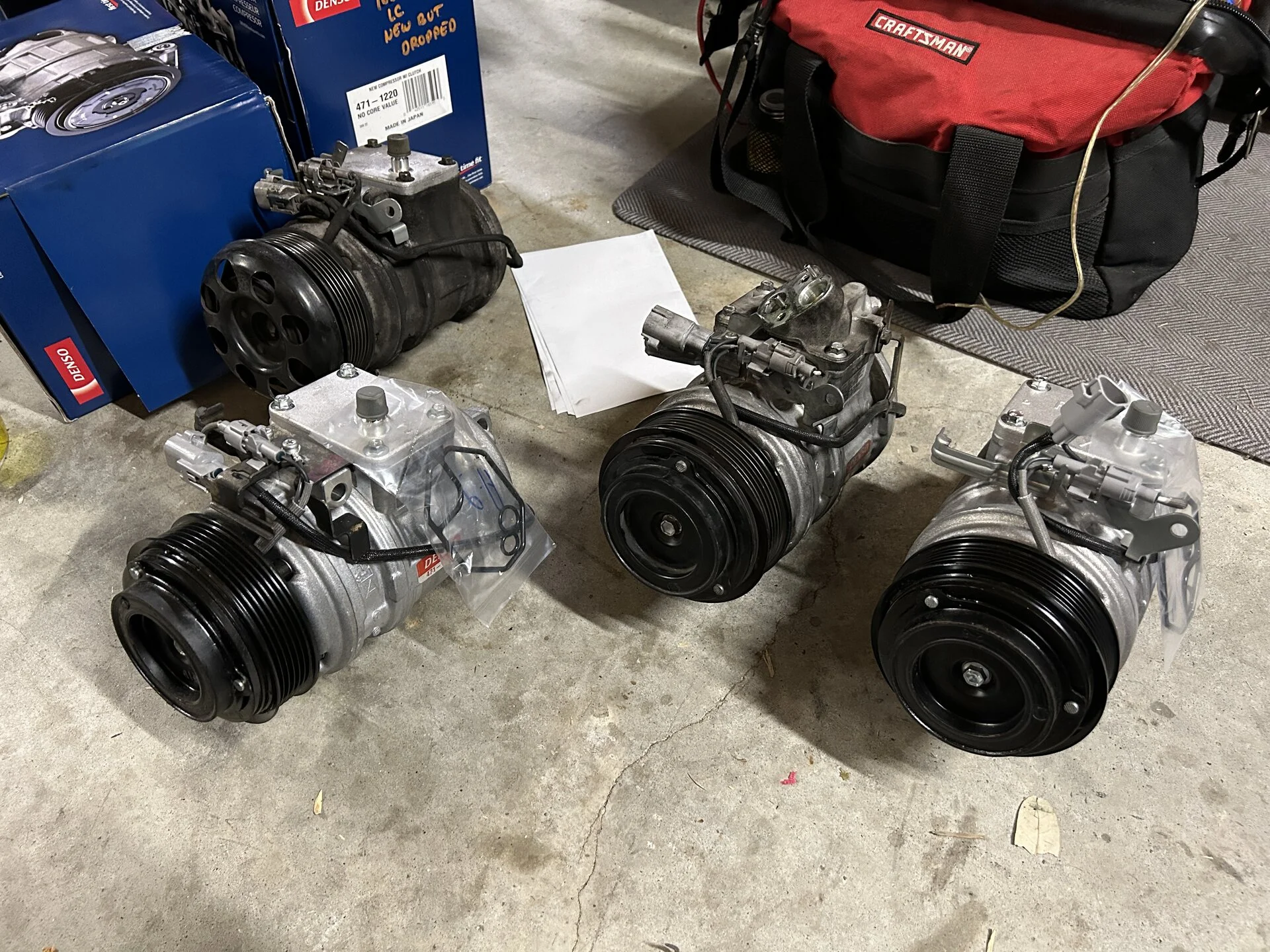

I guess i will buy another Denso AC Compressor and put it on.

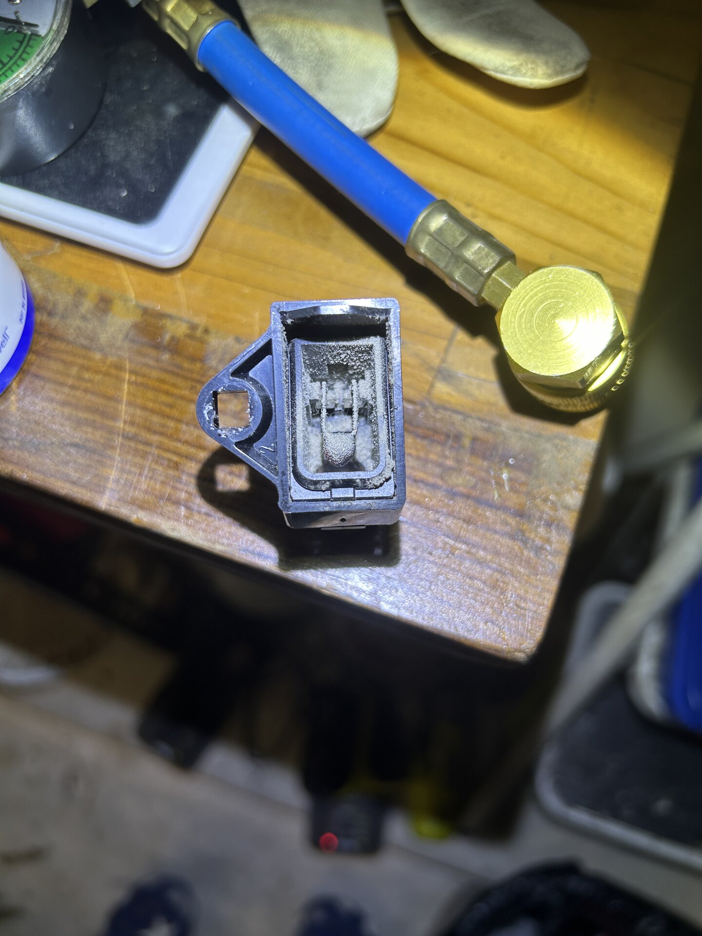

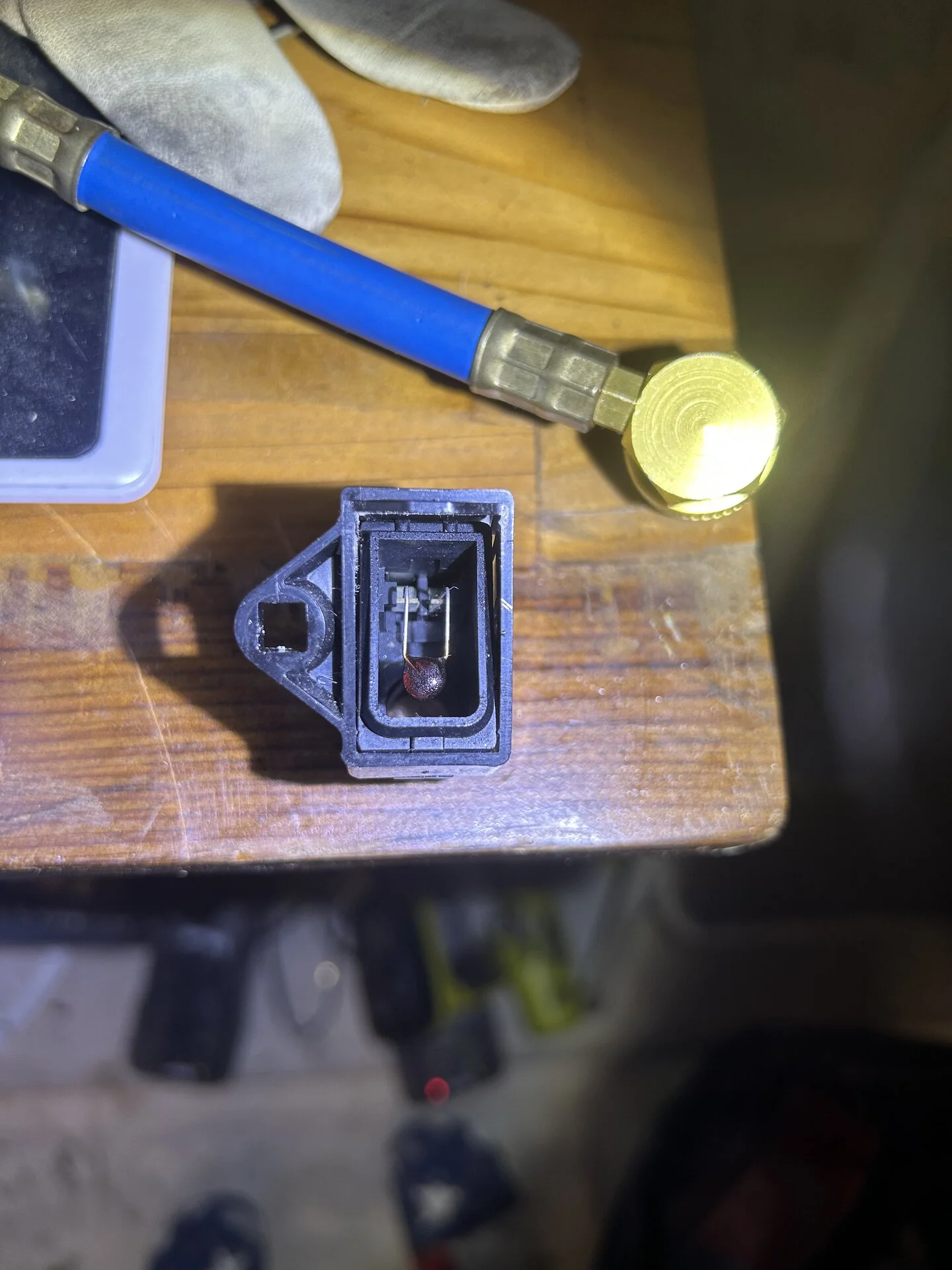

While waiting on the AC Compressor, I decided to clean out the Cabin Air Sensor. It was dirty but didn’t change anything. Ohm’d out correctly.

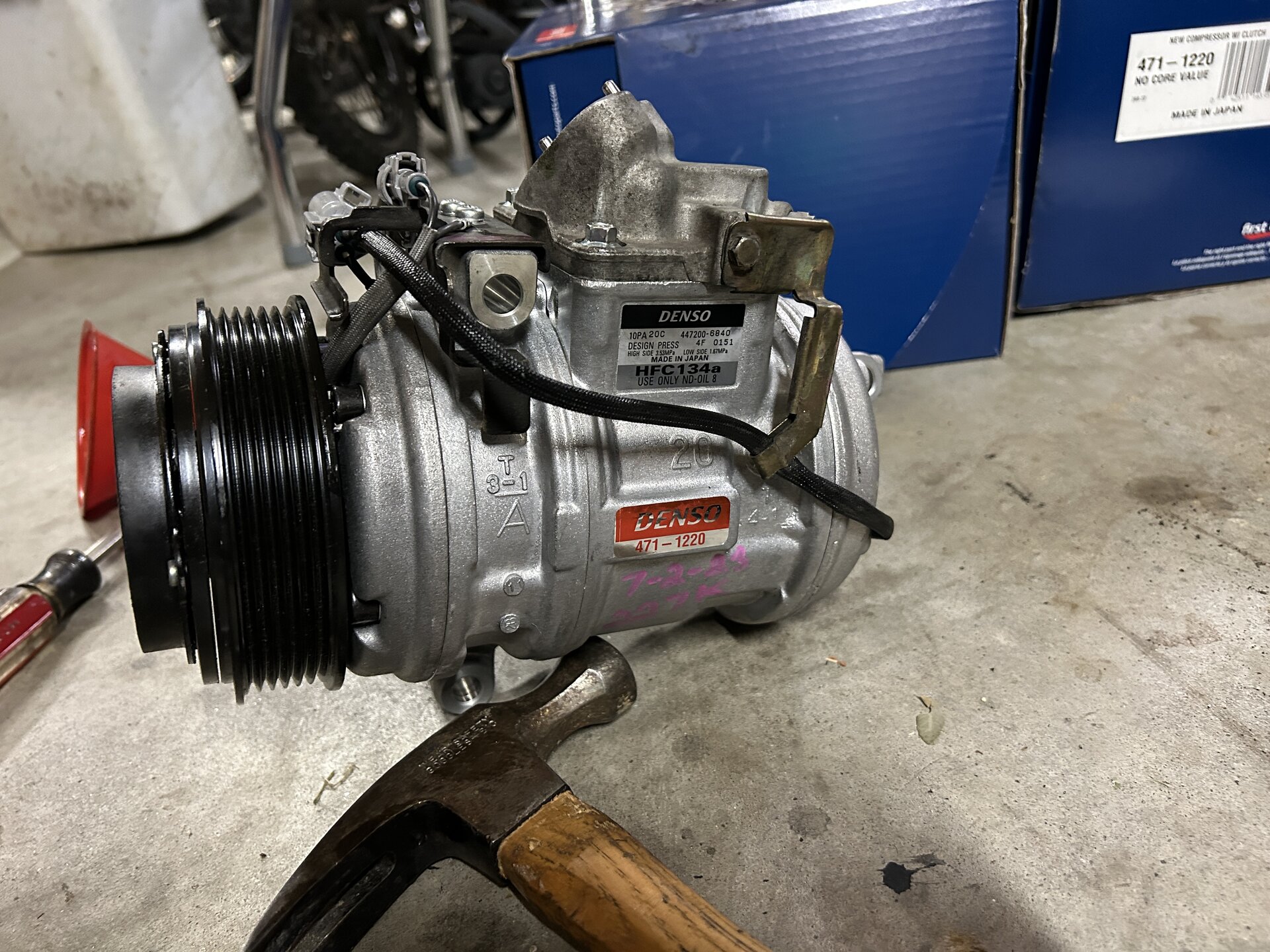

Ordered a Denso Compressor and it had been dropped during shipping. Called and got another one sent out and it came next day (thanks RockAuto). I am getting a nice collection.
Moved all the bracketry over from the original:

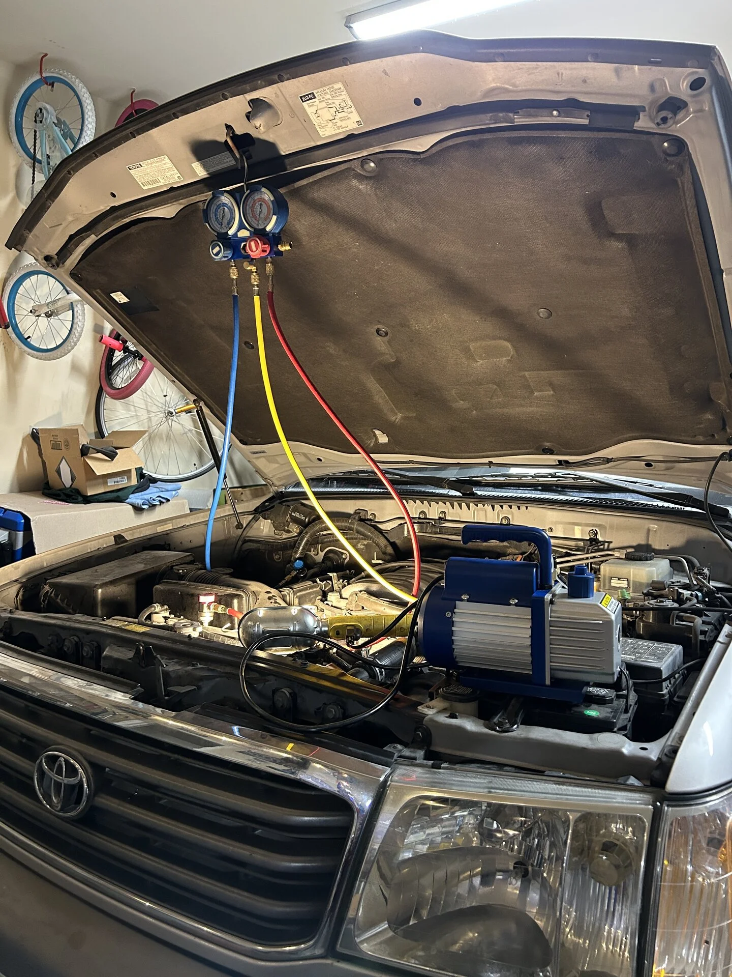

Put it in this morning. Evacuated and filled system.
I got the blinking light close to the end of the 3rd can. I had my wife throttle to 1500 rpm’s while filling. I could not get rid of the foam in the sight glass even after 3 full cans. I am afraid to put more in.
I took it on a typical drive afterwords and the system worked the entire time. Fingers crossed!!!
