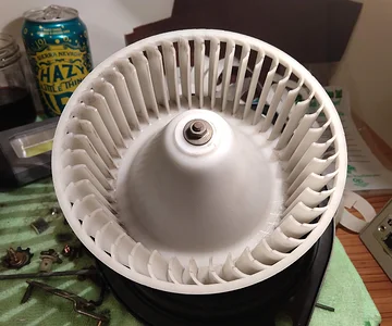

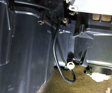

I am a proud new owner of a 1988 FJ62, my ac vents are not blowing hard so I searched some threads, I cleaned fan & it’s working fine. Next checked evaporator, took off 2 clips and screws I could find in front & pried open,,but not able to remove,,,I stuck phone in & took a pic, need to get in to clean out but bottom cover not coming free,, are there fasteners in back? And how do you get to them?

I had the same issue with the evaporator box having debris. I wrote up what I did - it should be on here. In a nutshell, I used a small shop vac with a 3/4 inch hose to pull out as much as I could by coming into the evaporator box via the fan duct. There is also the intake, which is in the cowl directly above the AC fan. Drop the fan, and take a picture of the wire mesh at the top of the 'shaft'. If it was like mine, it was blocked with debris as well. It is not easily accessed from the cowl, so I took the same vac hose and pulled as much thru as I could. In both cases, I connected the hose to the exhaust as well and used that to try and blow some of the debris loose, to then vacuum up more.

on looking a little into this seems there is no ez dropping of that bottom cover of the evaporator,, too bad,, would be nice,, I will start with cleaning out with a shop vac & closing front part of cover I pried down,

Oh you can drop it without removing the dash but installing it again is another story. Lots of clips and screws, more than you think hold that sucker together.
