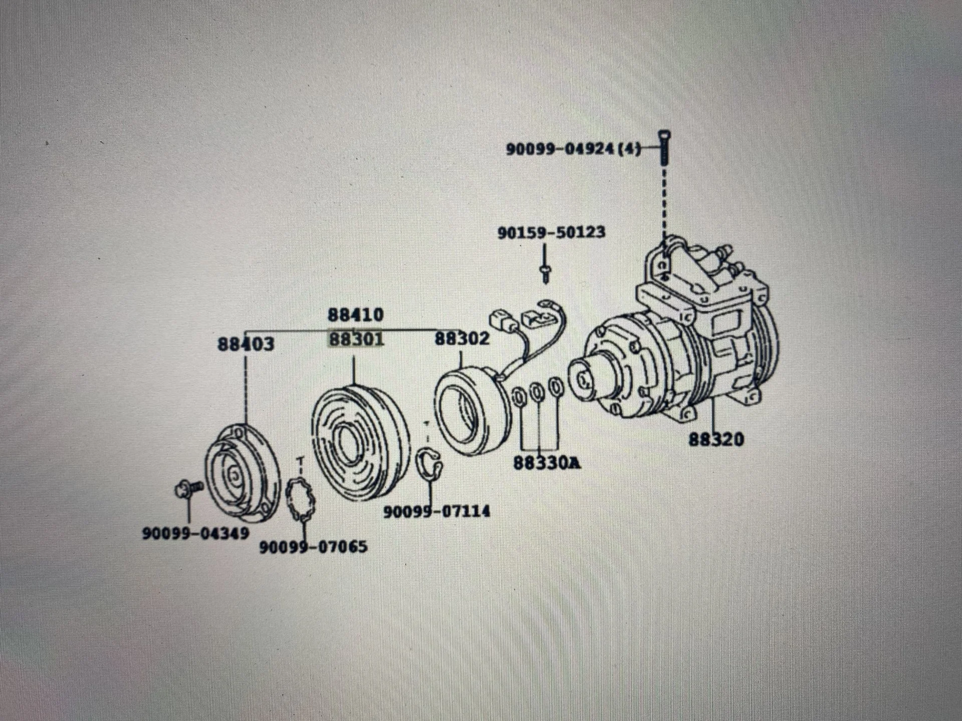

So I’ve started Getting a noise coming from my ac compressor when the clutch is activated, it sounds like a bearing is going bad, it’s noticeable but not a screech or anything. There’s also a red sort of dust surrounding the area now and not entirely sure why, but the wobble on the front end is very noticeable. I’m trying to not need to order an entirely new compressor, so is there a bearing in the magnetic clutch that could be going wrong? Any bearings in parts 88403, 88301, 88302?(see photo)

All I can tell you is when I found a 12V clutch for my 24V truck, my mechanic said he got the bearing from the new 12 and put it in the 24V.
There is a clutch bearing that is relatively easy to replace.Sounds like your issue. Quite common for these to go kaput. I am guessing yours is a denso 10pa17c compressor? There are youtube vids showing 10pa clutch bearing replacements.
Thanks for the info, I’ll give replacing that clutch bearing a shot
