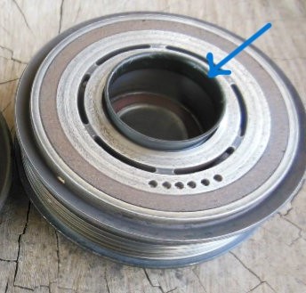

When I was removing my snap ring I deformed this little dust shield. Does anyone have a part number? Or just bend it back close as I can?
