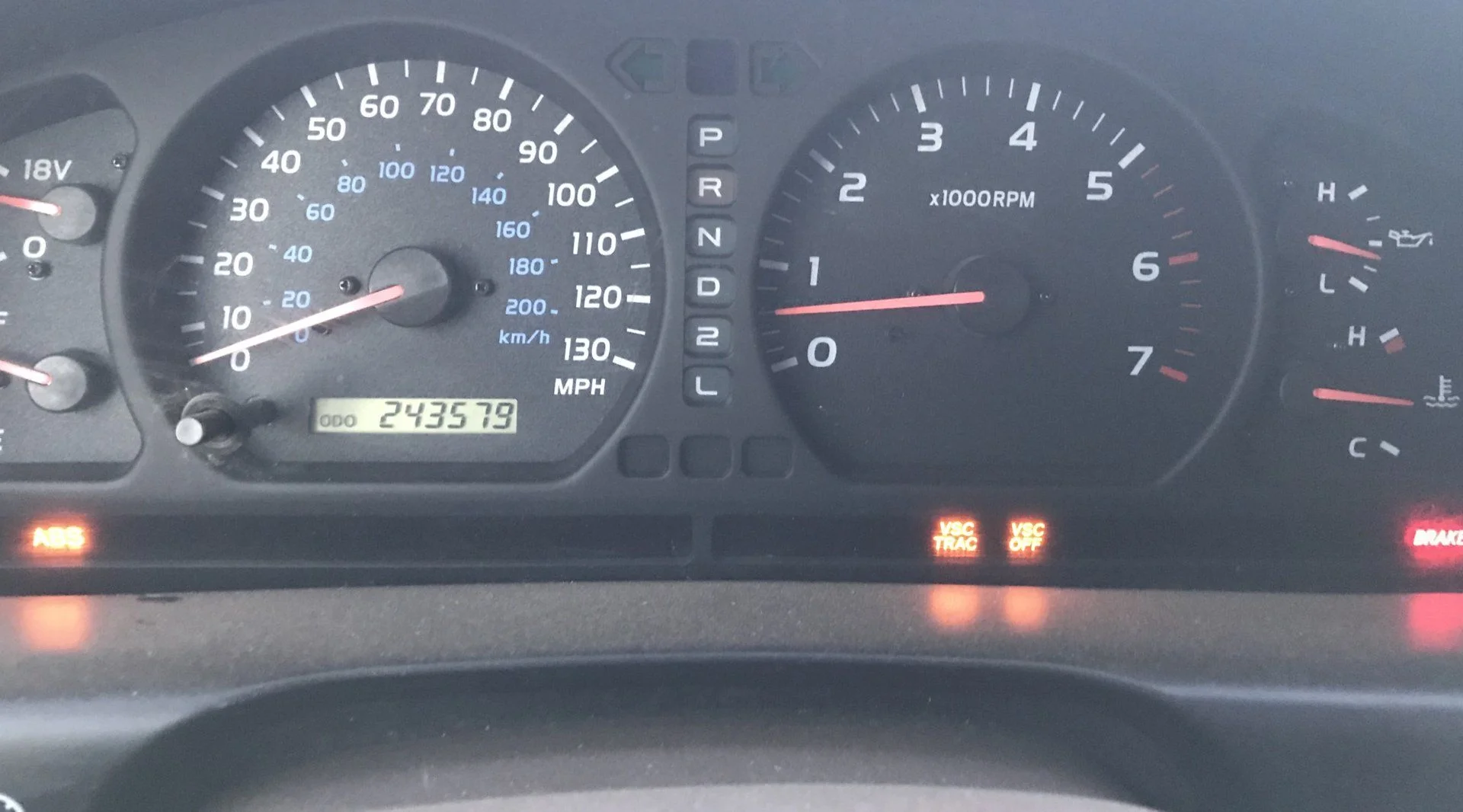

Sometimes I get lucky and the ACTIVE TRAC turns on instead and makes moving quite difficult. Seems to only do that part when it’s under 32 degrees though. They’re never on at the same time however. The ACTIVE TRAC and the others. It’s either one or the others. This is on my 2000 LC.
I was told that the Toyota scan tool can pull these codes, but I won’t be able to get down there until next week. My little Mac Tools scan tool doesn’t show anything since there’s no check engine light on.
Any ideas?
Also, any idea how bad it is to drive with these on or the ACTIVE TRAC coming on?
The active trac was coming on a bunch in moab the other weekend. I finally unplugged one of the many electrical plugs near the master cylinder and it hasn’t come on since. Of course the other regular light are still on.

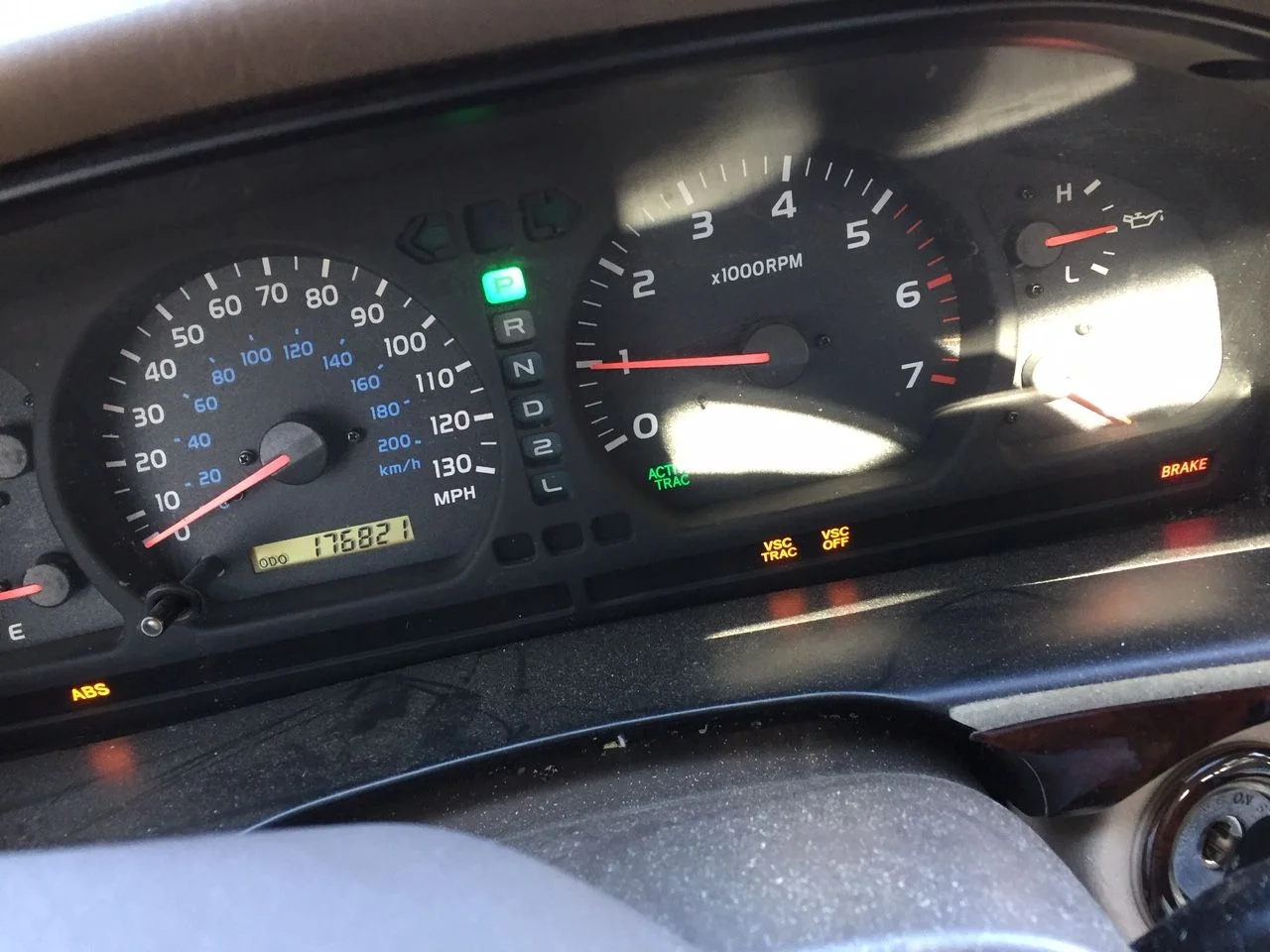

I had a similar problem. ABS, Active TRAC, VSC TRAC, VSC OFF, BRAKE all lit up. Active TRAC came on about 3 months after the other ones.
All attempts at pulling codes (Auto Zone, Toyota Dealership, etc.) all failed. No braking issues, steering issues or alarms. Only thing was ABS wouldn't kick in (tested on wet day in an empty parking lot). Dealership recommended to change the pump, motor, and actuator assembly at ~$5k+.

Ultimately, after consultation with my mechanic (since it wouldn't throw a code, this indicated the abs computer was on its way out) I purchased a used ABS Control Module 89540-60160 for ~$700. New one was $1600+ with no ability for return after purchased. The used one came with a couple months warranty and return within 14 days if it didn't solve the problem. Mechanic swapped modules, reprogrammed and the problem was fixed, lights off and ABS back working. I keep meaning to break open the bad module and see what the guts look like.

Dash lights came on one day and stayed on. ABS didn't work at all. You could tell the 4x4 power distribution was off too, as tight turns/full steering lock felt wrong - as if the diff was locked. I drove it for months like that, avoiding tight turns and hard braking in the rain. I really didn't want to throw a new module in and have that not solve the problem. Thus the buying a used ABS module with a return policy. Worst case I put it in, it didn't work and then I would return for shipping + restocking fee. Essentially a troubleshooting fee if it didn't work correctly. Fortunately it solve my issue.
I checked all the speed sensors and they looked good. My mechanic pointed to the inability to communicate with the ABS module as the reason for trying to swap modules.
