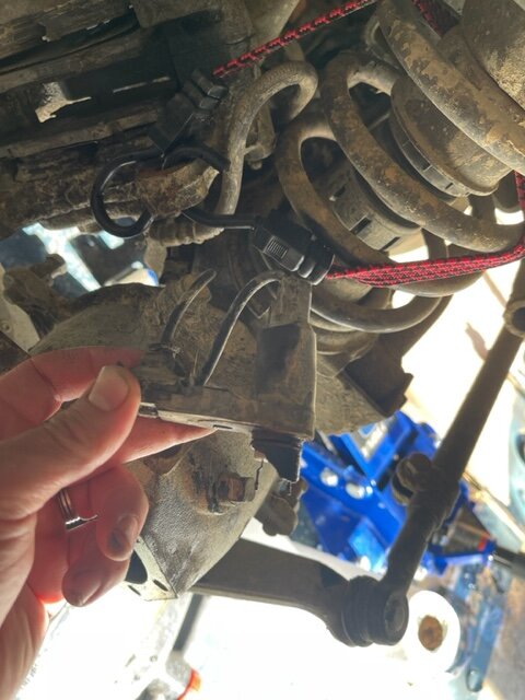

I have a 1997 year 80 series in need of a front driver side ABS sensor. I had a pretty serious failure with a caliper losing its bolts and getting dislodged to underneath the axle. I suspect that the previous owner didn't torque down the caliper bolts very well. In any case, it ruined the ABS sensor in the process or snapping the brake line, etc. I went to get a new sensor, expecting anywhere between $20 - $70. Unfortunately, Toyota only sells the complete kits with both front sensors, wiring, harnesses, etc for ~$1500. That seemed completely outrageous to me. I just need the sensor, which is essentially just a magnet that senses metal passing by. I looked around for aftermarket and used gear, but the cheapest stuff I can find is still >$700. I can find newer model sensors for $20, which is frustrating. Also, from eyeballing one from my buddy's 1993, it looks like they changed the design slightly in 1994 or 1995 from a single magnet to two.
Does anyone know of any compatible sensors? Any suggestions for alternatives or anything cheaper than a multi-hundred dollar sensor?

Is the sensor itself damaged? Can you salvage the harness by splicing in new wiring to replace the damaged section?
I've done this on my '97 after losing a knuckle while wheeling. It's been working fine for years with the repair.

I wish that I did have the old sensor. I had left my cruiser with my mechanic while I had to be out of the state for 2 weeks. Unfortunately, my mechanic lost or tossed the old sensor. He told me about the ridiculous cost of replacing it and decided not to do anything with it until I got back in town. He told me that I called multiple places and some local junk yards, but no one had replacements that were cheaper and those sensors disappear quickly on junked cruisers.

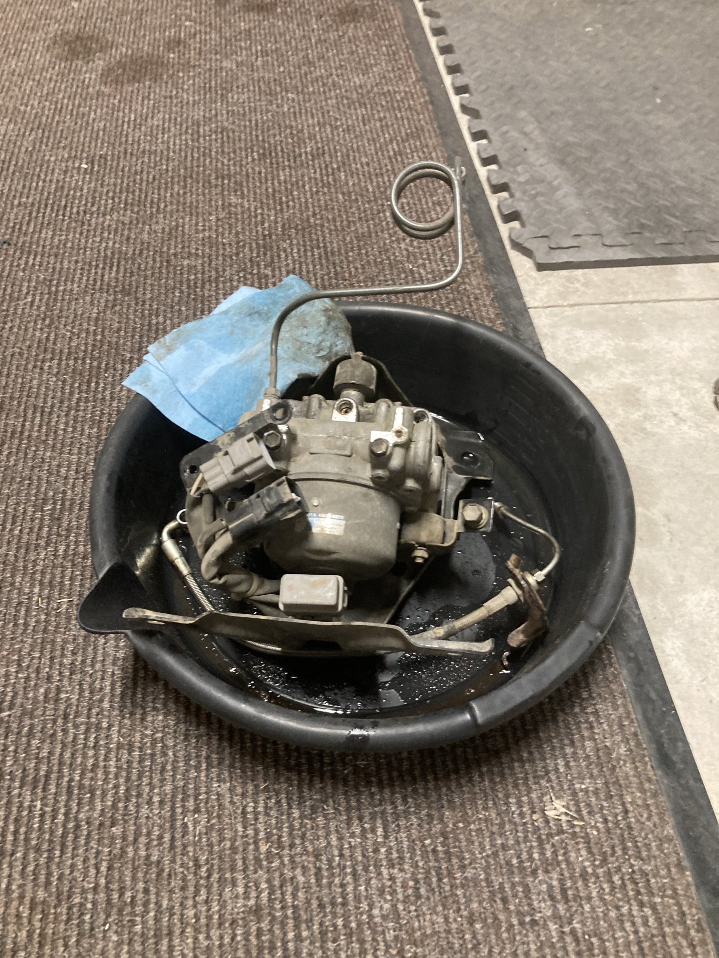

My ABS pump and harness are coming out and going up for sale. But I want to keep it all together and complete. Lmk if you’re interested.
I needed to change one of these, used a 2nd hand unit, they're not very complicated and as long as it looks okay should work fine. That's assuming the harness didn't get ripped at the same time, in which case you should probably just bight the bullet. Check Partsouq and Amayama for the part number. I can get the full harness in the UK for £522 delivered.
Also check your calliper bolt holes in the knuckle, if they're knackered you're looking at a new knuckle
