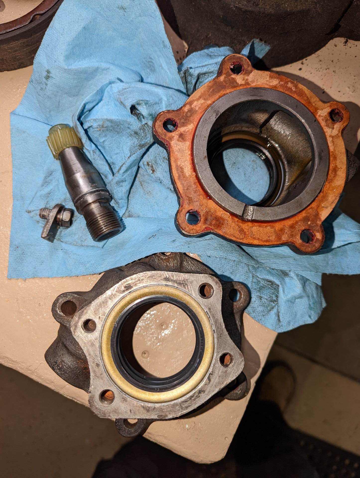

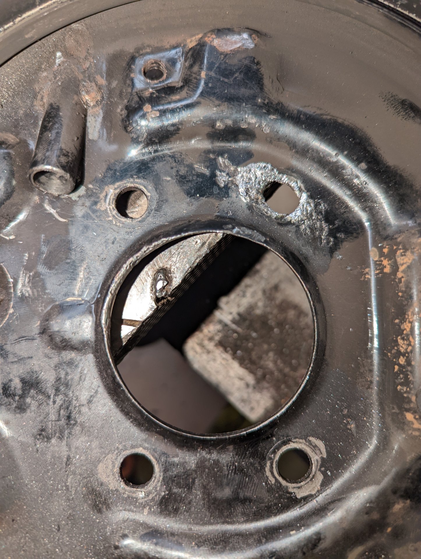

So here's where I'm curious as to what happened. Did I have the e-brake on too tight after install and then trying to drive with the e-brake engaged caused the housing to break? Or did the housing break and then the loose parts and pieces and/or broken cable make it seem like my e-brake was out of adjustment?
I'm leaning toward the housing having broke prematurely because I have noticed a leaking rear seal for a little while but never took the time to inspect it where it might have been coming from.

My guess would be your backing plate bolts came loose allowing the parking brake shoes to bind up in the drum and then snapped the bolt hole in the housing. Your on the right path for repair get the dual seal housing from Valley Hybrids.

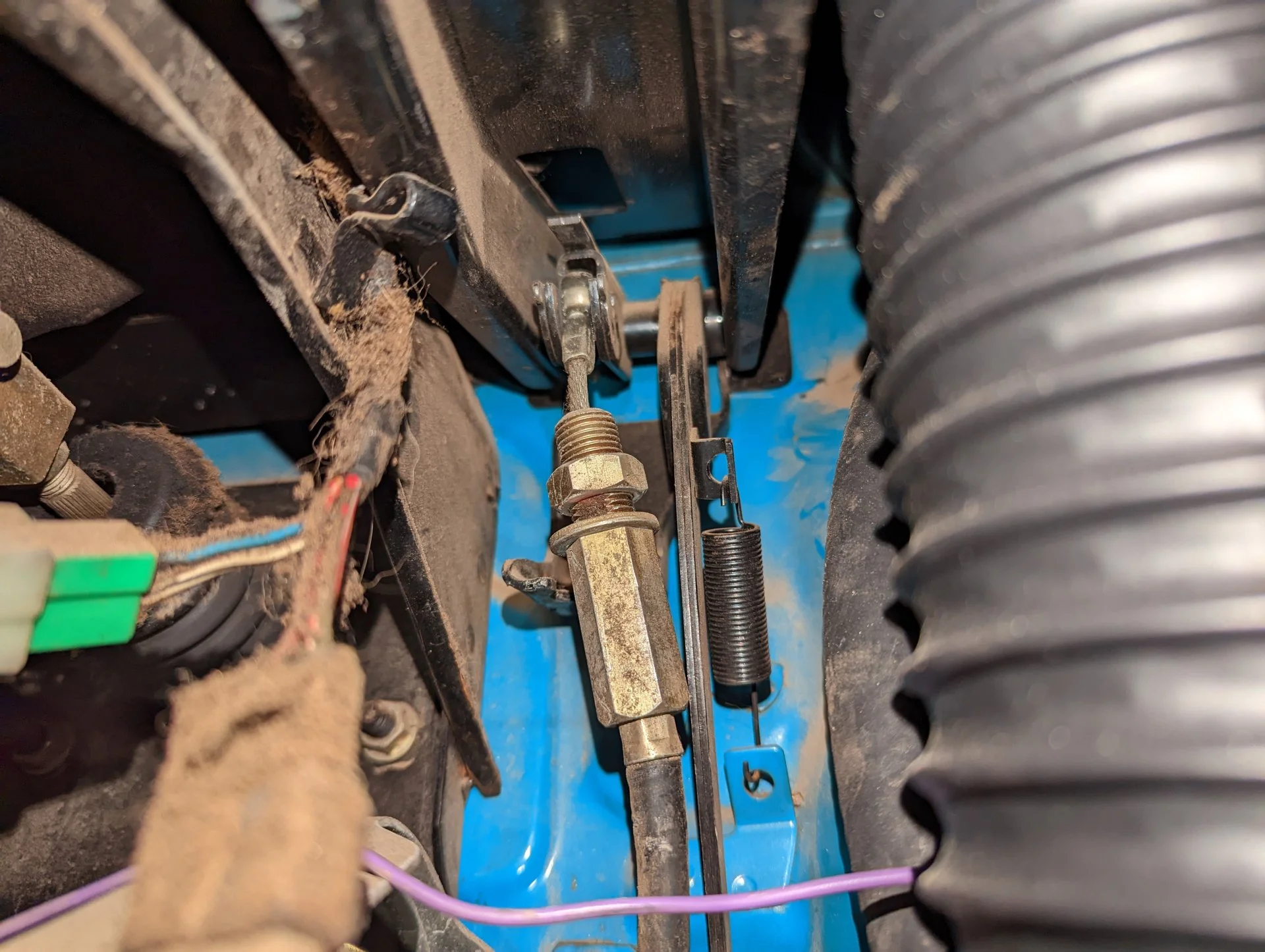

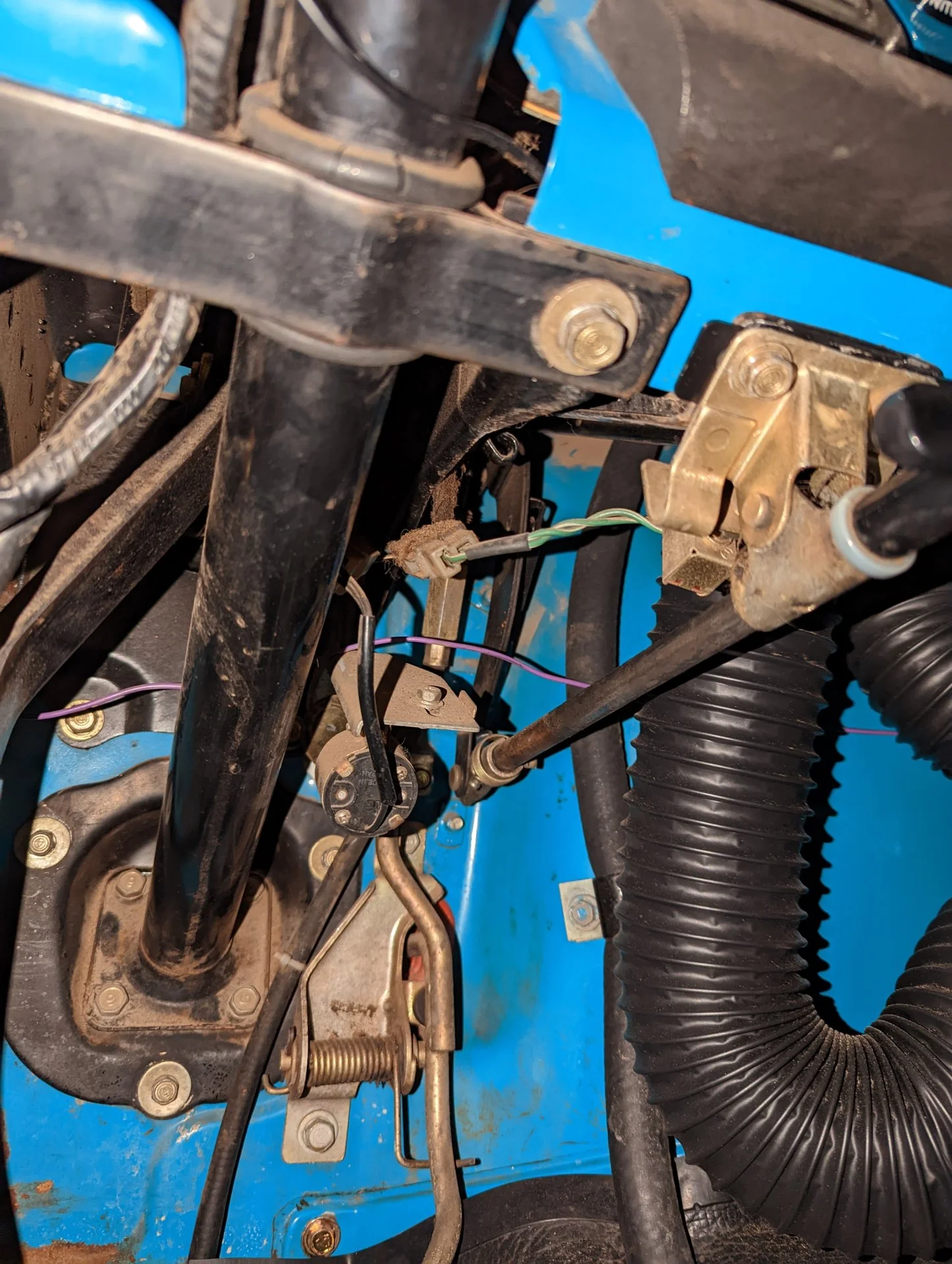

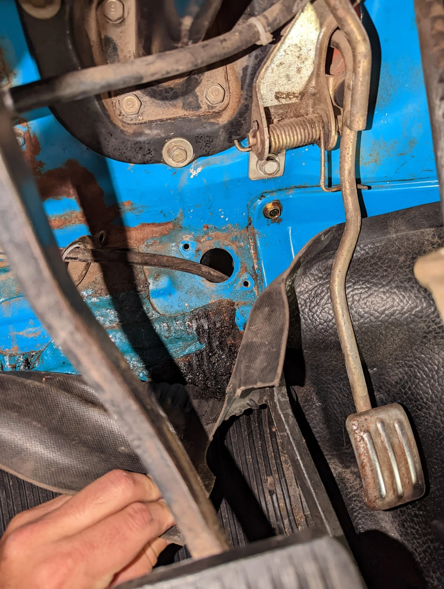

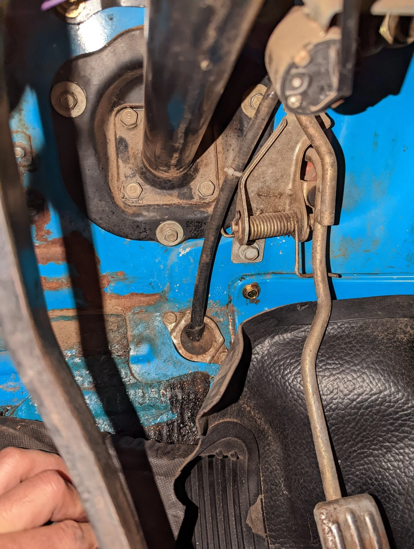

The e-brake cable was a real PITA to replace but I eventually got it. Here's a couple pictures if you're planning on doing this yourself. There's a little tab on the top holding the cable down in place, that gave me more fits than I care to say. But eventually I showed it who's boss.

Also, the purple wire that’s in you ebrake cable post is for Vintage Air right?

Yeah I believe so that purple wire is for the vintage air.

Thanks again Mark for the housing. I've installed it and am just about ready to move the fj40 again after refilling tcase with gear oil. The old one is now back on it's way to you.
