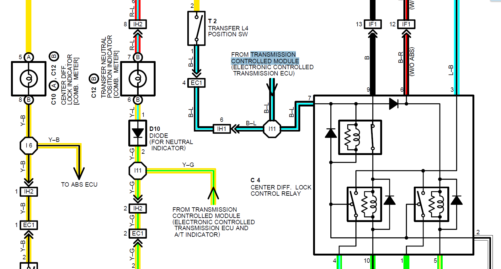

Planning a 14bt diesel swap into my very rough and ugly fjz. This is a super low budget build, so keeping the stock TCM is paramount. I have the FSM, along with the diagrams. By reading the diag flow charts, I've put together the functions of most of the pins. The three that are not giving up their secrets are ESA1,2, and 3, between the ECM and the TCM. Anyone have insight on these?

The wiring diagram manual describes operation as using four ECM inputs to pins 5,6,7,13 on the TCM as well as a dedicated speed sensor to pin 4 on the TCM.
These inputs, as far as i can tell;
#5: NE, pulsed engine speed signal (three per rev?)
#6: IDL, throttle sensor, 0-3v closed, 9-14v w.o.t. I imagine this is an ascending voltage from 0-14
#7 VA, also a throttle sensor circuit, closed= 3.5 to 4.5v, open=2.5 to 3.5
#13 ECT2, fail safe signal? @ 176°F 2-3v

#13 is the shift map switch position; along with #2 switches from normal (ECT1) to sport (ECT2) (my terms). Same as the PWR switch on the 3rd gen 80 series.

That's what the ECT button on the dash does. It's a pattern select switch. There are two, which I haven't found rpm/speed tables for, but when it's pushed in the shift points are later than when it's out. You're farther down the HP/T curve.

According to the System Outline that is part of the Engine Control wiring diagram, ESA stands for Electronic Spark Advance. It is not clear how this affects transmission operation, or why three separate circuits are needed, but your diesel engine will not be using this system and it appears the transmission control does not "need" this info.
