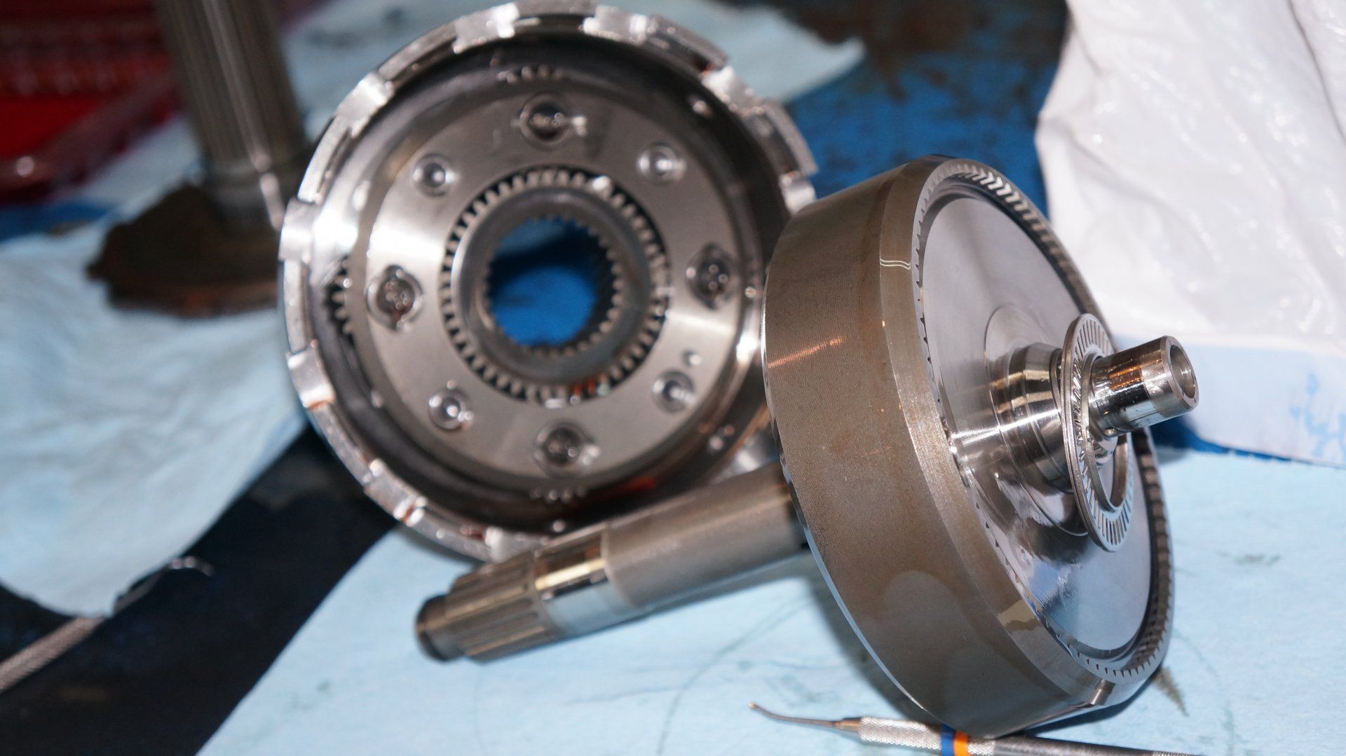

More pictures of the planet gears and the sprag clutch:
Its a good idea to take notes and pictures. These two thrust washers are both the same part number but cannot go back together mixed up. Its important to keep the wear items in order if you're not going to replace them with new.
Removing the front planet set from the intermediate shaft.

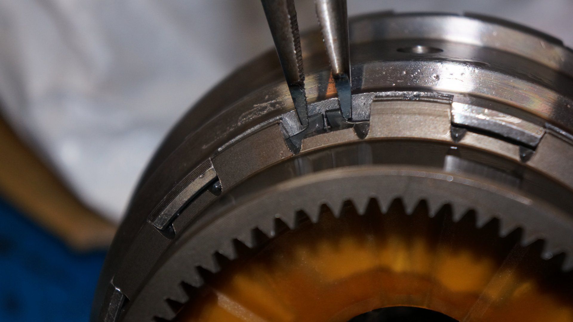

To get at the rear planet set I had to modify a cheap pair of needle nose on the bench grinder to release the snap ring. Snap-On be Damned!!
