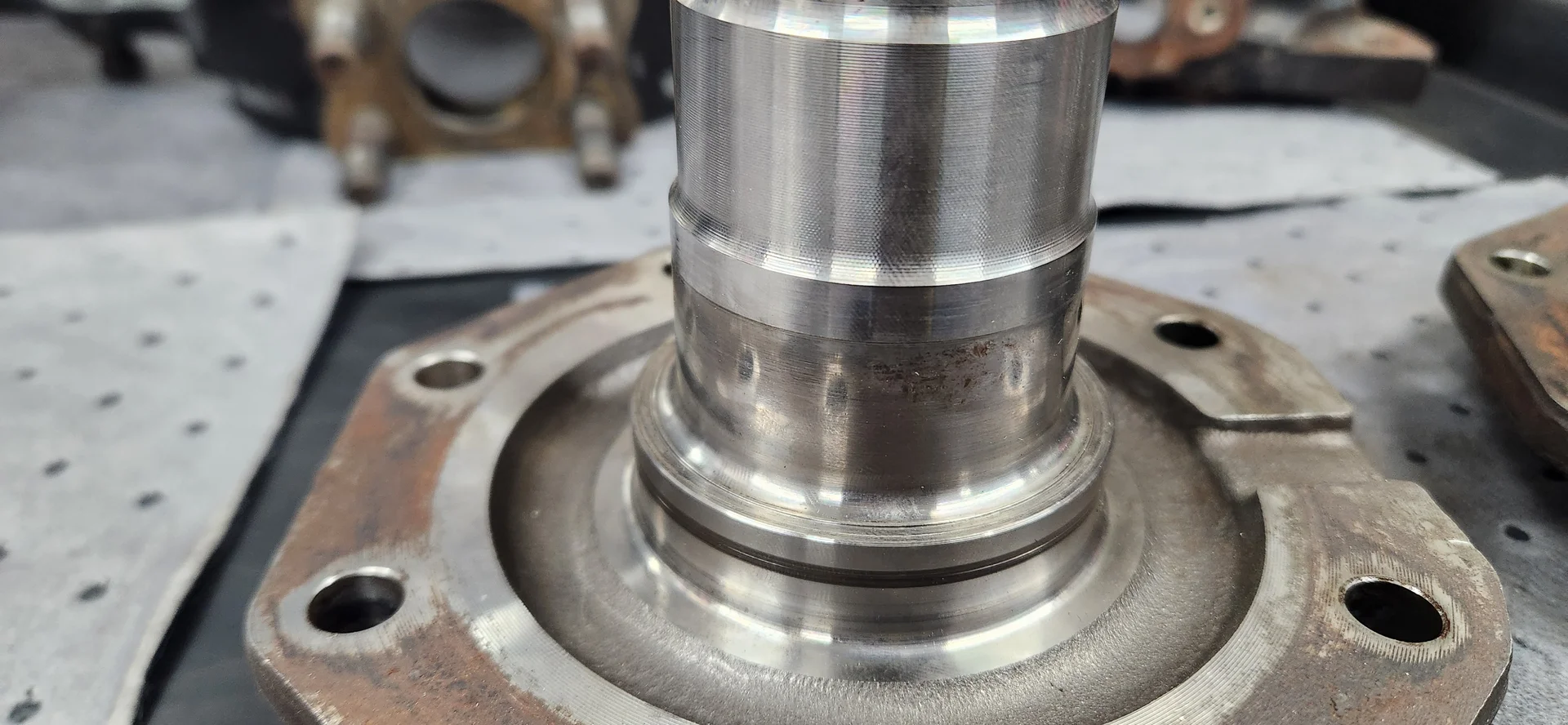

What do your spindles look like, they can develop grooves from the hub seals and a wear step if the bearing preload is loose potentially causing the tire/hub to rock in and out on the spindle: post up some photos showing the base and the end of the tube, side views

Got photos of your Spindles?
If they have been run with very loose bearing preload the Spindles may have been damaged to the point where they
won't hold bearing preload in the future.
And if you buy new Fuji Joint Spindles they come with the bushing/bearing installed.

Crap you might be on to something.
Upon furter inspection is seems there is a significant step on one side of the spindle and not the other, at least for the outer bearing.
You can see it pretty easily in the pics.
Can't say that the space where the inner bearing rides looks that great either.
Not as bad as the outter but still not great.
Also a little crazy how burnt the the area is where the seal rides.
I think some new spindles probably aren't a bad idea.
One test is to take a new outer bearing and slide it on the spindle, if it rocks ie: in/out at 6-12 positions the spindle is worn, there should be zero rocking/wobble/looseness, IME. Looks like the inner bearings were spinning some on the spindle also.
To work around a worn surface where the hub seal rides you can install Terrain Tamer HD hub seals; they are a cassette type seal ie like two seals (inner and outer) interlocked, the inner seal that slides over the hub does not rotate on the spindle, all movement is between the two interlocked rings so to speak.
New Fuji Joint Spindles (or OEM) would solve a few issues if you've got the coin, add the TT hub seals and forget about it for awhile.
The deep groove in the long side axle shaft will need something to fill that gap ie: if you use a SpeediSleeve.

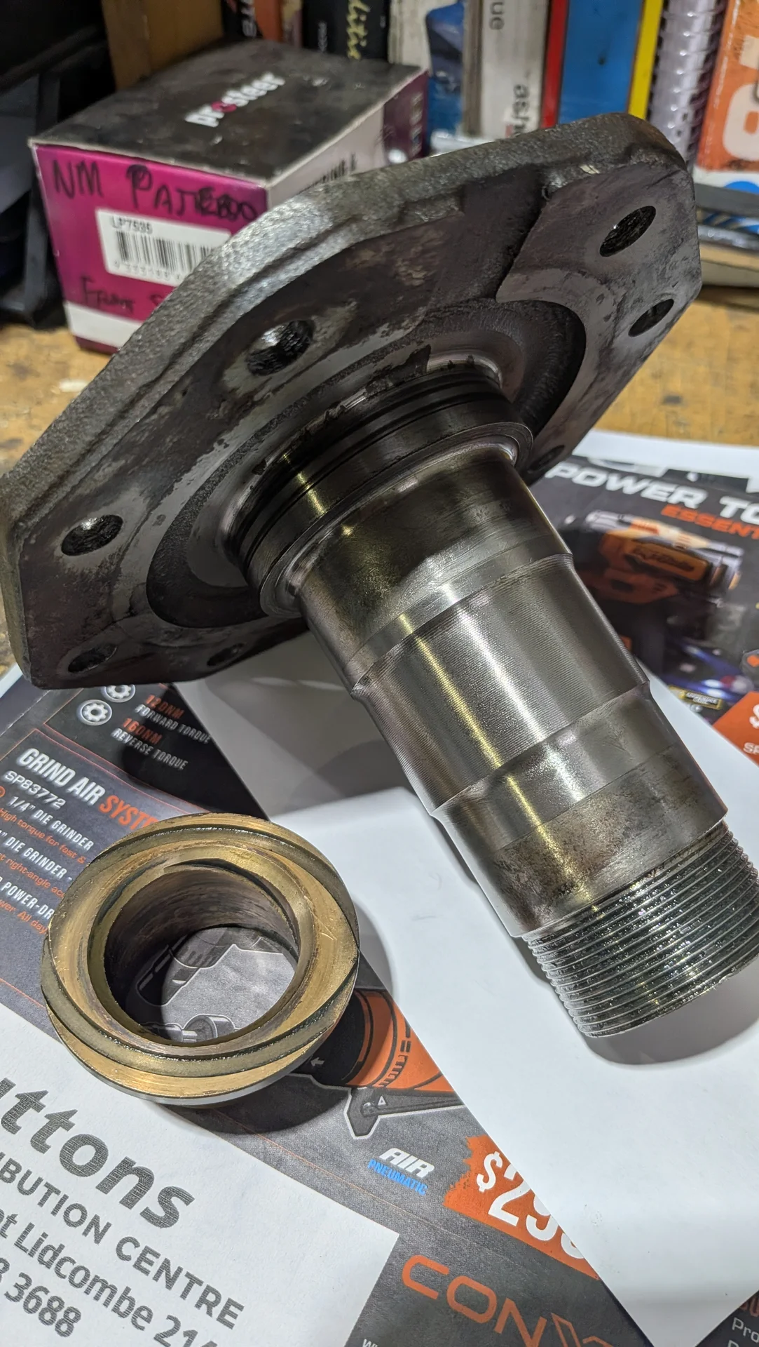

All of the new spindles have the needle bearing that the 100 series use. I’m sure it’s fine, but I also prefer the OEM bushing since needle bearings don’t like to roll in moly grease. If you get the OEM bushings directly from Japan, they are about $20 each and easy to replace. The spindles are dramatically cheaper if you get them from Japan as well. If you have a couple months to spare in the future, you can get new pair of Toyota spindles and bushings for about $250 shipped.
This was mine after 150,000kms on the originals. The bush just fell out on disassembly. The wear is starting. I just put new terrain tamer spindles (which came with bushes).
