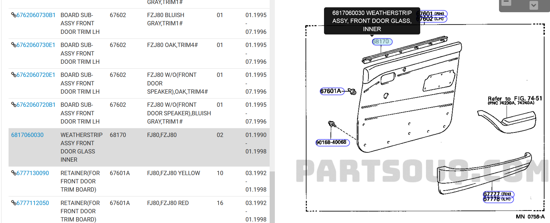

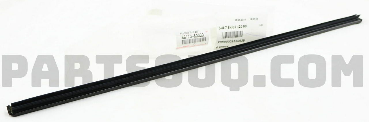

The window runs do not have felt on them, the weatherstripping does:
All four windows are similar.
