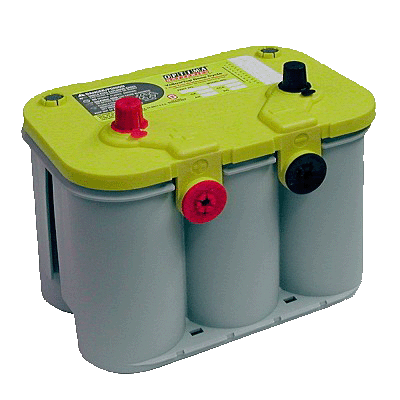

The box before being modified by Wayne, and a Yellow Top battery by Optima
The Painless dual battery kit showing all of the parts laid out

Optima Yellow Top model D34_78
http://www.optimabatteries.com/optima_products/yellowtop.php

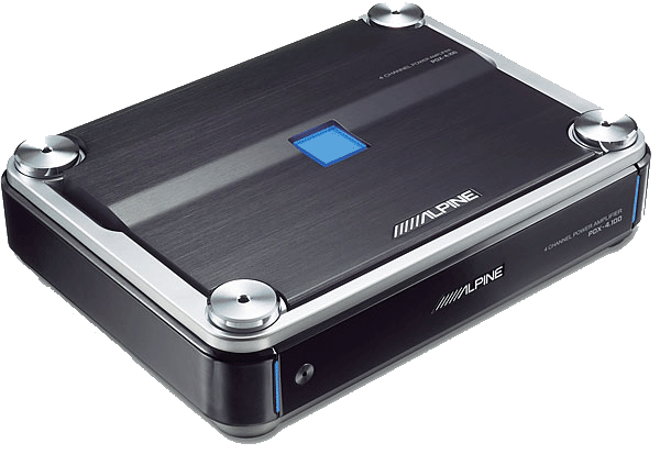

Phase II audio system installed 11-17-2007
The first phase was to remove the factory headunit detailed earlier in this thread back at the end of March 2007.
The second phase consists of getting rid of the junk factory speakers and going with better ones that let the real music come through, and also an amplifier to power the speakers in all their glory.
The following components were installed stealth, you can not tell they are there.
1. Focal 165V2 6.5" component speakers with tweeters.
The Focals replaced the factory 6x9s in the doors, and the tweeters replaced the factory speakers up in the dash.
The shop made custom plates that matched the factory ones to hold them in the cavity of the door.
2. Infinity Kappa 3.27KF 3.5" speakers for the very rear in the cargo bay.
We were going to do Focal 4" speakers, but they were to deep to fit in there.
Plus the Kappas were close to $100 cheaper.

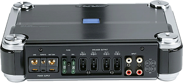

3. Alpine PDX-4.100 amp which is a four channel amp pushing out 100 watts each channel.

Below are some pictures I pulled off the web of the components since all my gear you can not really see.

Alpine PDX-4.100 amplifier
