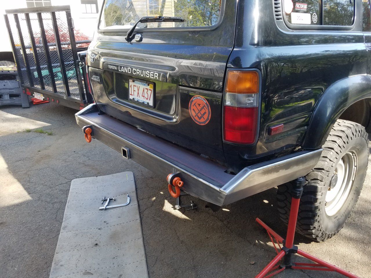

Quick welding tech questions for you. On the front bumper what type of stainless are you using for the add ons, like the bottle opener? What filler rod are you using for the stainless to mild steel welds? 309?
Are you able to tig outside? You had an image with the TIG torch resting on the bumper outside, Just curious if you bump up the PSI on the shielding gas or something clever to combat the elements, like wind.
Did you go to 3/16 on the rear bumper to handle the swing outs? You did did 10 gauge on the front bumper and I know my front bumper always see more abuse than the rear (there is a joke there somewhere). Always forward!!!
Last question (for now) do you have a jig you are using to bend the round bar tie downs on the front bumper?

If its 304 ss use 308 ss filler rod ;)

HI and thanks for the questions and kind words. For stainless type I'm using 304. And for welding stainless steel to mild steel I typically use 309 filler. As far as tigging outside I was only tacking things up on the truck. I do run a furick cup and gas lense though so my gas settings will probably be different than yours.
On my front I originally built the wings in 10 gauge and do offer them in 3/16. The weight difference is only 12 pounds though so I might be dropping the 10 gauge and just offering the 3/16" as I seem to be selling more in 3/16". For the rear I went that size for strength and abuse resistance. The area were the swingout mounts will go is actually 1/4".
And as far as a jig for the round s/s tie-down loops. I actually made a dedicated tool that mounts in my vise . I have a set cut length and start stop lines on the tool. It works perfect and my waste is minimal on material. Here's a pic. Almost all of my jigs and unique tools are made from scrap or broken tools. The handle on this was a neighbors broken harbor freight breaker bar. The other parts left over from random projects.
that's the loop he's referring to if your just seeing this.
And this is the bender I made to make them. The material in that pic is longer than I actually use.that was the first test piece to figure out cut length.

For the back bumper I do have a couple suggestions. First, put the light mounts inboard of the clevis points even though the frame clearance is an additional PITA. The added protection for the lights against errant rocks and stumps would make it worth it.
Second, a design point. My own truck is not lifted- a deliberate decision due to the many off-camber trails in my area (some approaching 30 degrees of tilt). As a result though, I drag my bumper and undercarriage ALL. THE. TIME. So I build for that. I have some excellent armor underneath and have some more on the way, but one problem I have is that the underside of the factory back bumper catches on stuff and hangs up. Sometimes I have to use a jack to get going again. It looks like your rear bumper already has some material underneath it and I assume that it will take just as much beating as the rest of your excellent work, but putting in some upward deflection in the leading edge of the plates would help a lot in making it slide over things.
I have been considering building a rear bumper for my rig similar to your prototype here and hope to be able to started on it this year. My own personal prejudice against swingouts will make mine simpler, but I am also trying to incorporate a 12K gear-drive rear winch underneath in the factory spare tire location so that will complicate things.
I'm sure mine will not look anywhere near as nice as yours, but hopefully I can at least get it to the 'far from good, but good from far' point.
Thanks for showing us hobbyist fabricators what nice work really looks like!
Thank you for your generous compliments! And very good input. And I leave you this pic as too what I'm working on now along with mounting/bracing points and finish welding until my swingout stuff comes in.
