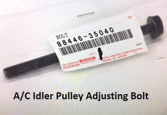

Anyone ever find the part number or vendor for the bolt?
Wits End
So this will work on a FJ62?
No idea, you are in the 80 series forum section and we are discussing what fits an 80 series. IF the FJ62 has a similar tensioning device then I would think it would.
Sorry about that. I didn’t realize I was in the 80 series section. Disregard.
If this bolt is the same as for my 89 FJ62 with 3fe I need one now!! You guys say Joey has them at W.E. ?? He just moved here to Medford.
Hi, Personally these bolts are weak, I’ve replaced most of my tensioner bolts on my fj62 s and fj-80. Upgrade to a stronger bolt. Mike
