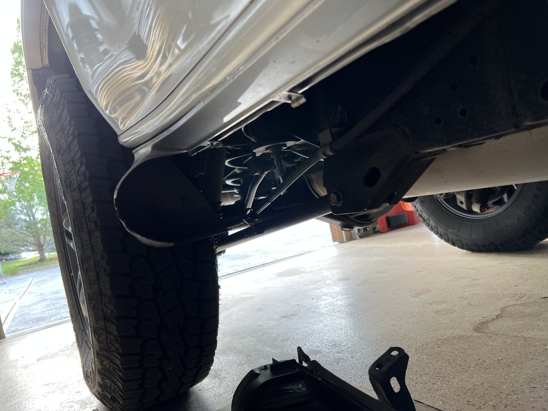

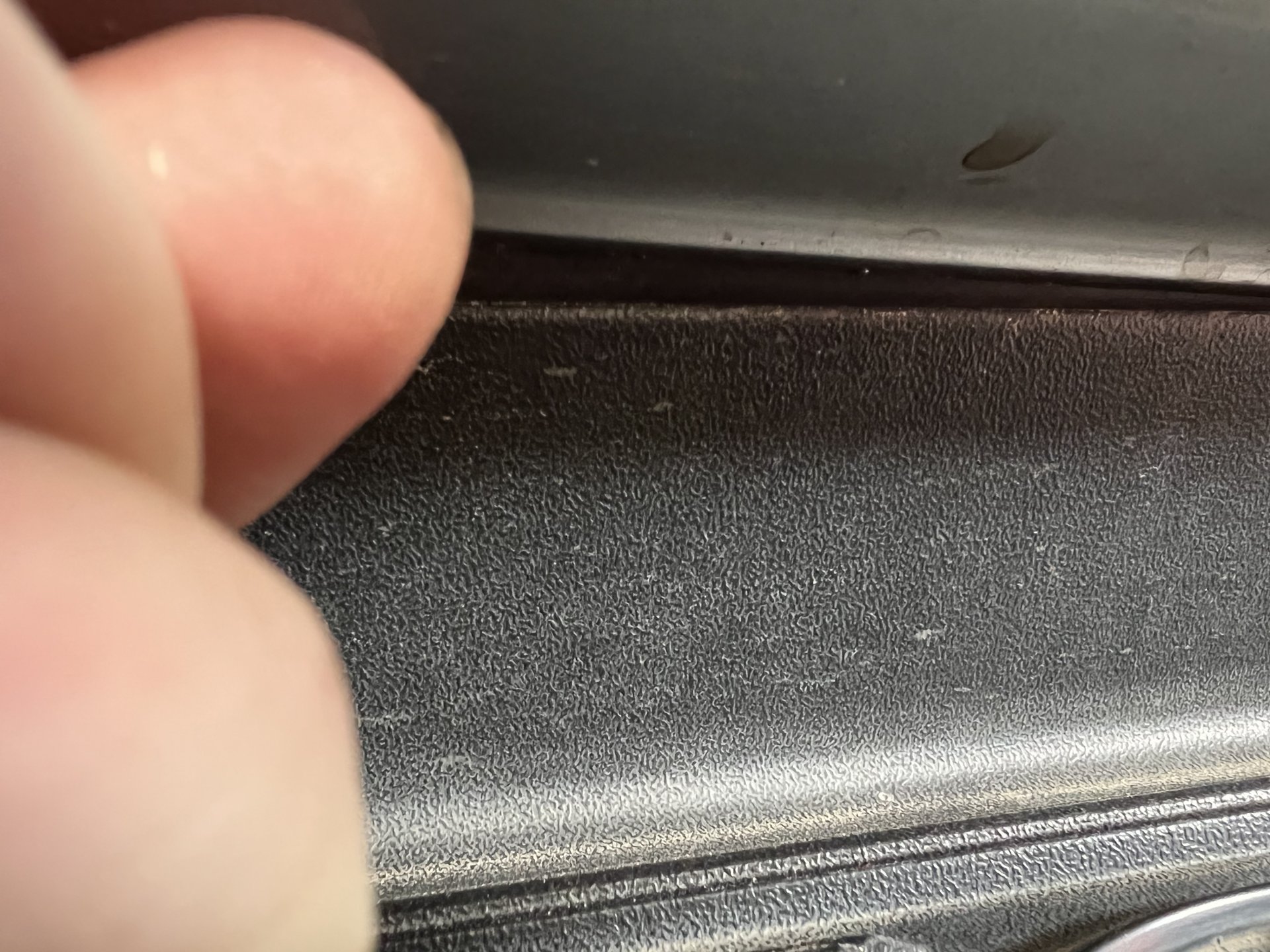

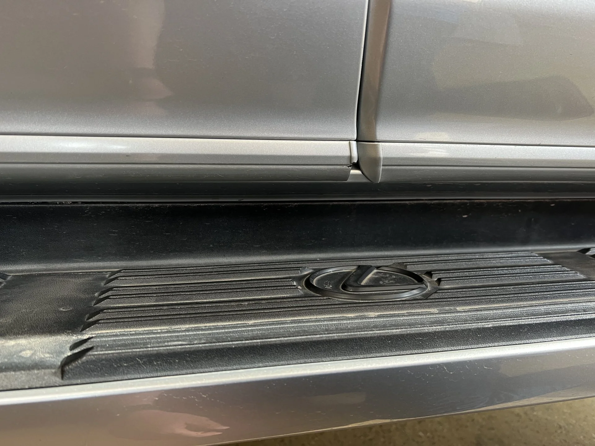

I started poking around under the truck and realized that the black step is riveted to the color matched shroud. View from below:

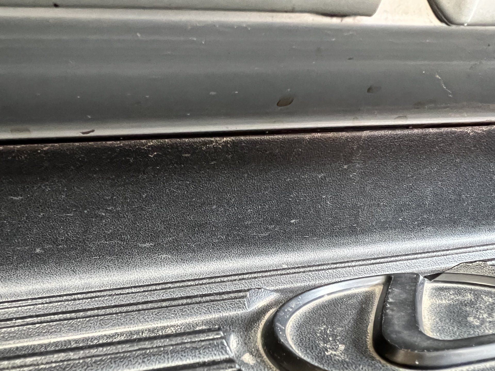

Here is the transition from above

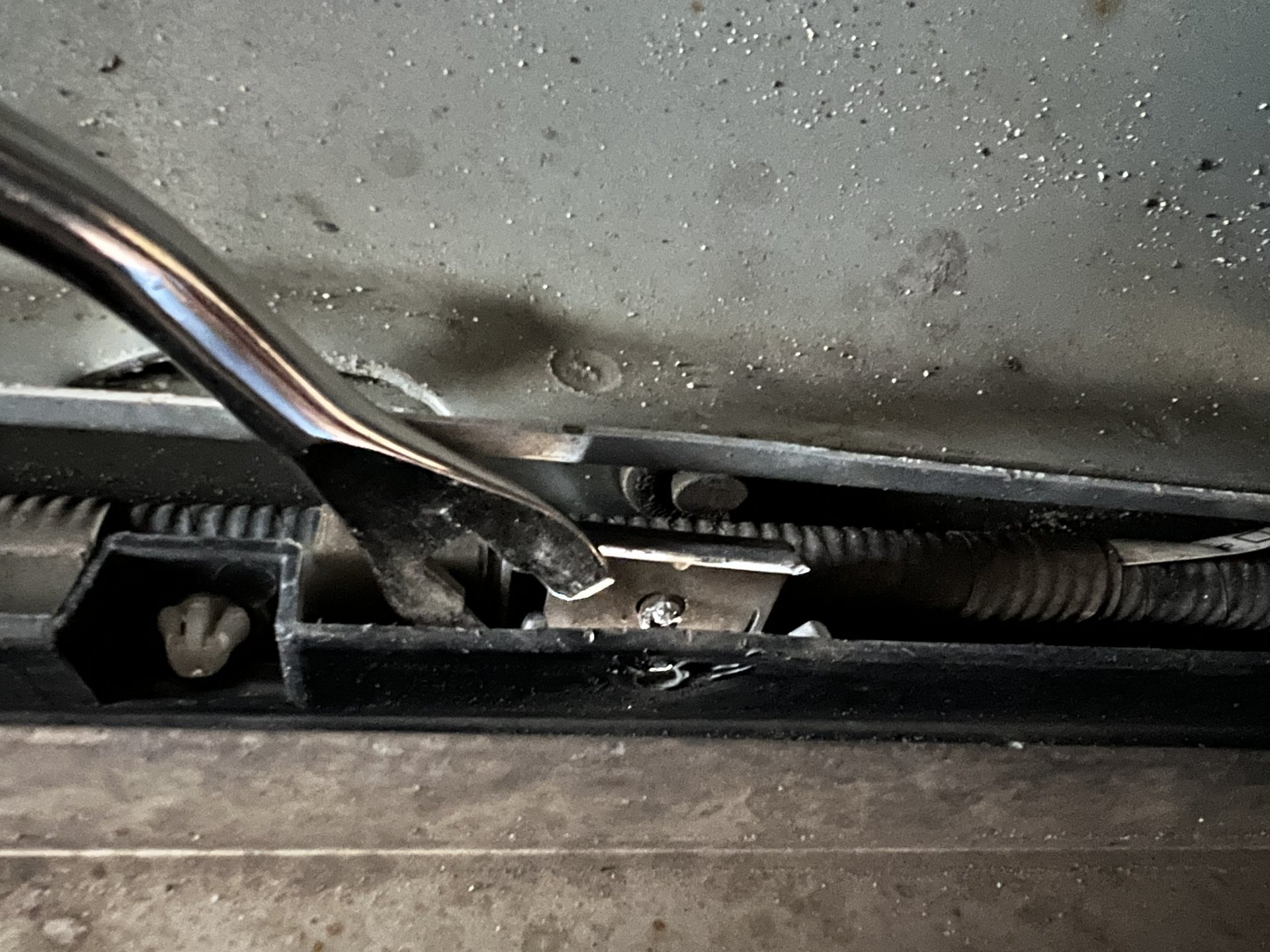

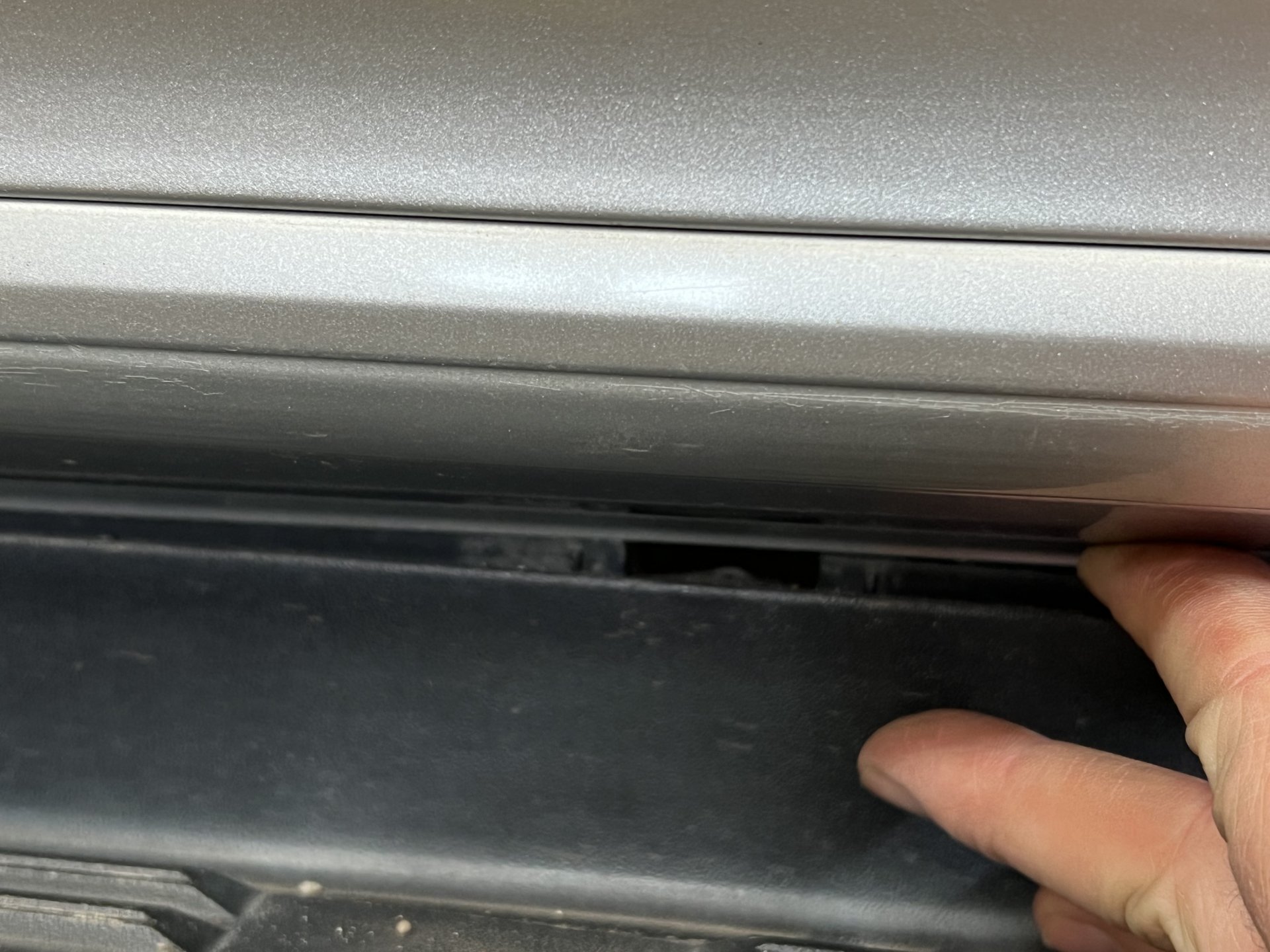

I was able to cut the rivets with side cutters and then pry the two pieces apart:
There are 8 rivers per side, including one underneath (or above I guess) the electrical connector:
At this point you can rough cut the shroud at the front and rear ends, unbolt the step brackets from the rocker, and remove the running board.

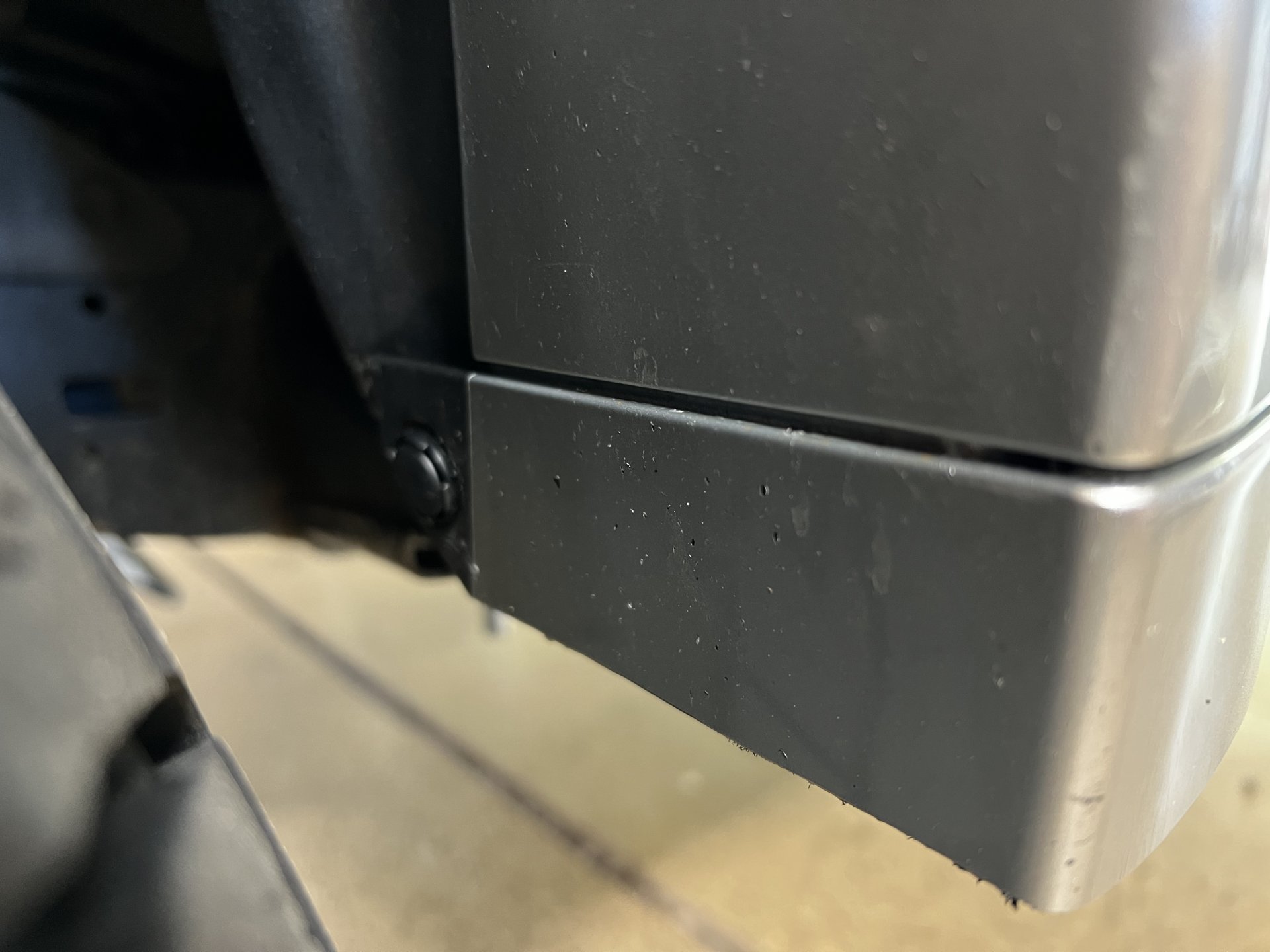

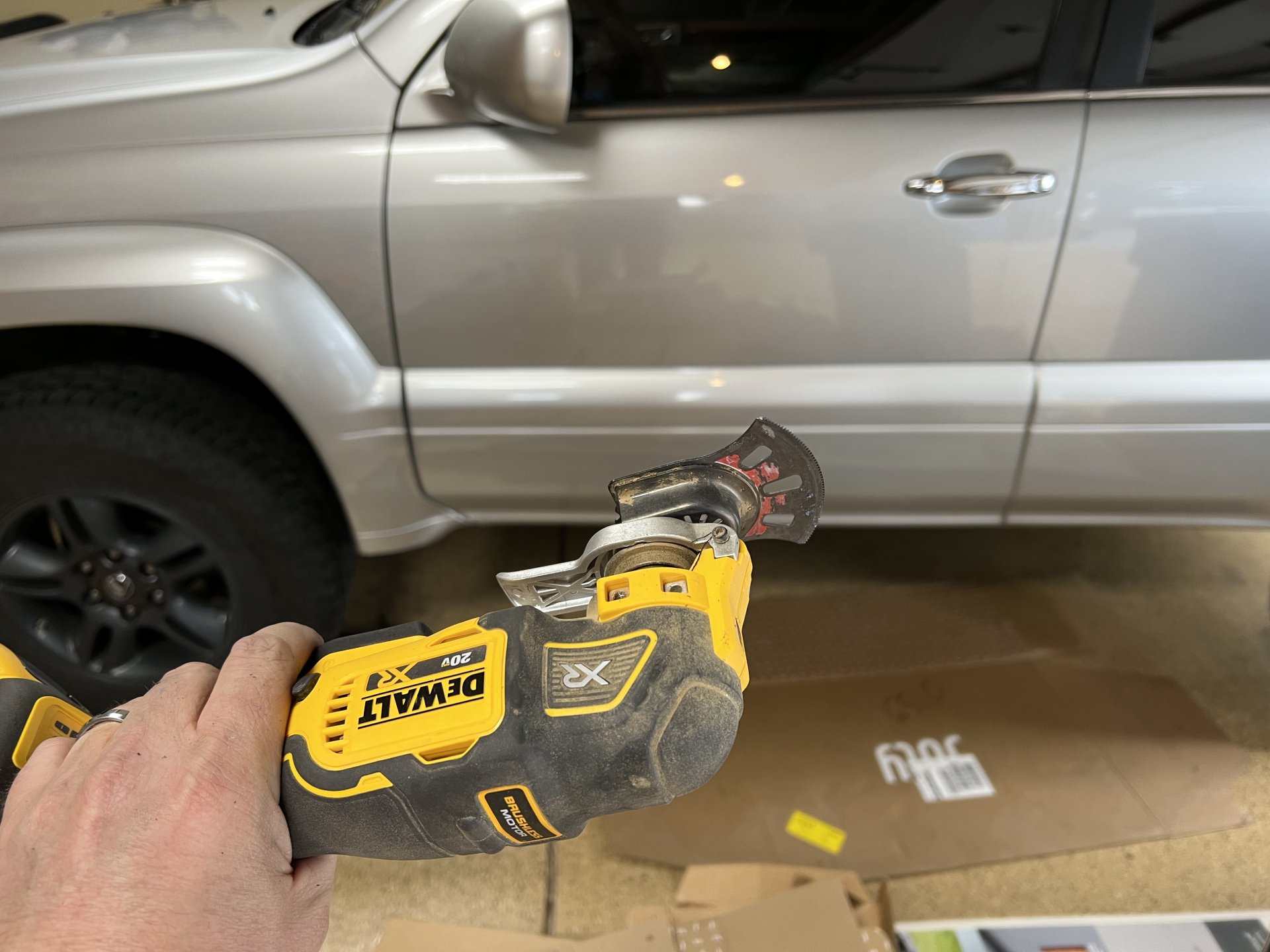

Now you can do the final cuts leaving however much trim you want. I followed the existing opening around to the front which was 46mm below the body line. I find that a multi tool with a fine blade works the best for clean cuts in plastic trim.

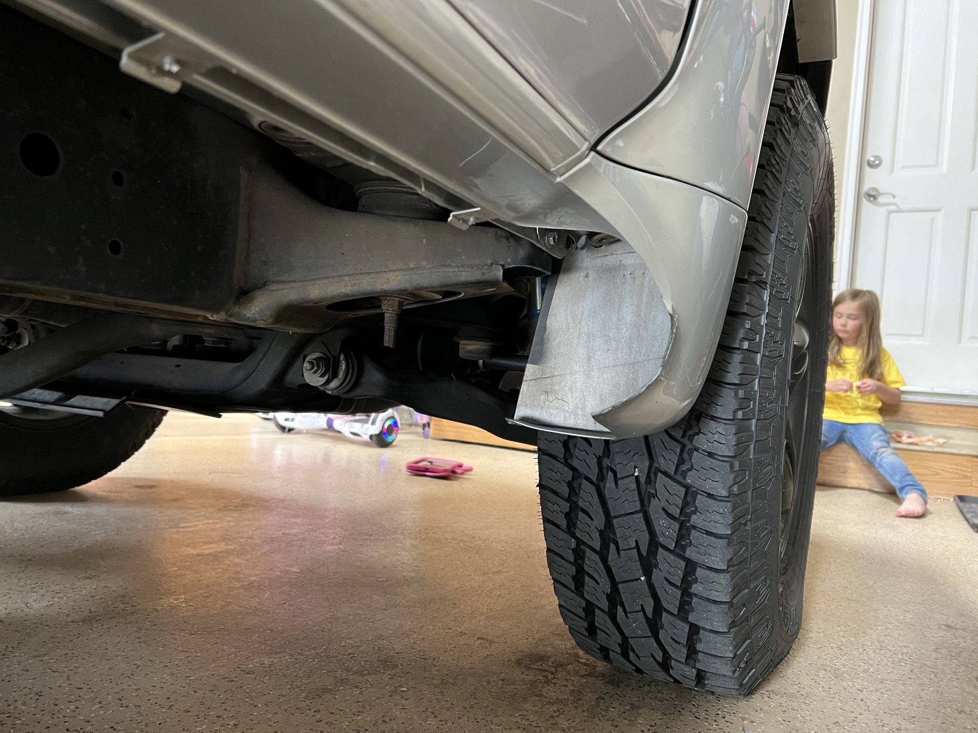

I cut the rear close to flush
Then removed the 8 tabs that had the rivets to clean up the bottom edge.

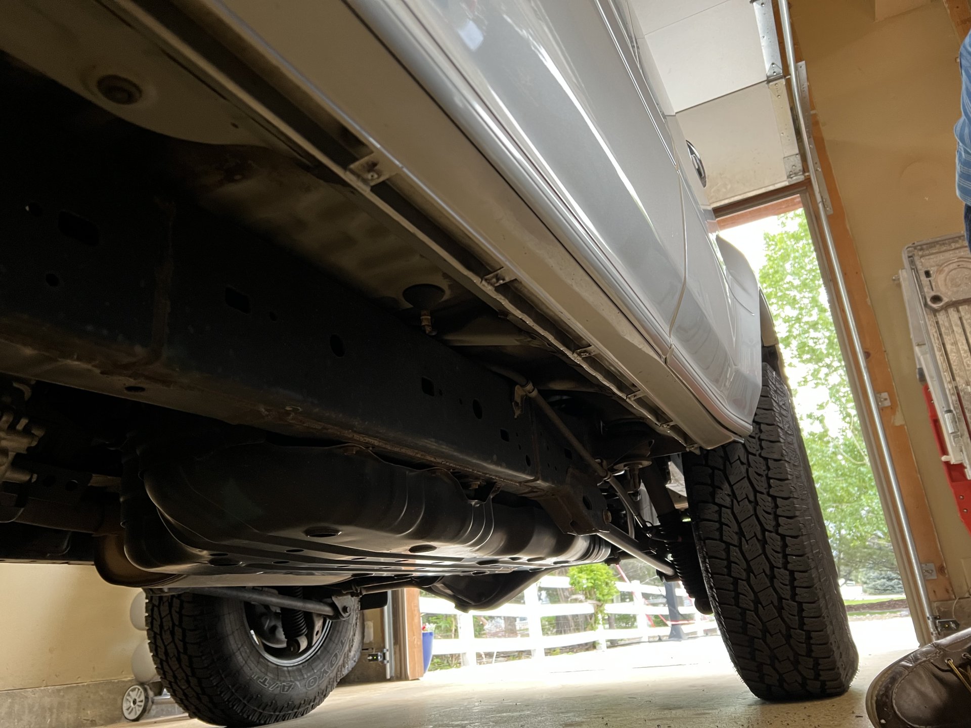

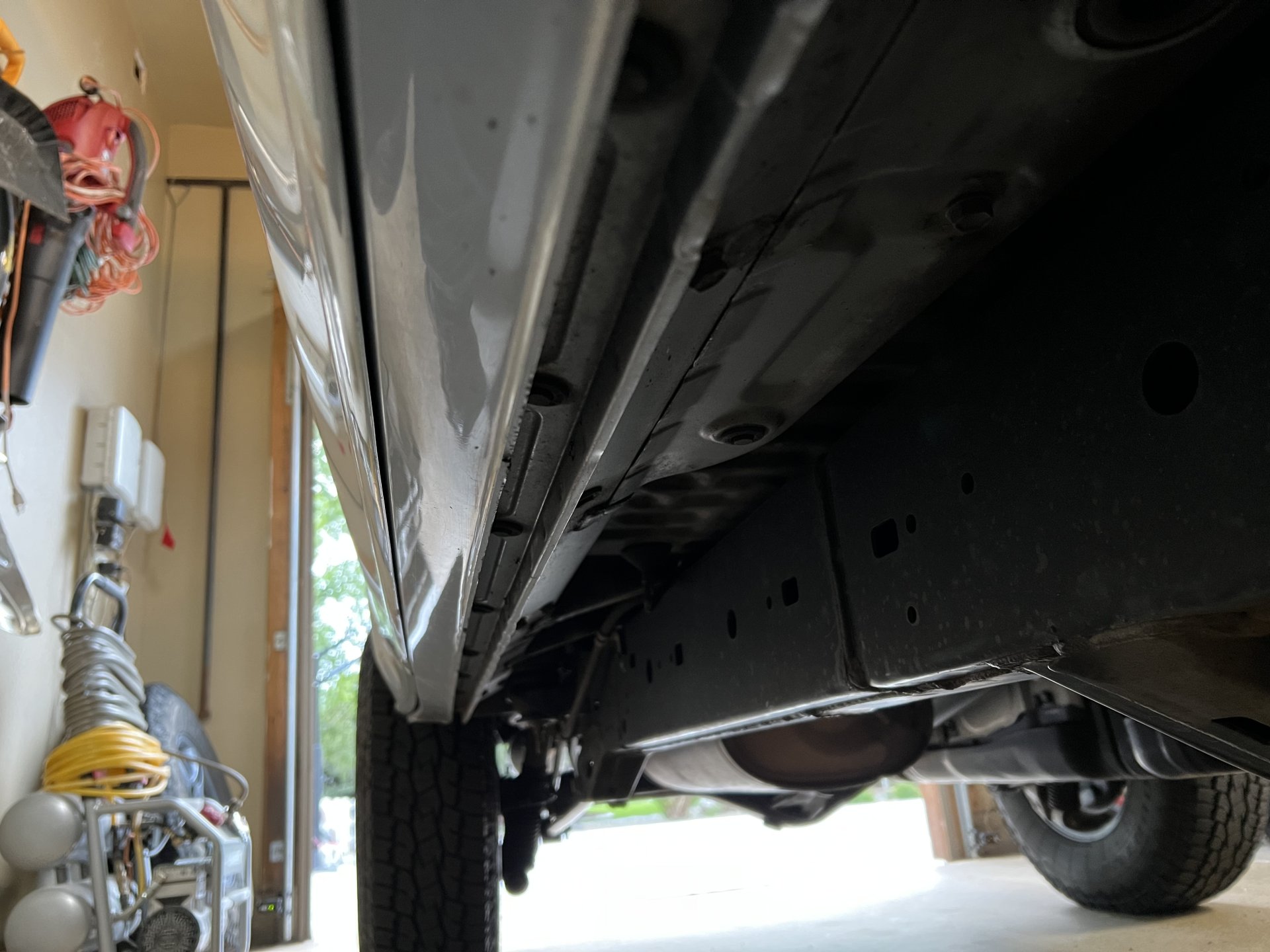

Finished product

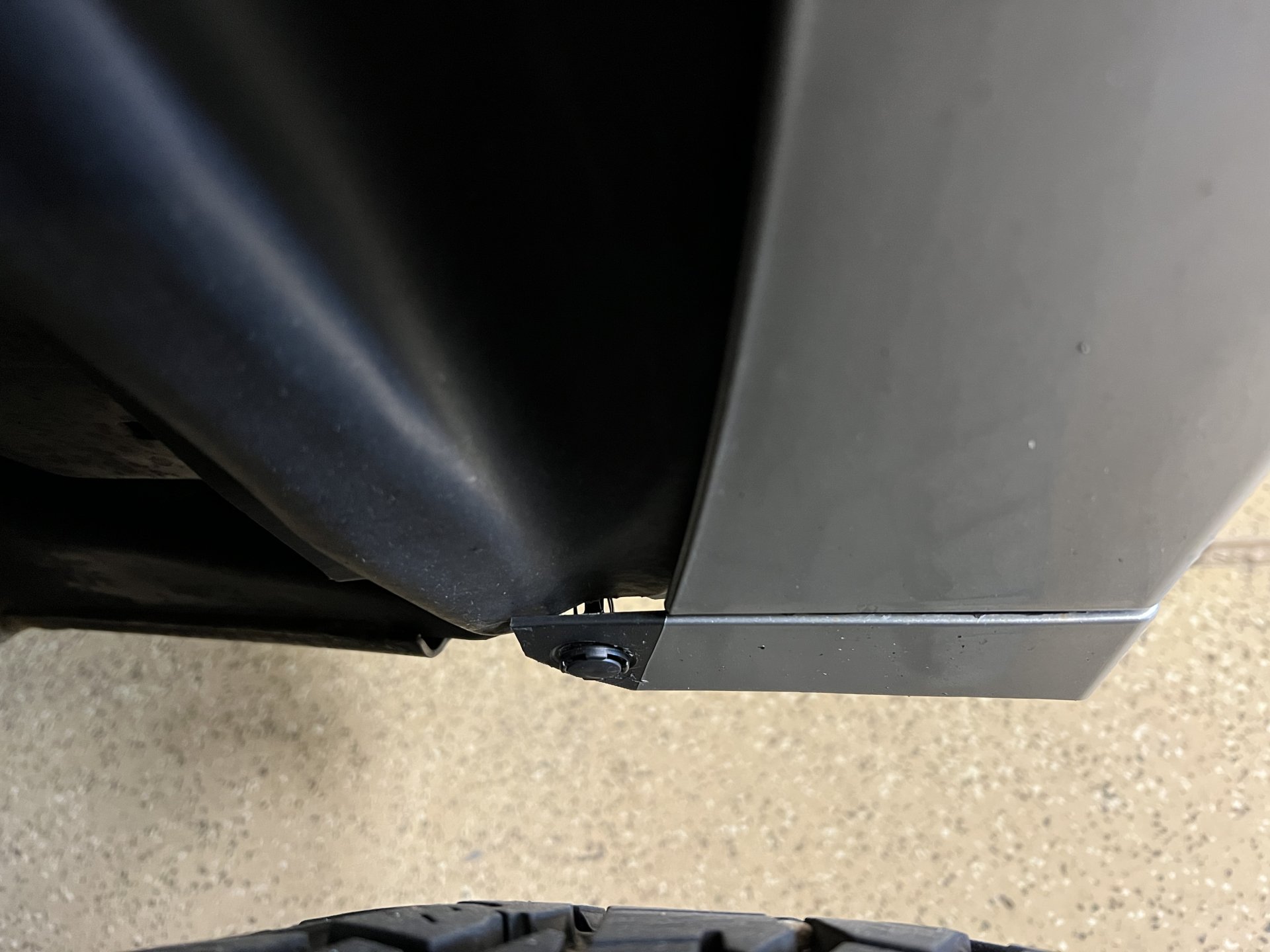

Never mind, looks like you cut above the bolt hole no?

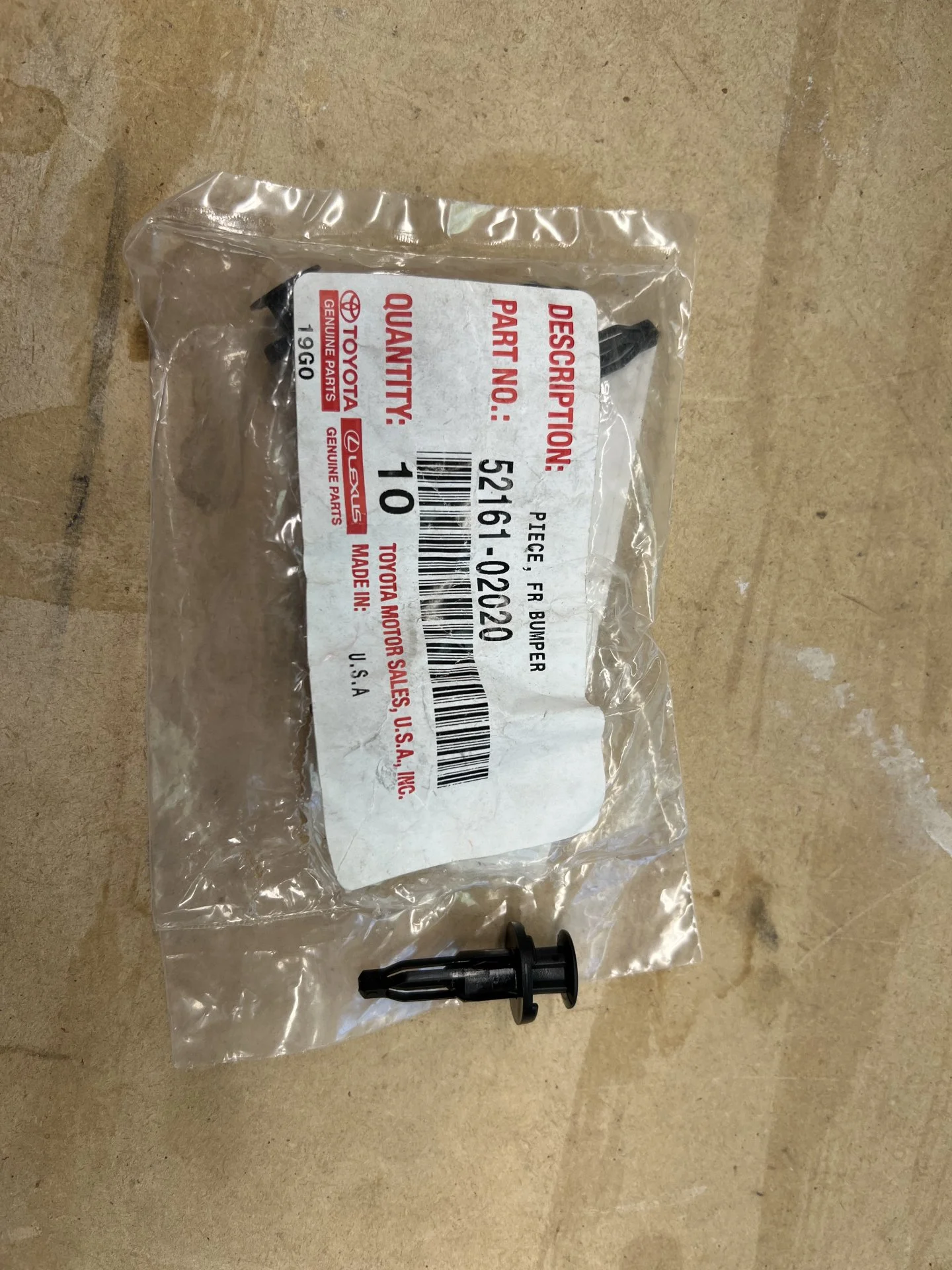

My problem is my tires rub on the front bolt in the wheel well. Any ideas on a replacement bolt that sits flush? Should I use a flush fitting push clip? Or should I double sided tape that mofo?
@GrizzlyClint is this the bolt you’re referring to? At the rear of the front wheel well.
I trimmed back a bit to remove more material but leave the fastener in place. I think I will trim a bit more at some point. My tire gets pretty close to this but doesn’t rub during street driving. I am sure it will be an issue off-road.
FYI it isn’t a bolt but a push pin
