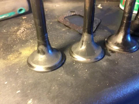

Valves look to have some decent wear on them where they were hitting the seats.. Ill clean the up as best I can and do some reading on back cutting to free up more area for air to flow
