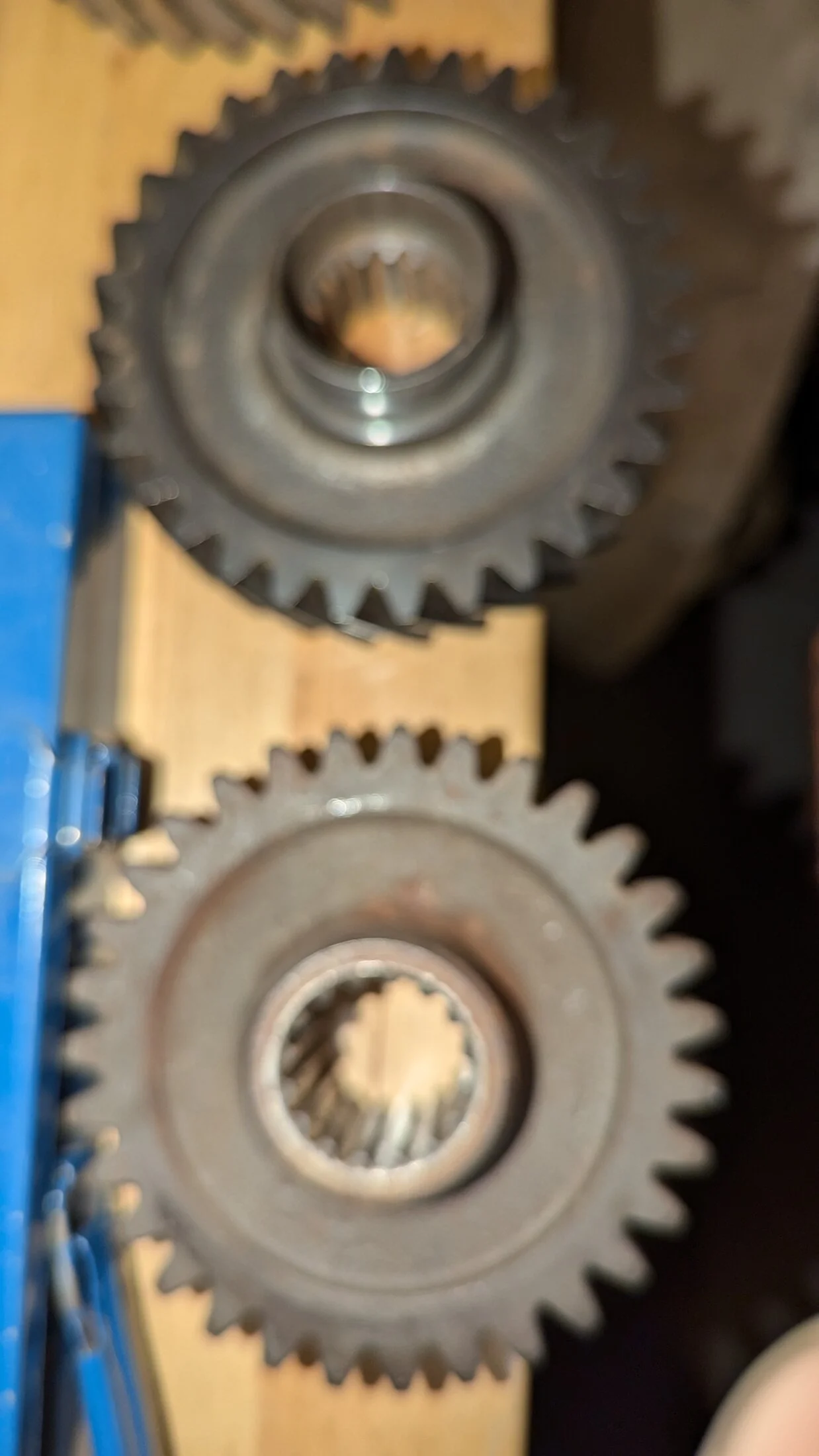

I have three of the four gears you sell loose. Assume the fourth is ten spline thirty one teeth gear used on the later three speed after 4/75?
I seriously doubt you would have any demand for the ten spline gear since those do not wear like sixteen spline shafts. They usually snap first.
Sixteen spline well known for spline where. Unlike ten spline PTO gears that were in all three speeds with this transfer case the sixteen mainly had a spacer instead of a PTO in the US market. But I do see a judge advantage welding the two gears together. The PTO is thicker and unlike the input gear it fully splined. Input gear is not only not splined where it goes thru the front where the seal is it overall thinner. The PTO gear is fully splined. So instead of twice the spline area it's more likely closer to three times the spline area. I haven't actually measured that.
We stock a 10-Spline in 29 & 31 tooth as well as a 16-spline in 29 & 31 tooth
