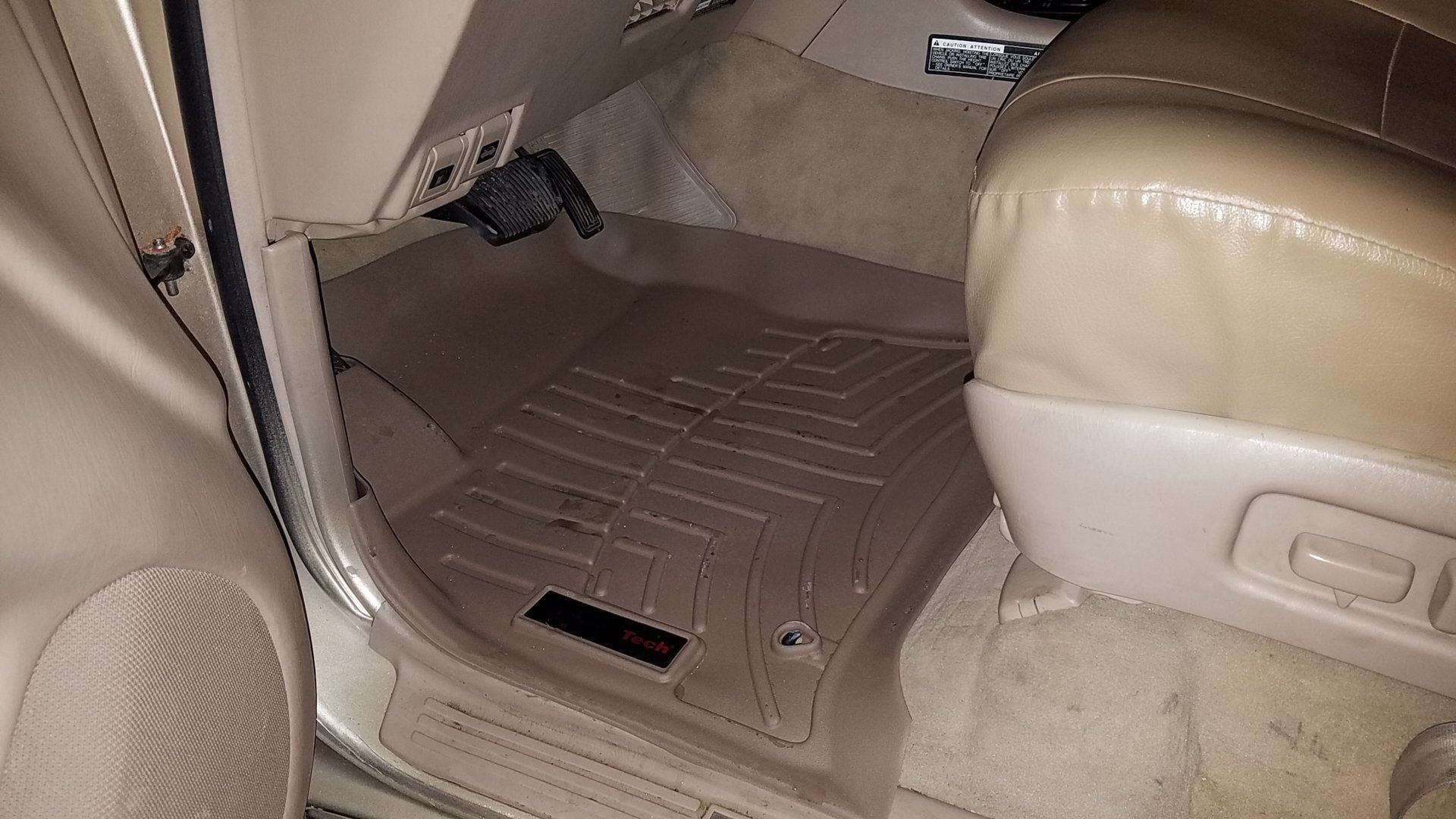

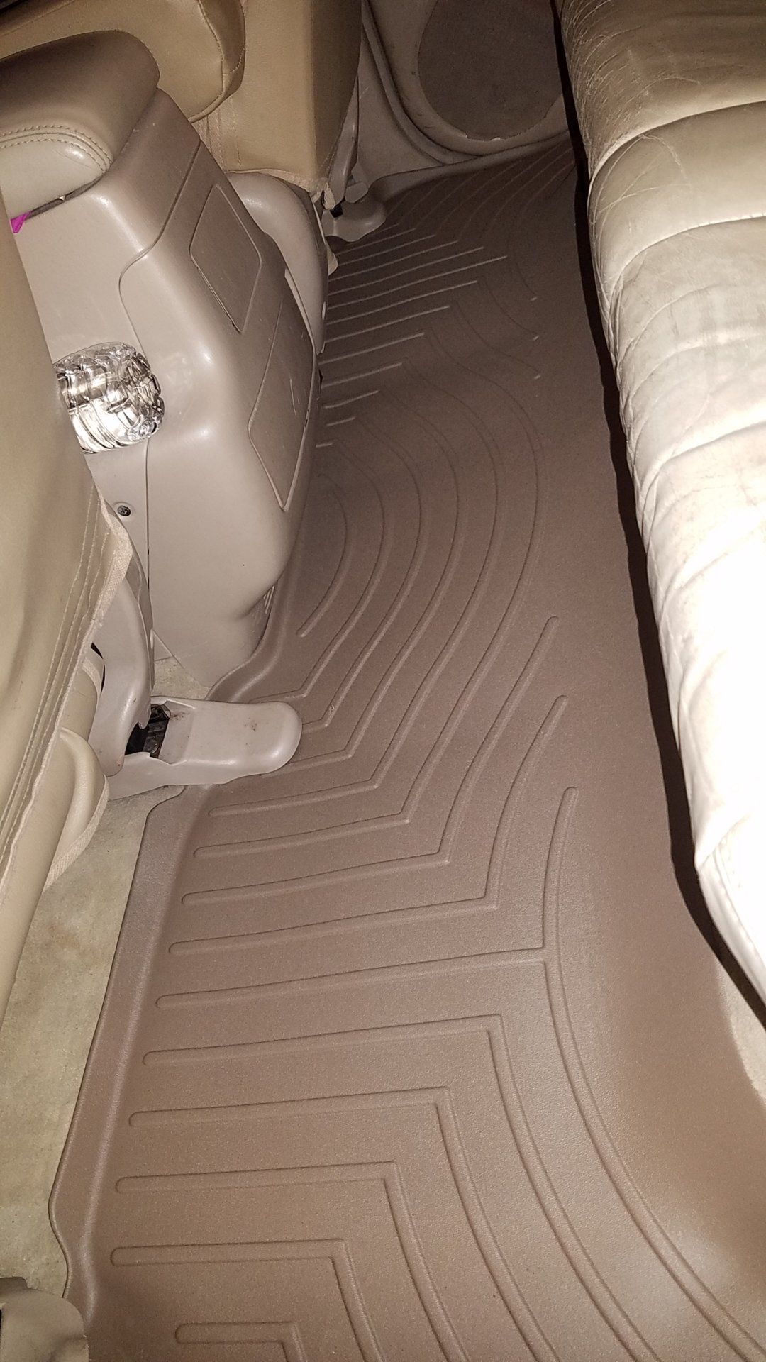

Interested in seeing some pics of those weathertech liners when you get them in. I've been debating since the reviews are super hit and miss for the 100 series.
Just installed the floor liners. They fit really well (just like they do on my BMW and Sienna). See pics below. I will post an update after a while to see how they hold up with three kids using them everyday
