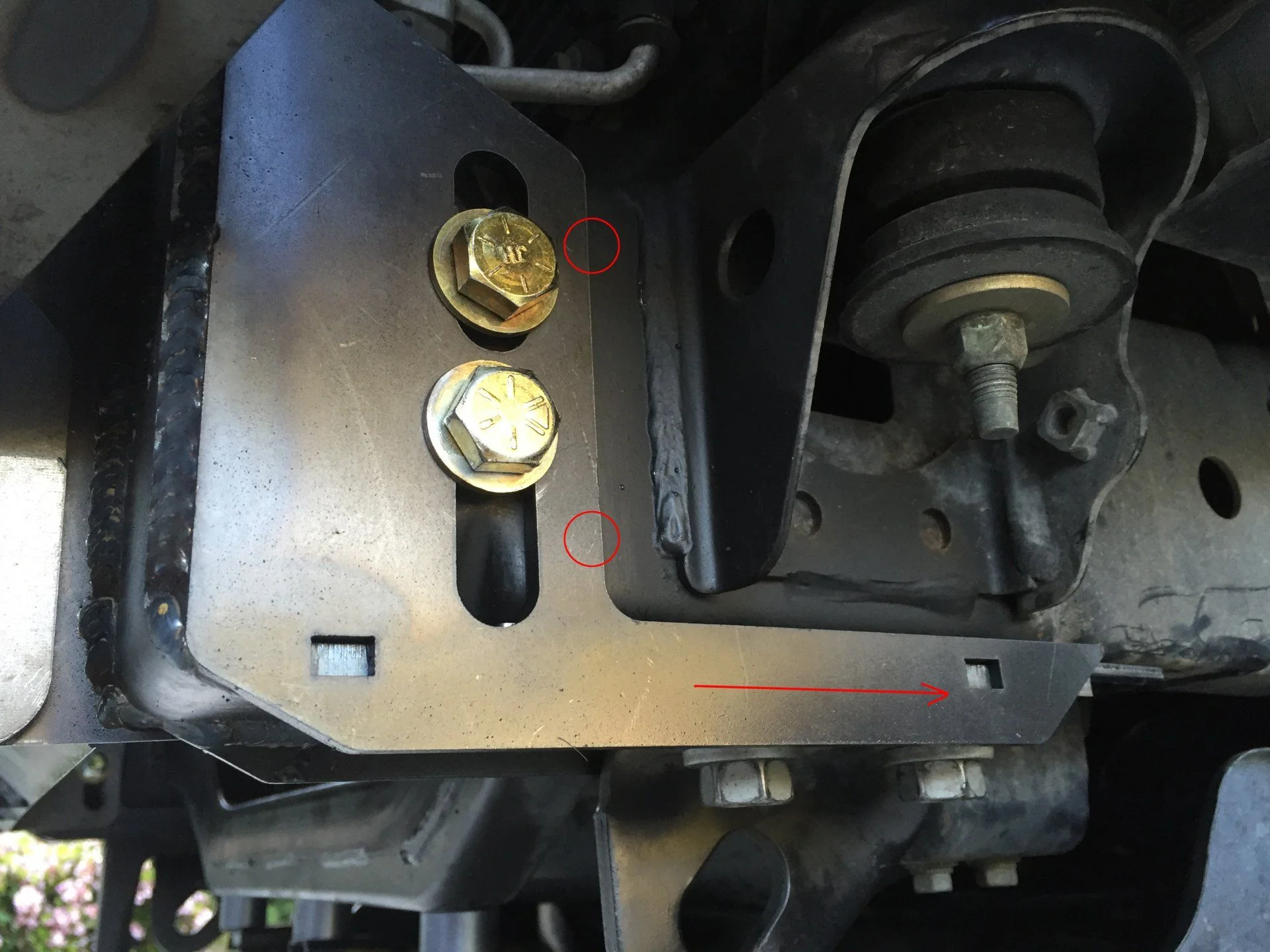

Looks good!
I'm not sure if you already have the frame holes drilled or not but it looks like the bumper needs to slide back, there are 2 factory frame holes and the bumper is not designed to mount with those. The bumper bracket should mount right up against the body mount weld. The factory holes will work but you will get a tighter and stronger fit I you drill new ones all together.

@benc Ya, I was thinking that the bumper was sticking out a bit far. I might have to give you a call because I was looking at how my friend mounted it and didn't see a way to push it back. I'll have to re-drill those mounting holes. My friend used the pre-existing holes when mounting the center part.

Feel free to give me a call, if you don't have my number pm me.

@benc After your comment, I looked at how it was mounted and saw that I could drill the frame further back and then slide the whole thing back. Would that be correct to get it to sit back properly?

Yes that is correct, remove the two thought bolts, loosen the bottom bolts and slide it around to where it best aigns with the body. Then Mark and drill the holes. You will also want to weld the alignment tabs to help with rust.

Re-drilled my front mounting holes for my bumper

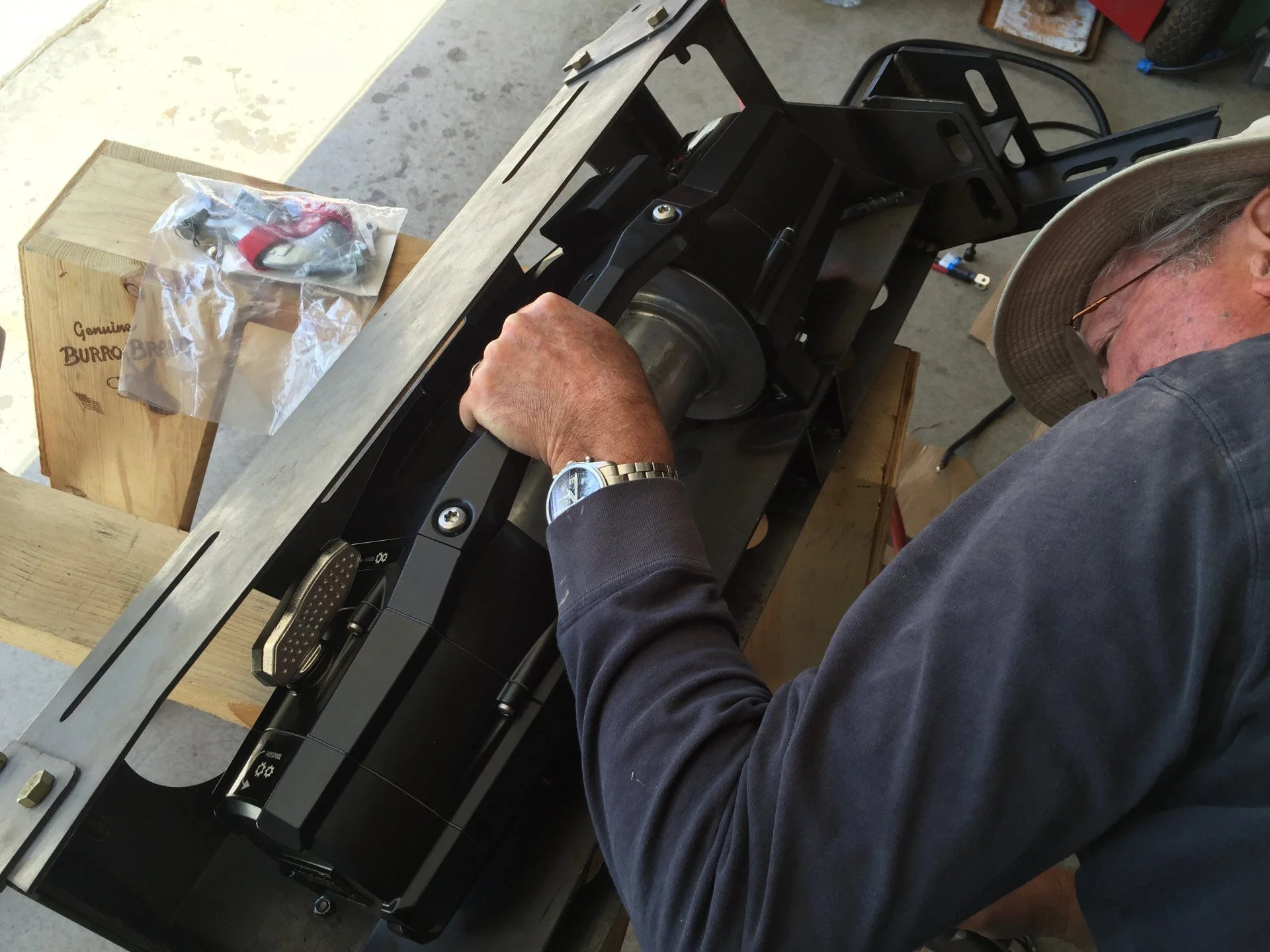

Made sure that my Warn winch (Zeon 10-S) fit inside the Dissent bumper. Dad assisted
full
Fits perfectly

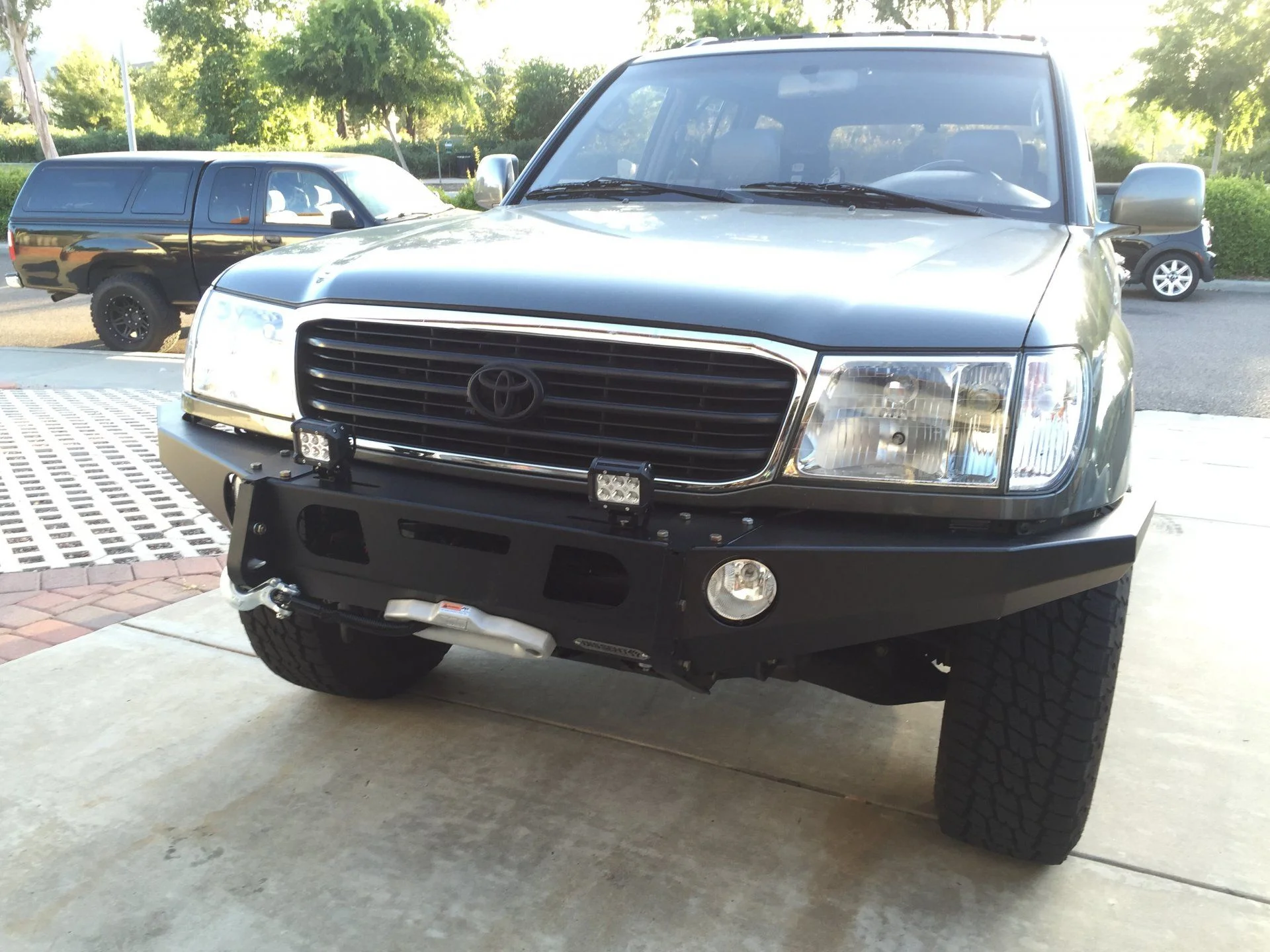

So I finally found time to get my bumper installed on the truck. Driving around with no front bumper for 3 weeks gets old. I decided to go with a slight crinkle black. My dad helped me relocate the control pack for my Warn 10-S Zeon winch. We found a good spot for it in front of the airbox and behind the passenger side headlight. Working on it all day, we finally was able to get it shimmed just right so it was level on both sides as well as get lights wired, etc... The whole install took a lot longer than I thought but I'm pretty stoked on how it all turned out. I'm not sure if I'm going to leave those cheap LED lights on top of the bumper. I just put them on there to see if they help any when using my fog lamps.

Looks good!
It's hard to tell on my phone but looks like there is a decent size gap between the caps and top plate? you may be able to use a rubber mallet to bend the top plate down, you may also be able to loosen the cap bolts and push the cap up a bit.
@benc You're right. I'll try bending down those top plates down. I can't push the caps anymore though. The passenger side cap was so tight we had to use a crowbar and mallet/hammer to get it on.
