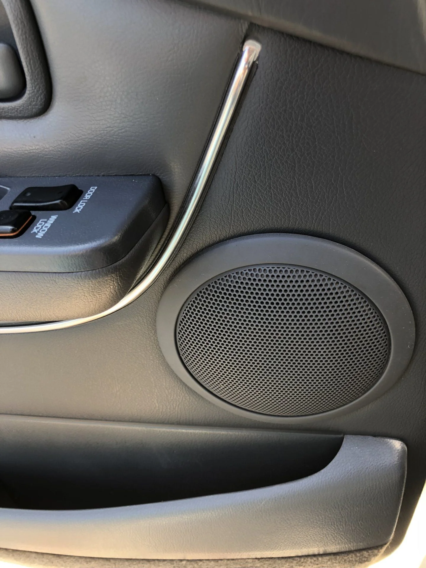

The rear door speakers are smaller than the front door speakers. The factory speakers are kind of sealed or glued into a plastic mounting assembly that also has the anchor points for the grill.
In order to use the 6.5 inch pioneer speakers in the rear doors, I had to mount them directly through the outside of the door cards and use the pioneer grills. I did paint them to match the factory interior and to those who don’t know, they look like they’re factory installed. Although, it’s obvious to everyone on this forum that they’re not. Here’s a pic.
If you want to retain the factory grills. I think you could get smaller speakers to fit inside the plastic factory housing and mod it a bit to work. Pry the rear grill off and you’ll see what I mean. I wanted larger speakers, so I opted to use the pioneer grills.
Question.... did u pull off the back door panel first then the grills?....or can u pop grill off without pulling rear door panels?
and you said you just mounted the 6 1/2" TS-G1645R and bolted speakers on outside of rear door panel?
Thanks, just trying to wrap my head around this ;)
The rear grills pop off without removing the door cards. Just pry them off, you can’t hurt them. Yes, to your second question.
