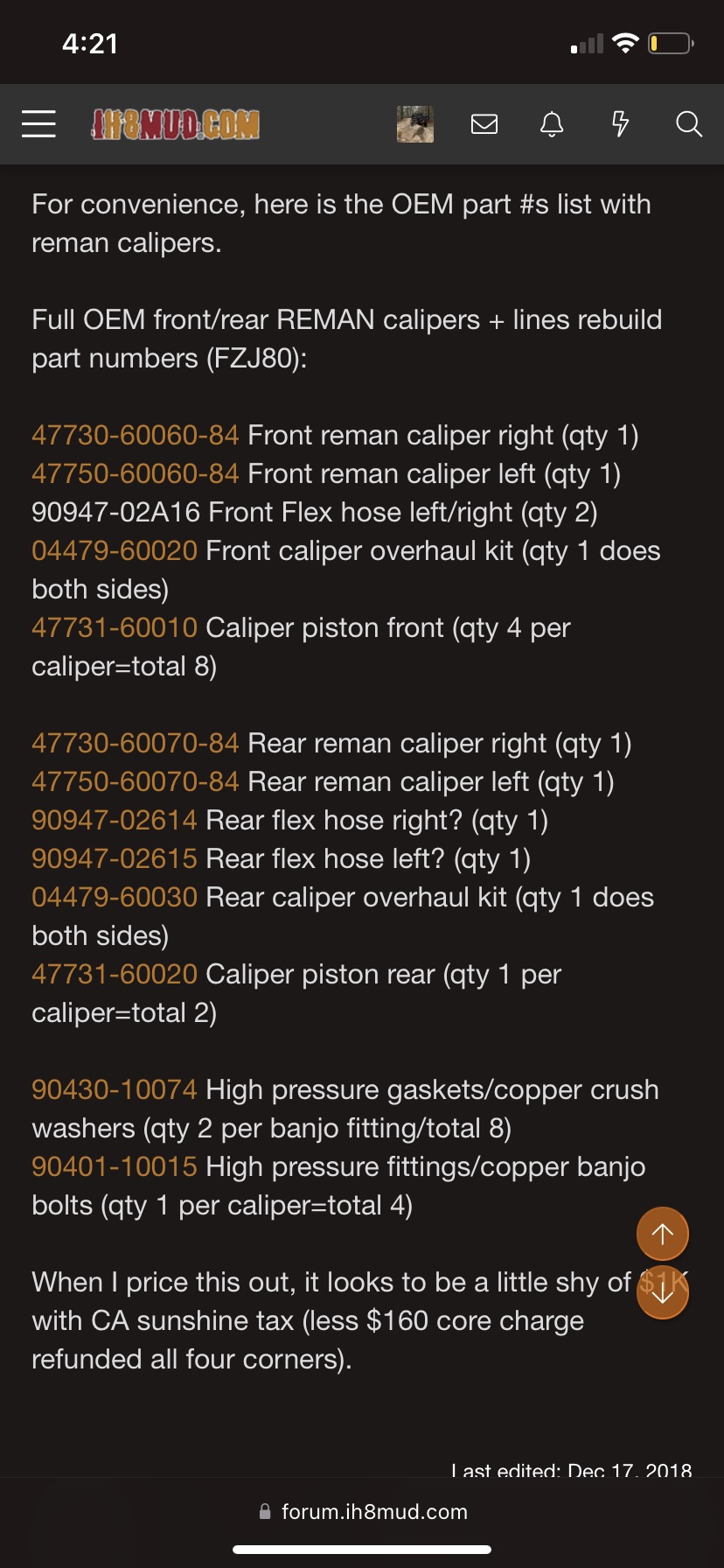

Front or rear? New and reman are available at the dealer or favorite vendor. At least for rear, picked some up today.
Front remans are known avail. New front I cant say for certain.
