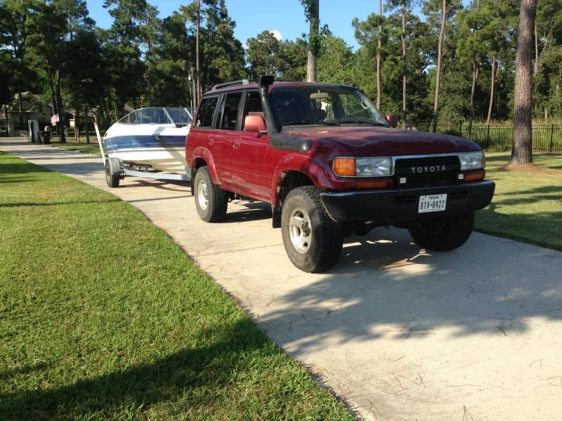

Ive got a 92with a 3fe and have towed a20' bayliner & a 22' mastercraft. Slow? Yes. Once you get up to speed youre good though. The bayliner didnt have trailer brakes & she stopped just fine. Mastercraft has a single axle trailer with tongu activated brake. Stopped just fine.
Important note: both towed @ sea level. No hills around the gulf coast!
Here the bay liner. Barely noticed it was back there - nearly 25 mile tow.
I have 2.5 lift & 33's but the anemic 3fe did just fine. Honestly? I couldn't tell either boat was back there.

EXACTLY what I needed to read and see. Thx man! I did pick up a 92 so this is relevant.
If you know the gross tow weight of those two setups, that would be helpful.
The Bayliner/trailer combo comes in between 2700 and 3000 pounds.
The Mastercraft/trailer combo is a pig @ 4,400 plus the additional weight we've put on the boat for extra wake so I'm guessing another 400-600#.
I have 33's and stock gears as well, to give you a good comparison. I def feel the truck is anemic & honestly on flat ground she wasn't much slower with either boat in tow. I can only speak for my experiences @ sea level and no hills.
Experiences in high altitude with mountain passes would be completely different. In that case, I'd find a buddy with a diesel.
