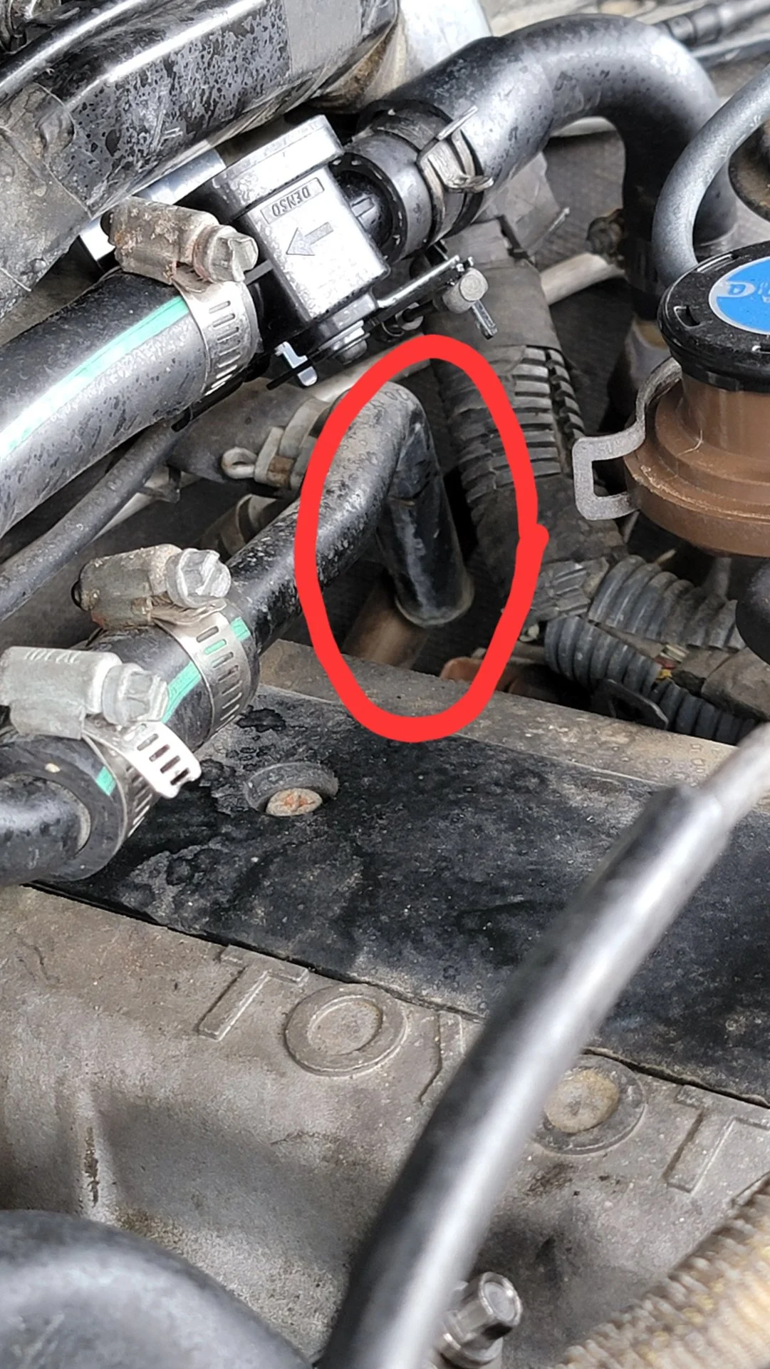

Went all in on changing hoses, heater, valve cooling system flush etc. Saw this open ended connection today doing th4 stuff along the firewall. Looked at the coolant flow diagram from joey@witsend and couldn't see if it's supposed to connect or if it's an over pressurization valve of some kind. Any help is appreciated. Just want to make sure I haven't pulled something off and when I fill up with coolant and start it I don't have a short lived coolant fountain.
It's a blind end with a cap soldered in place, it doesn't go anywhere. There are two side pipes soldered to the down pipe that face the firewall. Top pipe goes back toward the firewall for the main heater pipe that comes through the wall. The bottom pipe is 1/2" for the rear heater pipe connection on that side.
For 80 series that didn't come from the factory with a rear heater there's a similar pipe assembly but with only the top 1/2" side pipe, AFAIK. FWIW

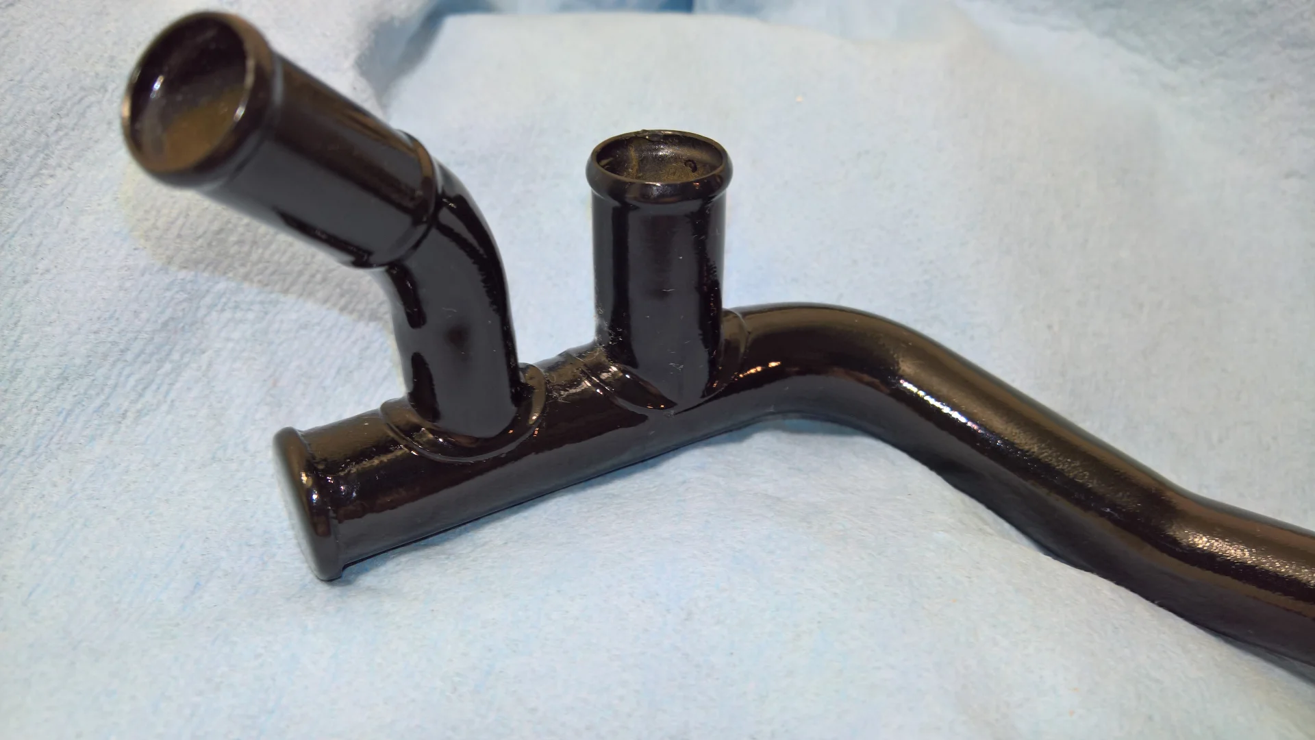

Photos below from a US spec FZJ80 which had the rear heater circuit:
