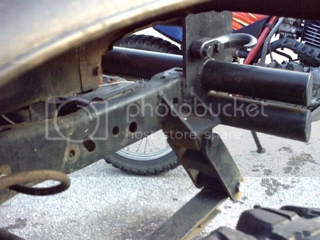

Absolutely there are some other concerns - you will have to measure where the spring perches are in relation to your frame. If the axle is too wide then you may need to do outboard spring hangers to match the FJ40's locations.
Something like this:
I'm not a big fan of outboard hangers, but you could maybe get around that by cutting the housing down but that takes a lot of work and a lot of precise measuring.
Trust me - it can be done. But a SAS is already hard enough to begin with and starting off with the wrong axle is just going to make it 10x harder. Just sell the 40 axle and get the right one for the job.
Just my .02.
Good luck & nice rig!
