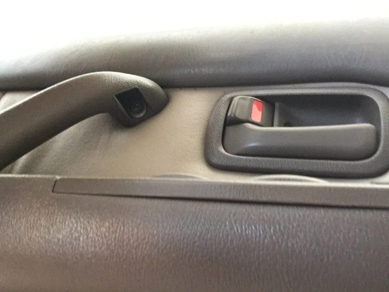

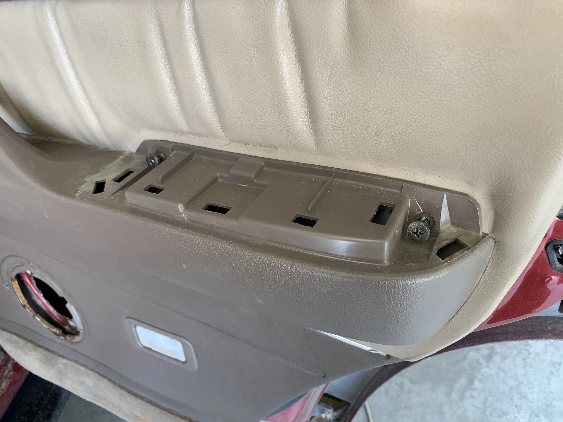

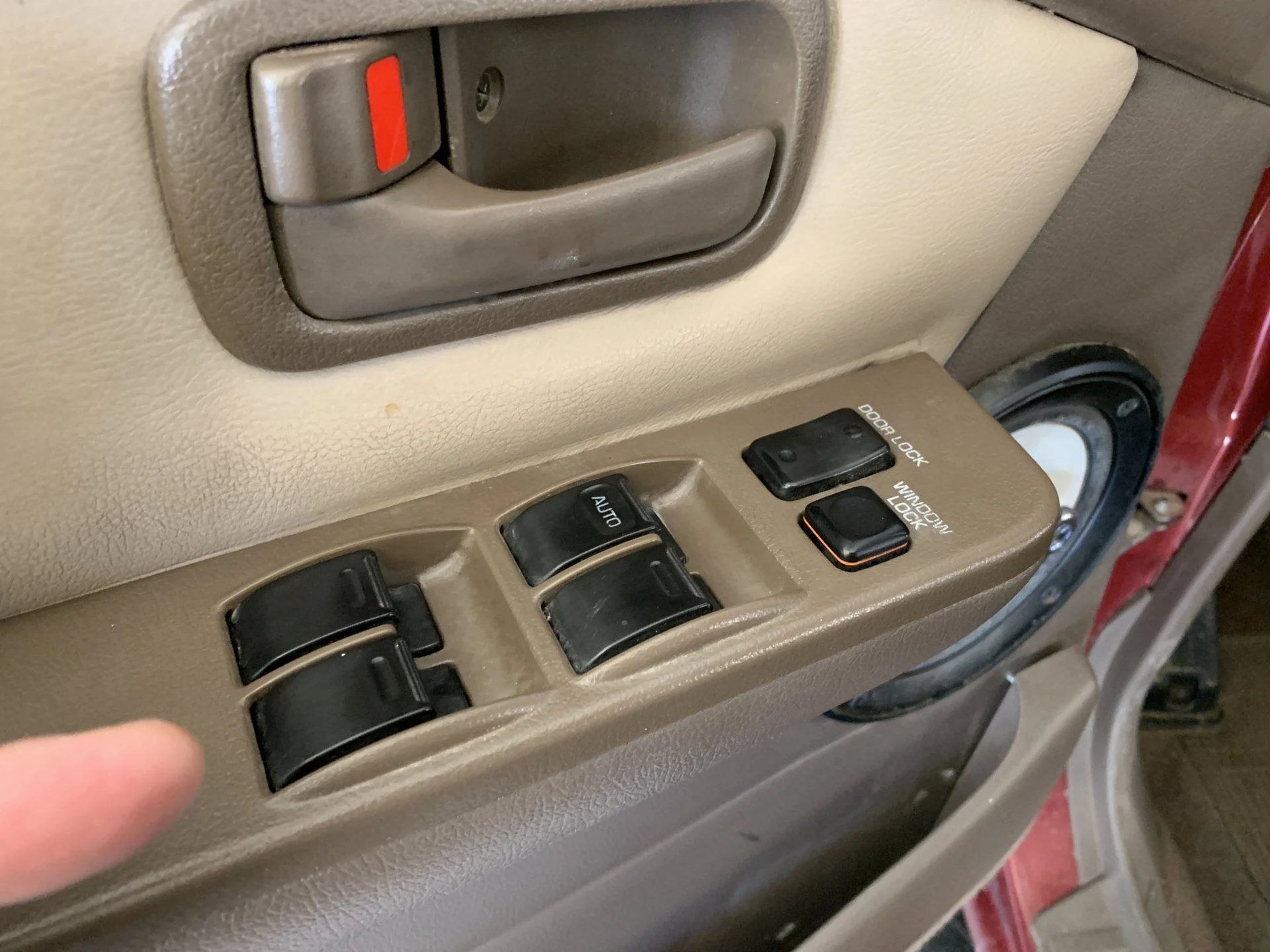

Trying to remove my door panel/s to replace the window run channels and fix a couple screws loosened from wheeling. Does the window control panel slide forward then up for release? Don’t want to break anything underneath I can’t see. Tia

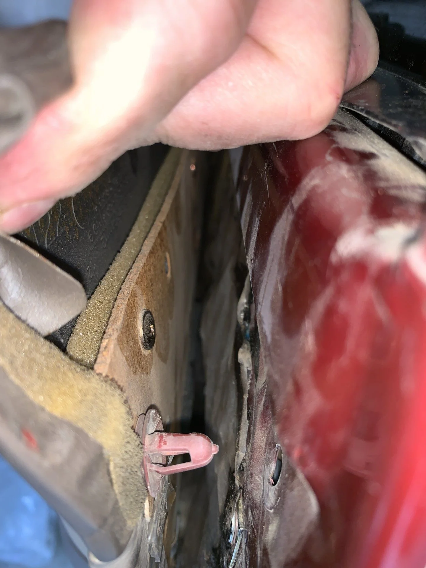

What am I missing to getting the door panel off? I can get the edges loose and am stuck somewhere in the mid panel. Don’t want to pry it and break it. Tia
There are large screws you have to remove as well as unhook the door lights. One of the screws near the inner release handle and one or two under the arm rest. It pops up.
