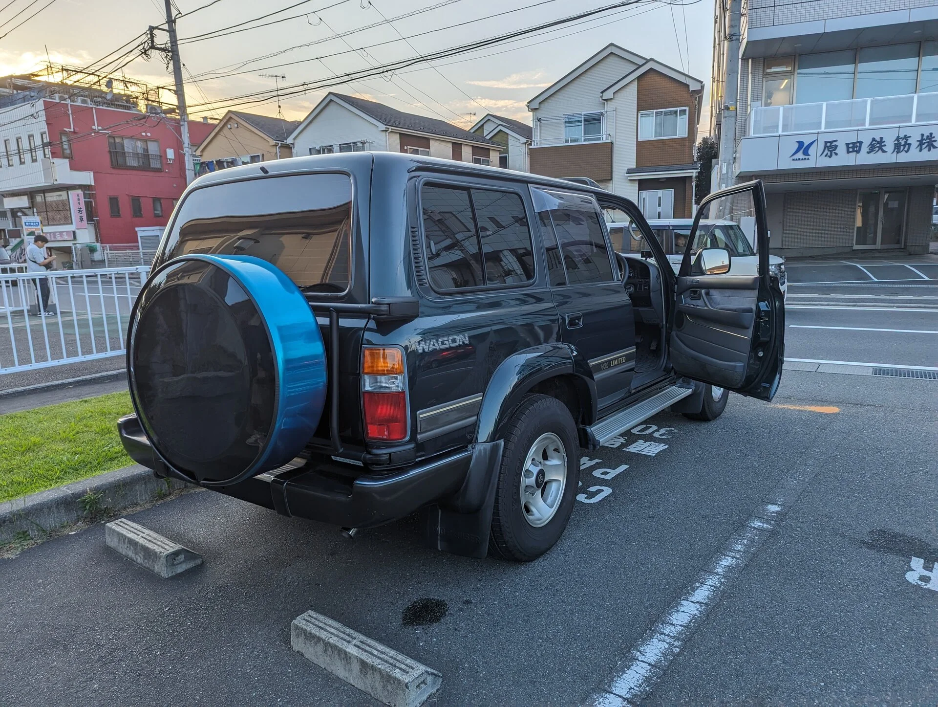

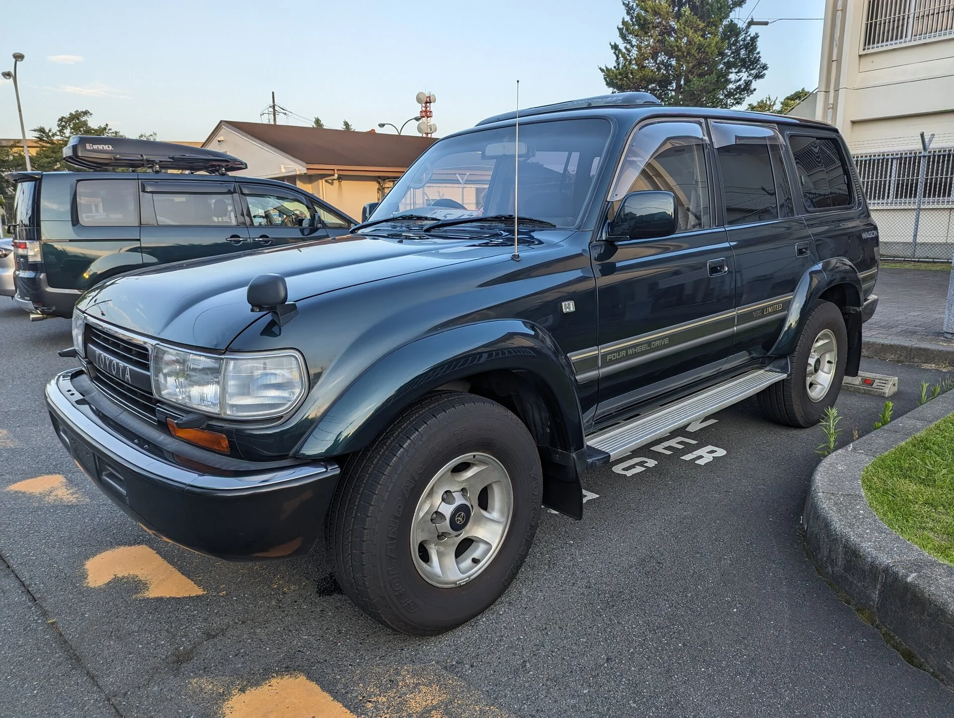

Making my way from Japan to Oahu, and picked up a stray to bring with me. FZJ81 VX Limited with 78,000 miles (125,000km). Very stock, with an aftermarket locker. Front/rear a/c systems and center console cooler worked when it left Japan. Rust is minimal, although the exhaust was looking a bit dodgy so I had the shop I purchased it through throw a stainless exhaust on her while she was still in Japan and parts were plentiful (and cheap-ish). I also asked them to spray down the undercarriage with fluid film prior to the ocean voyage. I picked her out from the Toyota auto auction, which is an event, and crawled through about a dozen Land Cruisers there before settling on this one.
She arrive in Hawaii next week... I'm looking forward to getting new fluids in her and down a shakedown. I didn't register it on the road in Japan, so she is very new to me. Interior looked very good, but I'm considering pulling out the seats/carpet for a deep clean. The carpet on the JDM Land Cruiser is plush!
The one day I took her on the road in Japan, it was a hot and humid day and I did note condensation on the outside to the rear of the right hand passenger door... the exterior there is cool to the touch with the rear a/c cranked up. Not sure if that's normal.
Looking forward to learning from everyone here!
I also noted the rear window spray was very weak... I'm sure something in the line rotted out awhile ago and needs replacing...

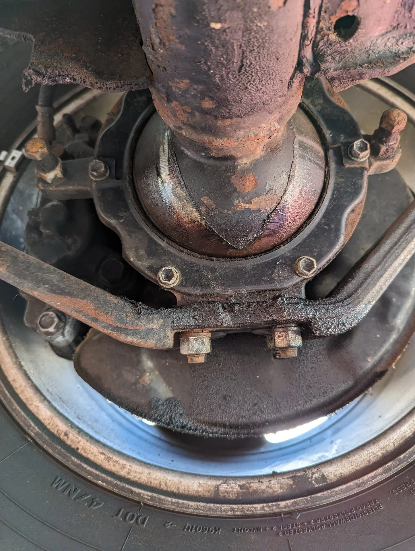

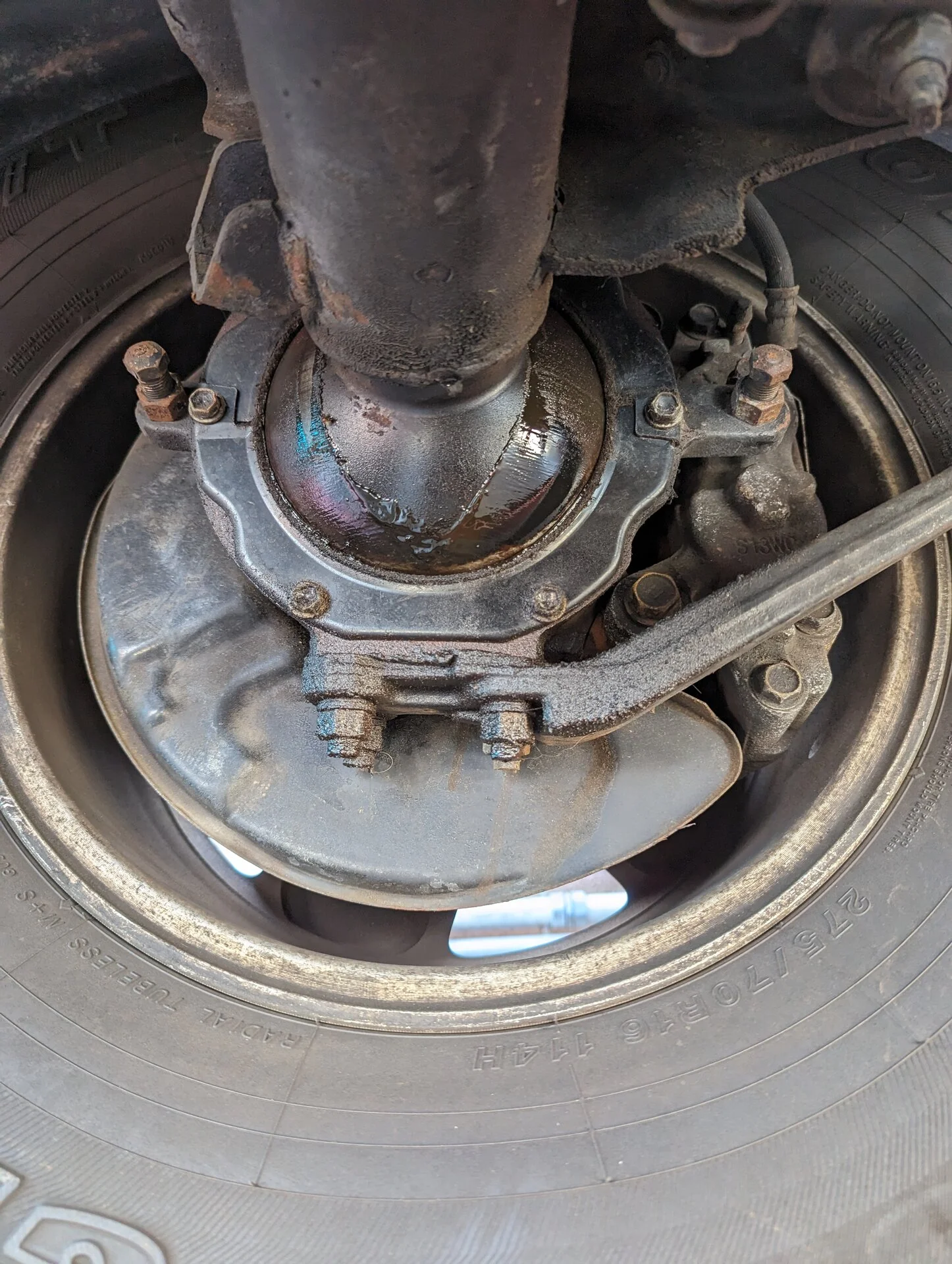

I got a good chance to poke around under the 80 while it was on the lift. I assume these are what weeping knuckles look like... I'll add that to the list...

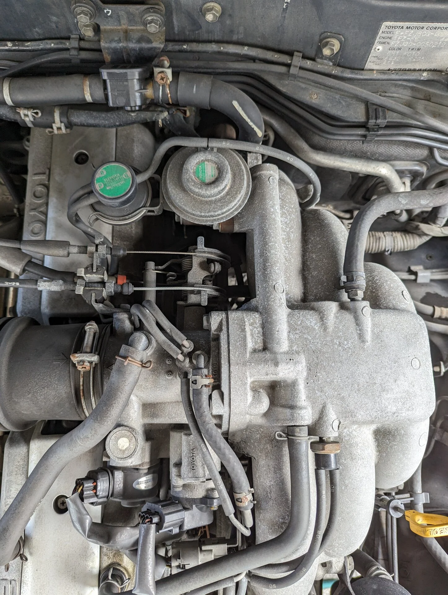

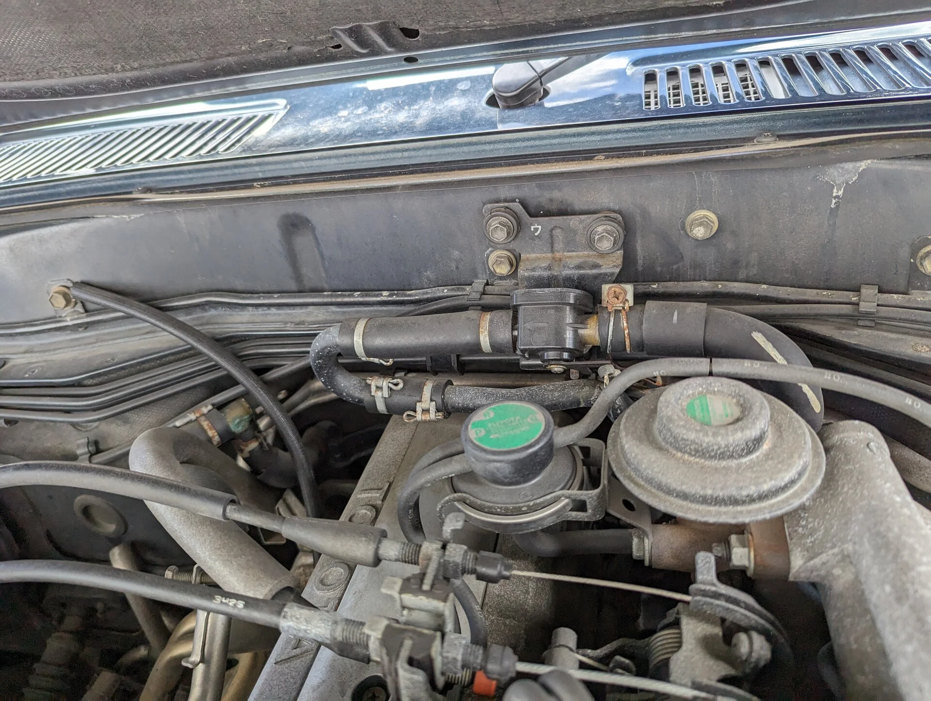

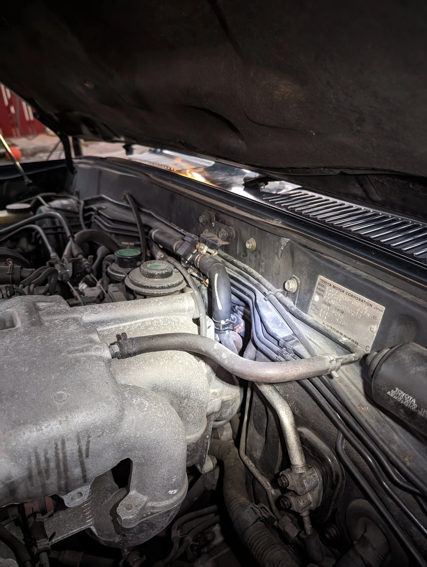

I was also poking around under the hood trying to check the condition of the heater hose. Looks like the repair was made sometime in the past?
And am I correct that I have a different EGR system than North American models? Thinking of doing a delete at some point but I don't see the temp sensor... would I just plug the vacuum lines to the modulator?
Totally agree with @Devils Paw 80 that heater control valve needs to be addressed before anything else. As stated that discoloration is concerning, meaning it is getting brittle and could break soon leaving you stranded.
The knuckles do not look bad, the color of the grease is a little concerning too. Looks like bearing grease not moly grease.

After poking around the a/c system and seeing it hold good refrigerant pressure (at least on the low side), I think the issue is the heater valve was cracked even when a/c was full cold. I adjusted the cable to fully close now. But I did notice weeping coolant when I was poking around. Looks like I'll be replacing coolant hoses in the near future.
A better shot of the heater control valve in question.
