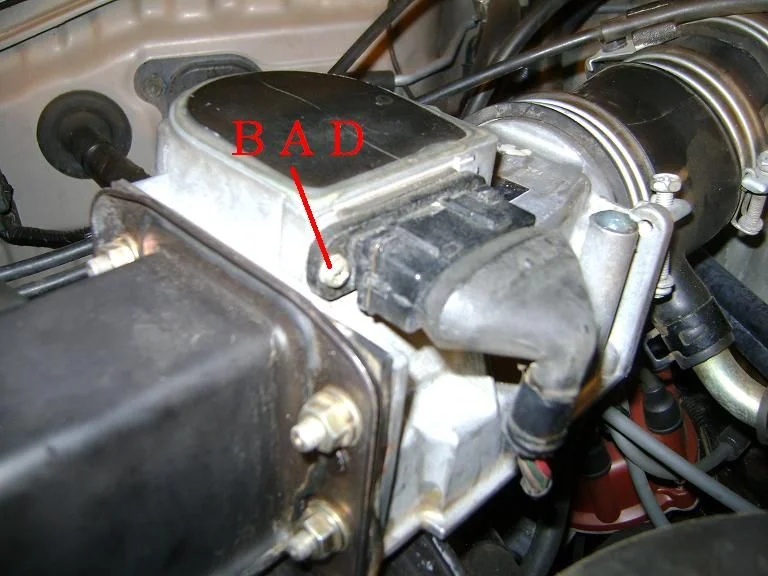

In addition to what Tools R Us said, check the plug that is connected to the Air Flow Meter - it is the metal box (silver in color) that is inline between the air filter and throttle body, on the intake plenum.
This particular plug, when wet, will cause this and very poor performance for a few hours until it is completely dry.
Here is what the meter (VAF) looks like, only this was taken from a '92, but they look very similar. Attached to that is the plug in reference. DO NOT unscrew the plug from the meter housing - you will destroy it that way. Simply remove the metal clip with a blade-tipped screwdriver, then remove only the plug from the receptacle.
