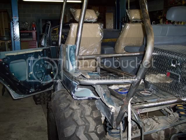

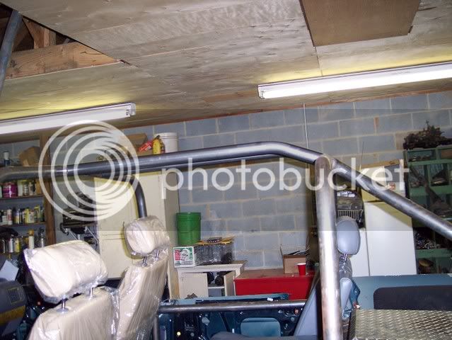

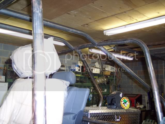

More on the rear cage

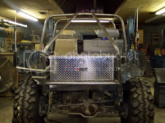

from the back

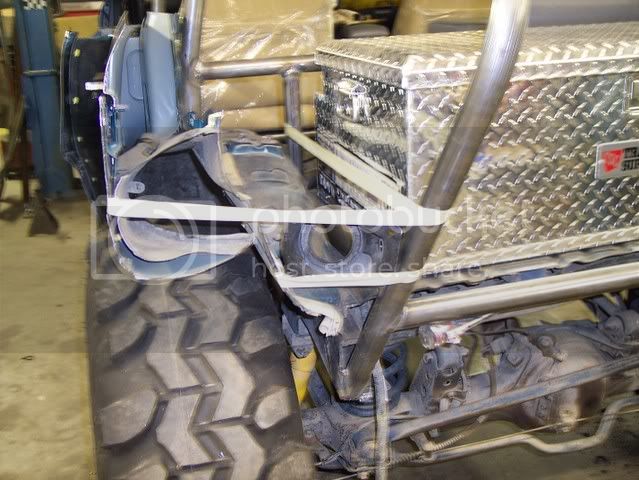

Side

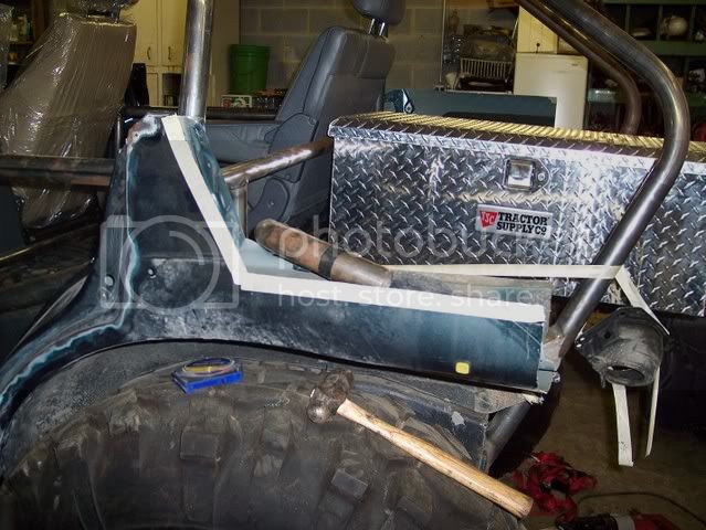

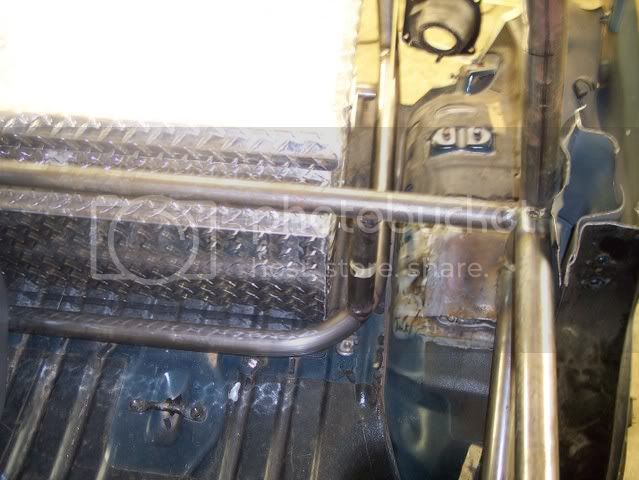

Tape lines for future tube (you can also see where the filler neck will be located)

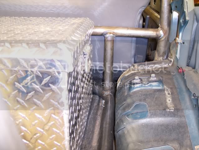

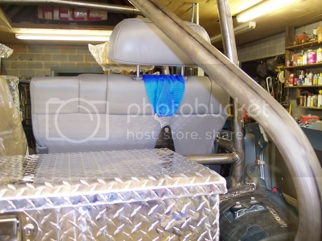

inside looking back(notice how the tube goes around the box)

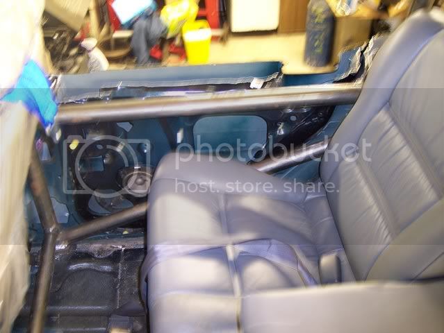

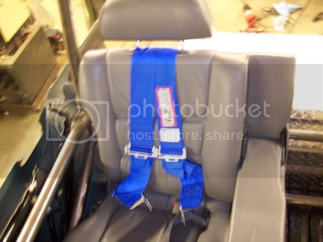

seats are here
guess what is gonna happen?
Thats some fancyness right there. Love the rear bars.
lookin good, (although i'm pretty sure the middle hoop is crooked:grinpimp:)
i'm with Nolen on the rear hoop, not sure.
Looks like its dying to have the rear "fenders" doved!, but...thats just me
U know it Dave! I will be at DPG goofing off most likly. I need to finish the dang buggy. If i could find some more sheet metal to finish 1 peice of the floor then it would be ready for paint. School is awesome man...well everything but the going to class part.
There was some discussion about dovetailing the corners, but the added storage and the increased tire coverage ('cause every little bit helps when controlling the amount of debris coming up behind the rear passengers) provided by the platforms won out.
