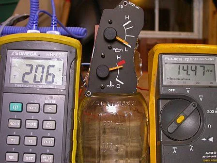

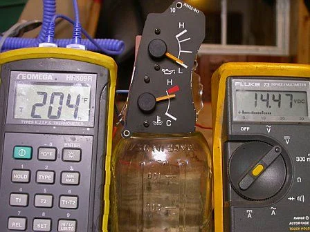

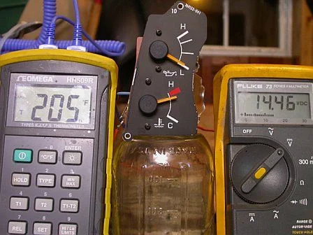

this may help your peace of mind. these are RT's test photos of my modded 93 gauge. The gauge looks hotter than it is!
Thanks. So based on this into the red is when it is dangerously heating up? My truck is running fine, no physical indication of overheating, fwiw.
I appreciate you taking the time to post this.
first off, I think the 93-94 gauges may read higher than the 95-97 which is a different p/n. There is no visible difference to explain it.
second, i think the 93-94s may run slightly hotter. don't know why. everything on my truck seems fine but i see way more temp fluctuation than later model trucks. the bigger heavier tranny running slightly hotter is one possibility. turning the od off as suggested will increase rpm and hence make the fan run faster but i also wonder if the older tranny is lugging, even with 33s. Don't know.
touching the red would make me nervous even though it is only 213. I have not done that yet even towing a 4500 lb boat over a mountain pass. But, I can get darn close and I wouldn't dream of climbing a long steady gentle hill with the AC and the OD on.

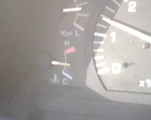

My Blackberry took an update that made it necessary to update the desktop software te be able to get access to the media card so it took me a while to figure that out and get the pictures into my computer. This first one is the hottest it got this morning and the second while I was sitting in the car wash.
Looks perfectly fine to me.
Why is your truck idling so high sitting in the carwash?
I think I was moving forward from the clean to the blower at that point. It idles at 800 or so when the ac is on, 650 or so without.
